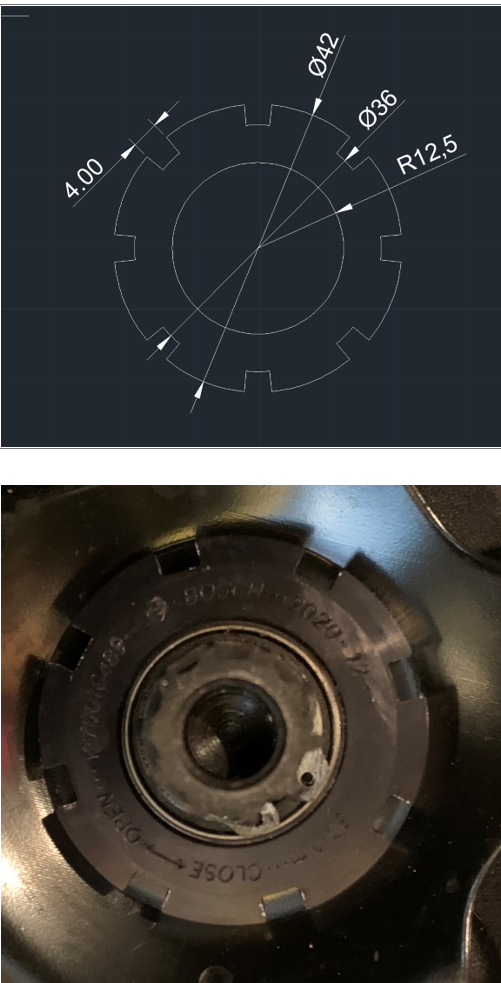

I am trying to change the front sprocket from a standard 38 to 40, ordered from Tredz there recommendations, sprocket and chain ring removal tool, however the removal tool is too large, mine is around 42 dia, I'm struggling to find anything , they all see to quote Performance line which is what my Bosch motor is, mine is the 2021 GEN3 looking for help, I'm slowly throwing money at it and getting pissed off wish i hadn't bothered,
these are the items Tredz suggested, i can try the sprocket at the tool doesn't fit, trying to establish if i need to send both parts back ?
FSA Bosch E-Bike Direct Mount Chainring & Guard | Tredz Bikes
Ice Toolz Bosch Lockring Tool | Tredz Bikes
Image of mine and rough sizes

how much is the Park tool one? Thats the same part but likely a lot more expensive
if you read the reviews for the XLC one I linked to from Tredz it says it'll fit Bosch gen 4 lockrings. plus I bought that same part and can confirm it fits the Bosch gen 4 locking
when I was searching for one a while back I found that any tool marketed as "Bosch e bike compatible" was about twice the price and more often than not sold out. but the other tools just listed as BB tool (which is what they are) are much cheaper and available!

i have now changed the sprocket from 38t to 40t i have a speedbox 3 so get assist always as in no 15 mph limit, a quick blast down the road suggets i can run in top gear 9th at close to 28/30 mph. on the 38t was more like 24/25 mph , will no more tomorrow on my normal commute

mines GEN3
