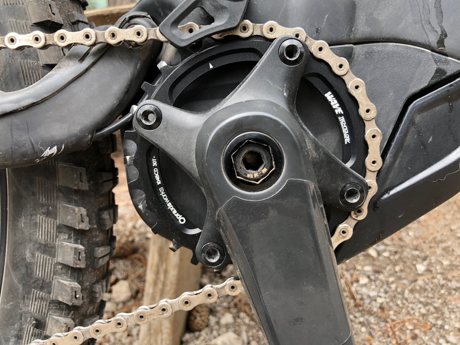

yes, 104bcd is right, but be aware that most chainrings bigger than 32t don‘thave threads so you will need screws like these... with their ‚counterpart‘. the Short ones.
WOLFTOOTH Kettenblattschrauben 6 mm 4-Loch, 18,50
i would recommend cutting a 6mm hex bit in ca 5mm lenght so you can insert it from the back of the spider and hold it with a 6mm open end key to tighten or loose.
So you can change without removing the spider and the risk of slipping out of the nuts.
there are other threaded nuts with some Special key to get behind the spider, I would not recommend using these, if the spider spins accidentally while loosening or the key slips out you can easily crack the motor cover...
you can also glue the threads in the chainring which should normally work out but if I did use an amount of glue that I think I could get it apart later so I can reuse the threads at least one got loose so I needed the shortened bit anyway.

For those who want to pedal more easily on steep gradients and want to reduce the engine load, the 30 T chainring fits on the Spider and everything works perfectly!
(See answer #13)
No need to take off the spider, not even the crank!
