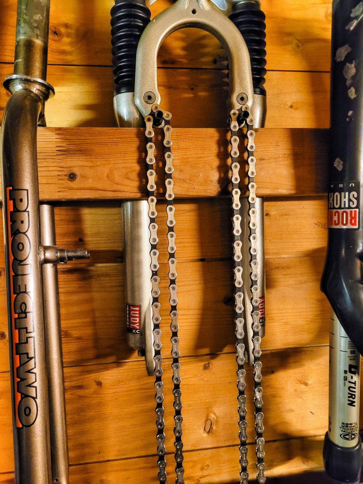

I start with a new drivetrain + 2 spare chains.
Every 250 miles chain comes off and goes in a bucket of degreaser overnight, fresh chain goes on. I do it every 250 miles so there's not too much of a gap between swaps.
Very quick to swap the chains, I also degrease the cassette and chainring when the chain is off. Seems to work for me.
You just need to find somewhere to hang the chains...
