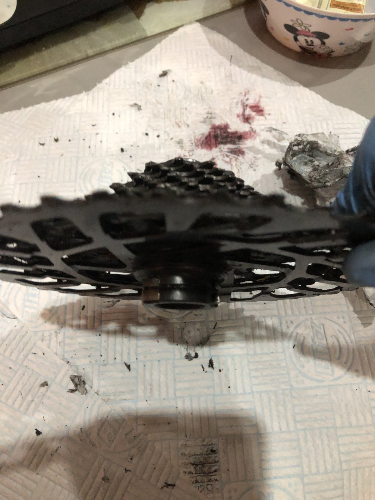

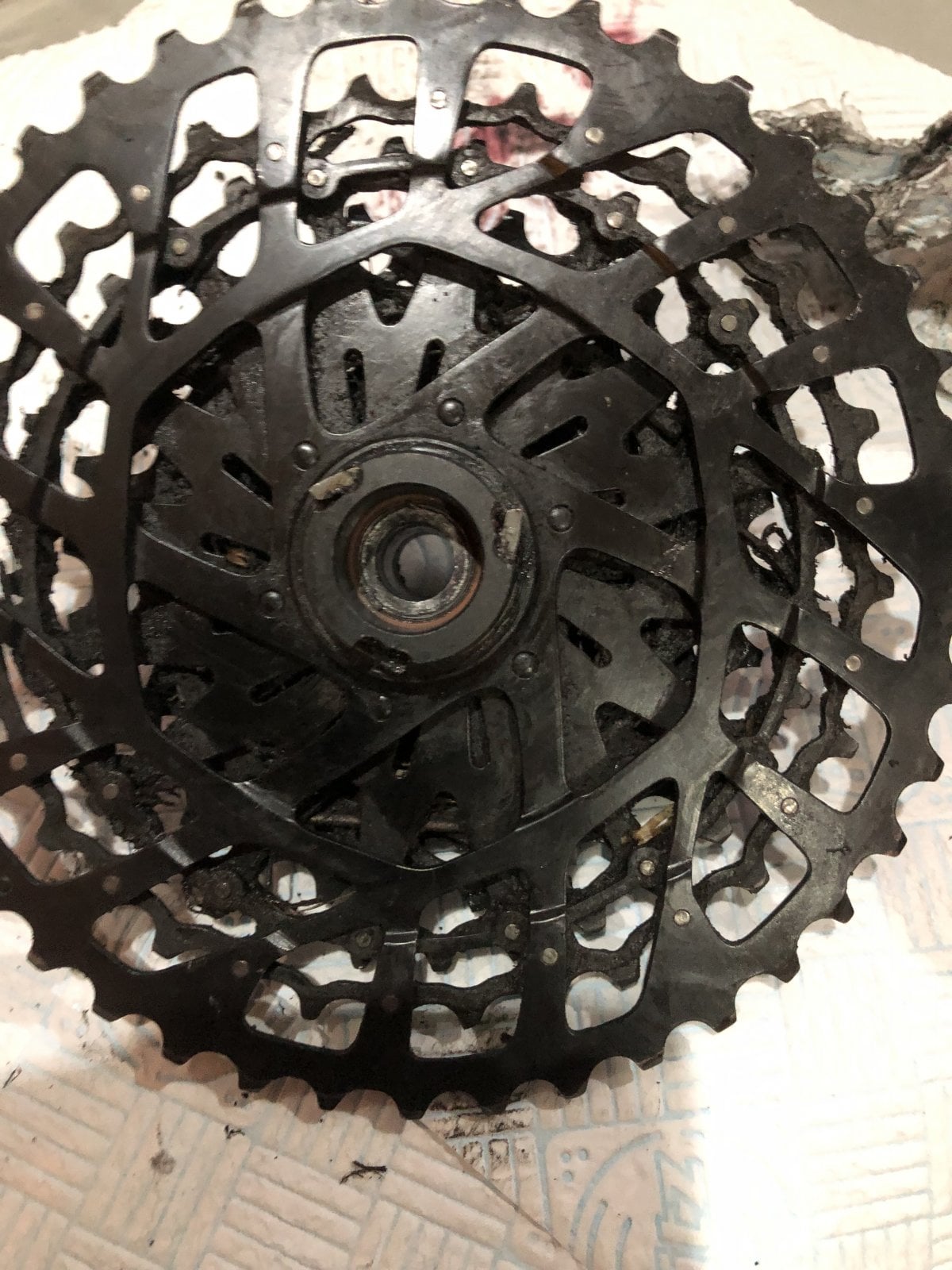

Hi guys, Whilst taking my back wheel off my 2018 levo to inspect a creaking noise (that I was getting under load), my cassette and freehub fell off completely. One of the pawls has come off too. Is this a job I could attempt myself (with the right tools) or do I need to get an expert repair? Thanks in advance

There is nothing to hold it on. I also noticed this (and it was a bit of a pain) whilst changing out a rear tyre.
If you can find the pawl, just wind the cassette and freehub back in whilst turning it in a direction that makes the pawls lie flat (you may have to hold the pawls down with your fingers until the are inside the freehub outer).

Thanks for the reply. I’ll try and find the little blighter and give that a go.

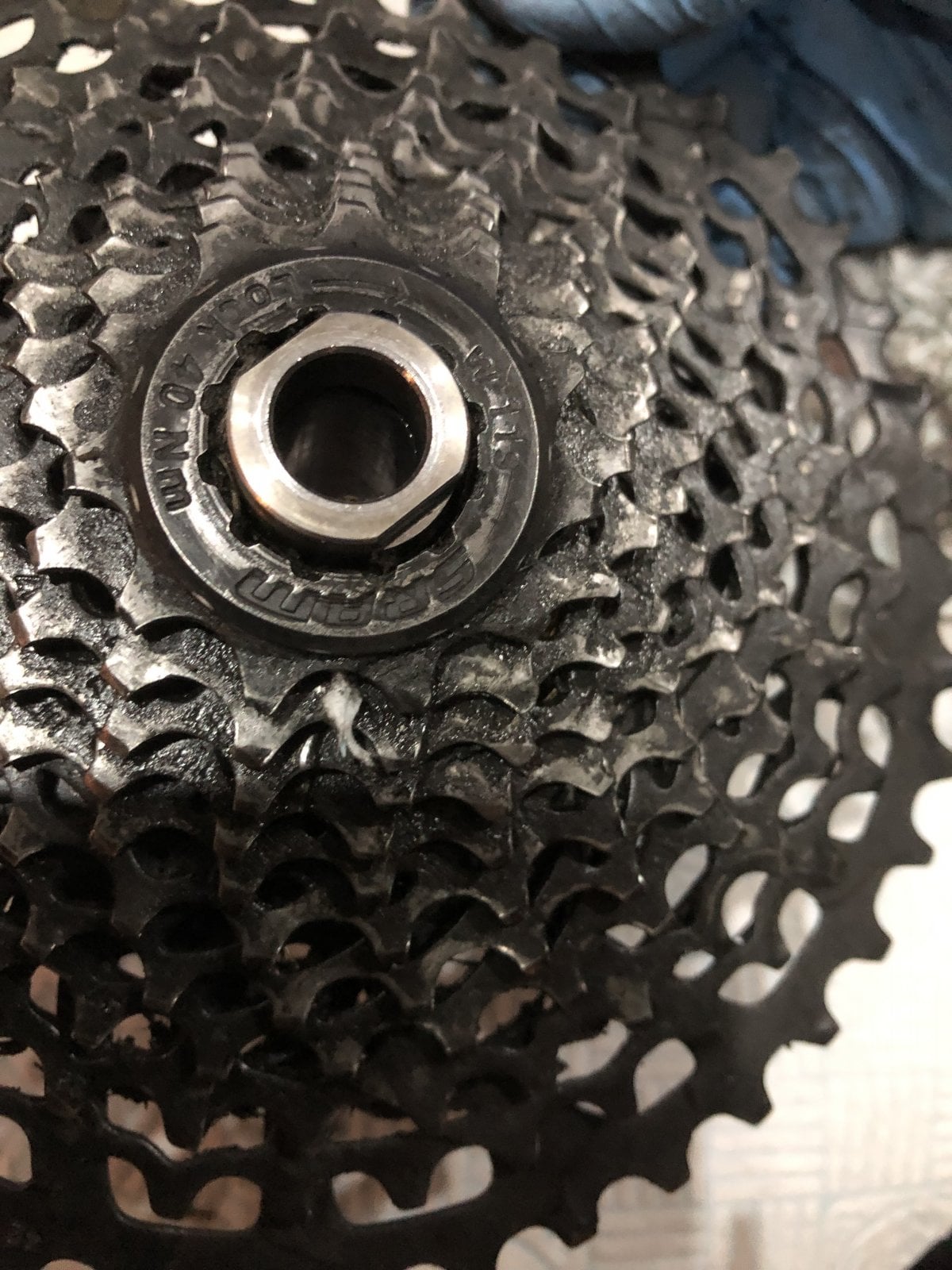

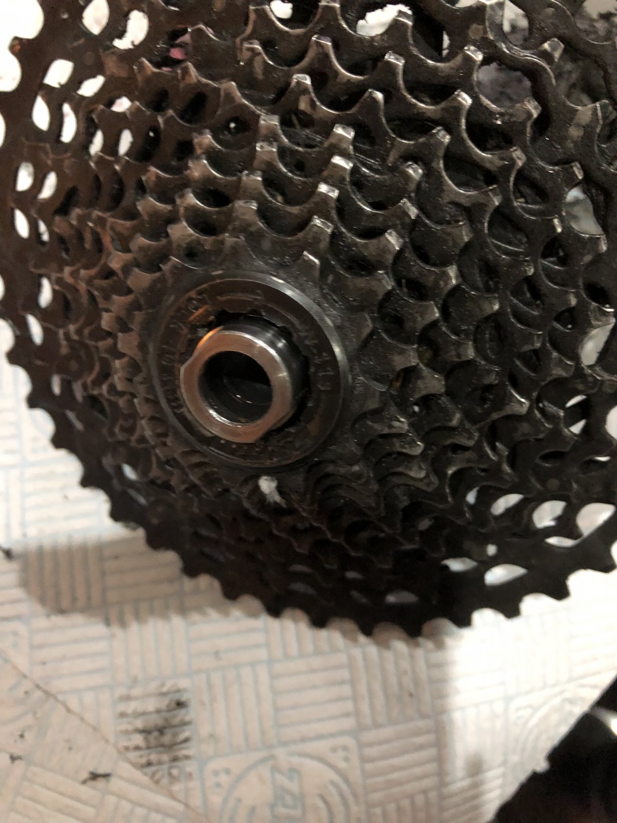

It needs taking apart slowly and tracing what’s iether broken or come undone . I would say the piece you can see in the middle of the cassette should thread onto the end of the axle to keep the freehub in place .simits iether come undone or the axle has broken
Bearing failure in some freehubs can cause this to happen , hope and Whyte as mentioned above are 2 freehubs hubs I’ve seen it happen to

I am not familiar with that particular hub but a few years back purchased a spare wheelset for one of my bikes and when changing wheels one day had the cassette slide off. Took me a long time to figure out that there was a wire ring missing. Did not really do anything but stop the freewheel body from sliding off. When installed on the bike it wasn't an issue but I did make a ring to replace the missing one.
With many brands the freewheel body is held on by a locking nut. If you google "specialized rear hub exploded view" you should get a better idea.
