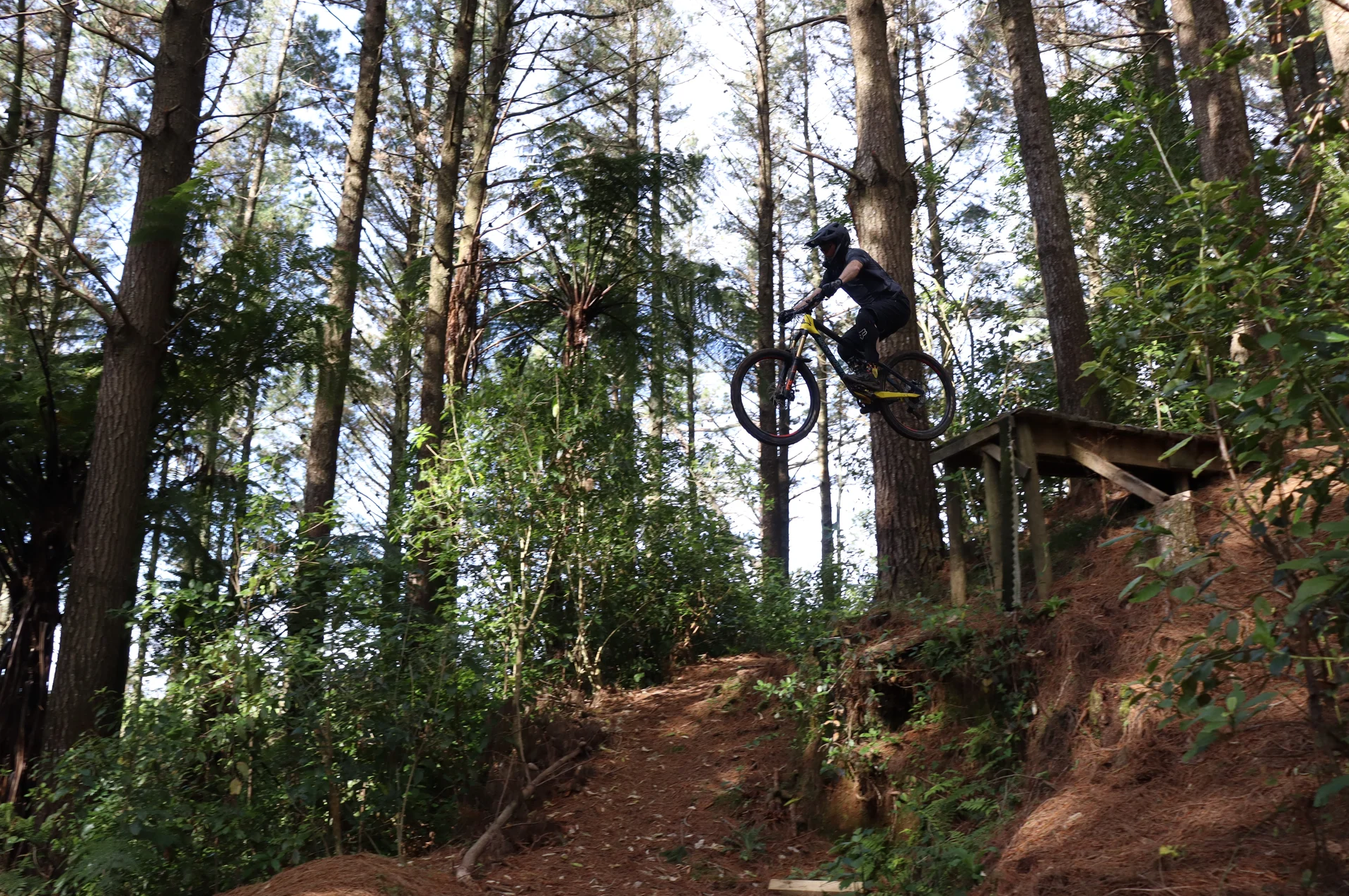

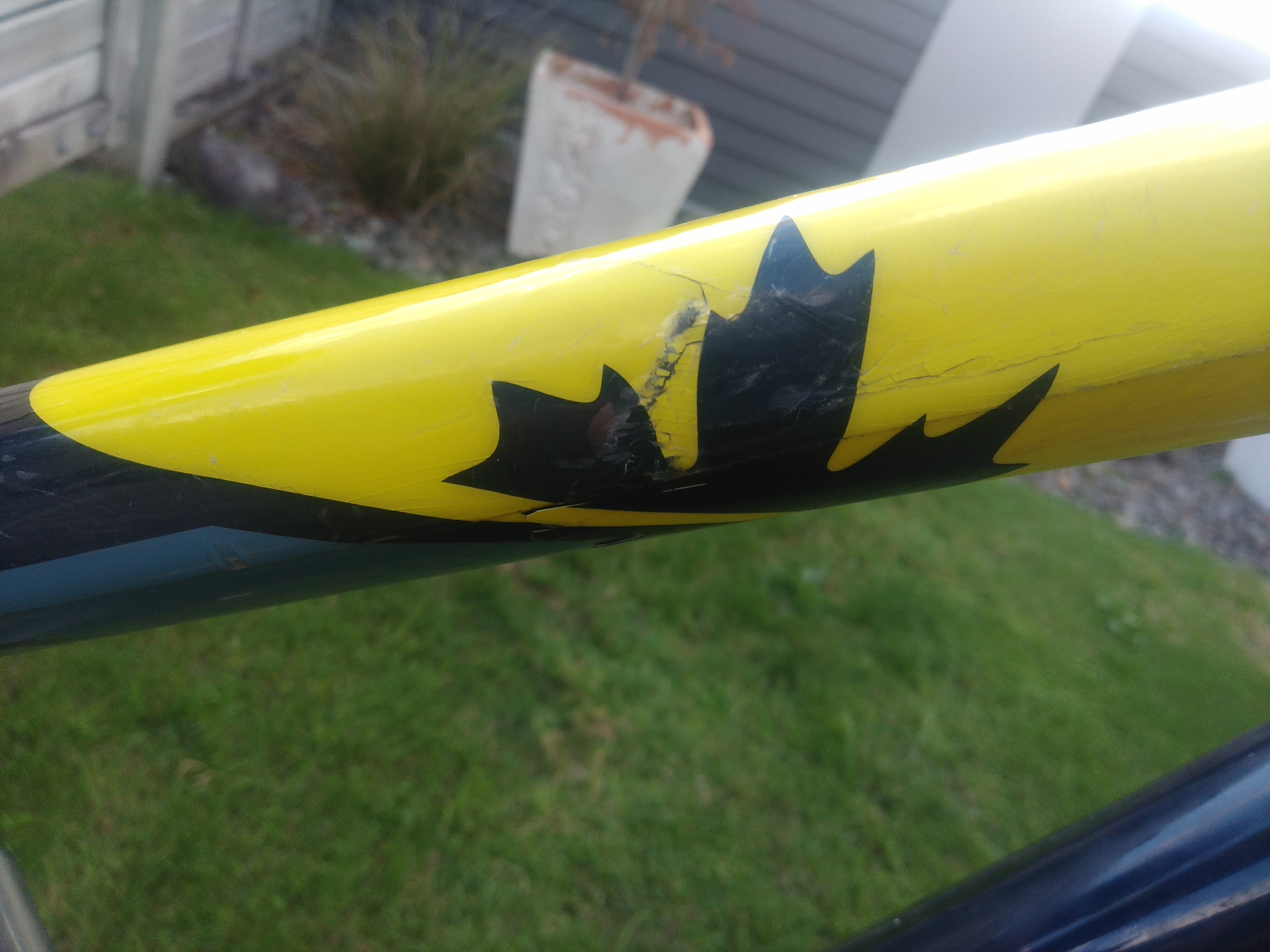

If you nose into something ie a stupid nose heavy landing from a jump or a drop the fork tries to get pushed under they down tube. One result of this is that the tube tube tries to be ripped apart under extension.
Here's a frame I broke by extension failure 4 years ago.
