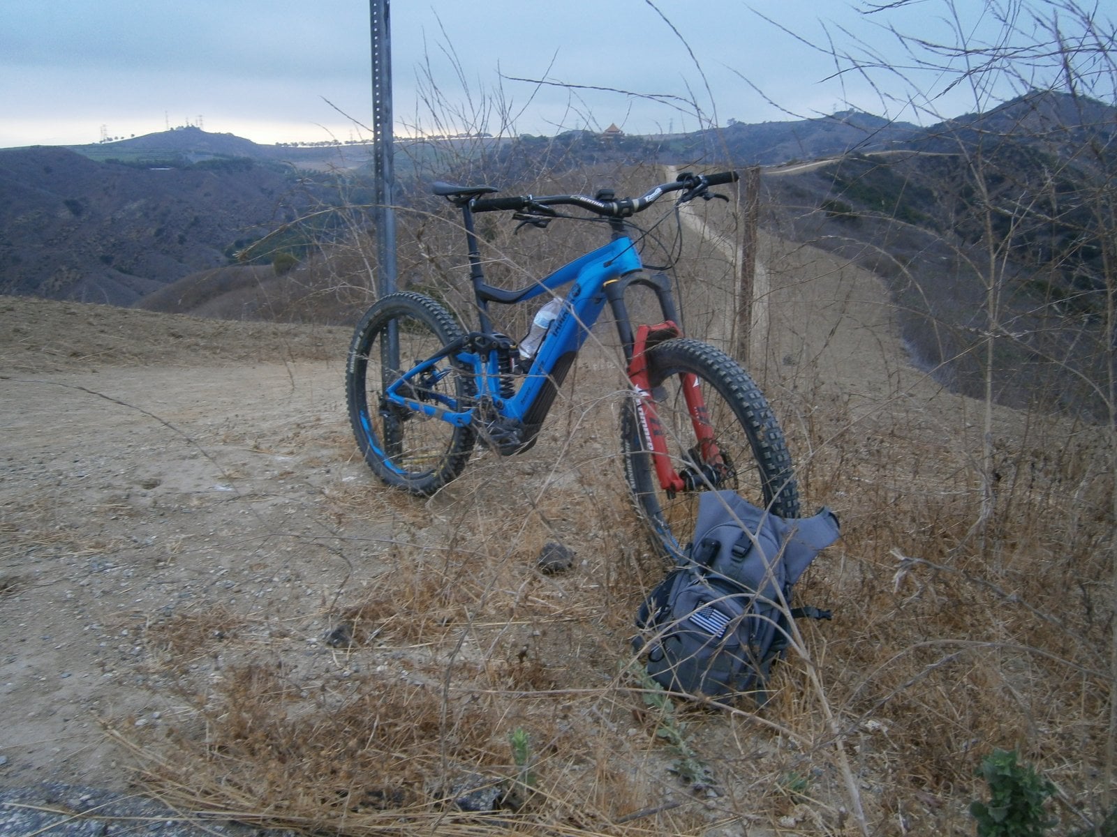

No doubt the 20mm added front end changes the geometry. Its more Enduro set now. Totally love both the rear & front Marzocci coil setup
This pic was taken on Friday out in the hills

Looks beautiful mate, is it the stance or the trance? I'd like mine to be more downhill, my mate said 160mm travel should be fine but I don't know if I'm risking it or not...?

Its a 2019 Trance 2. 160mm is certainly stretching it, but maybe its Ok? I certainly dont know that. Ive only heard the max is 20mm above the designed rake.
Certainly not a downhill spec as the head angle is not really close to a downhill nor this the rear suspension potential anywhere near DH. More Enduro is where you want to be.

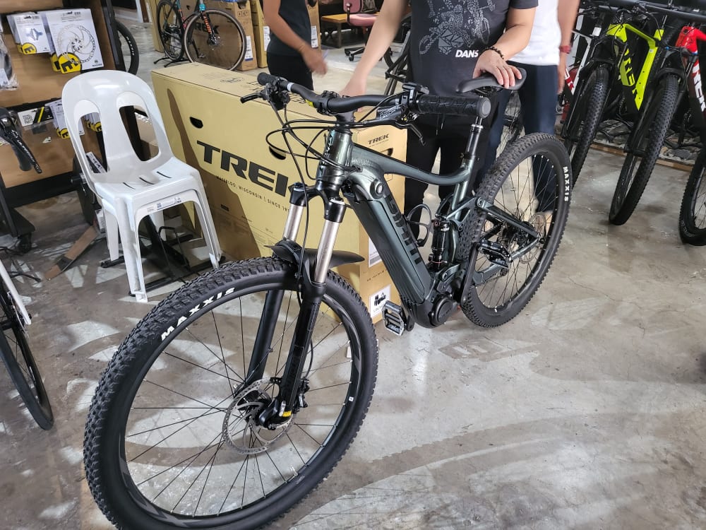

Hello, I just got the stance E+ 2021 model just today, I upgraded the pedals now.
I am coming from a 27.5 with 150mm rock shox pike fork, 2016 Haibike All Mountain, I just sold that earlier this week, I plan to upgrade to a 150mm fork for this one as well, but since this is a 29" tire, is it worth the upgrade? I plan to ride it out on the weekend to see if it has changed the way I ride from my old bike.
So since the thread above is about upgrades, have you then upgrade to 150mm? and is there a noticeable difference? Can I just buy in the marketplace for any 150mm fork, like a Rock Shox Pike? or do I really need it to be EMTB certified?

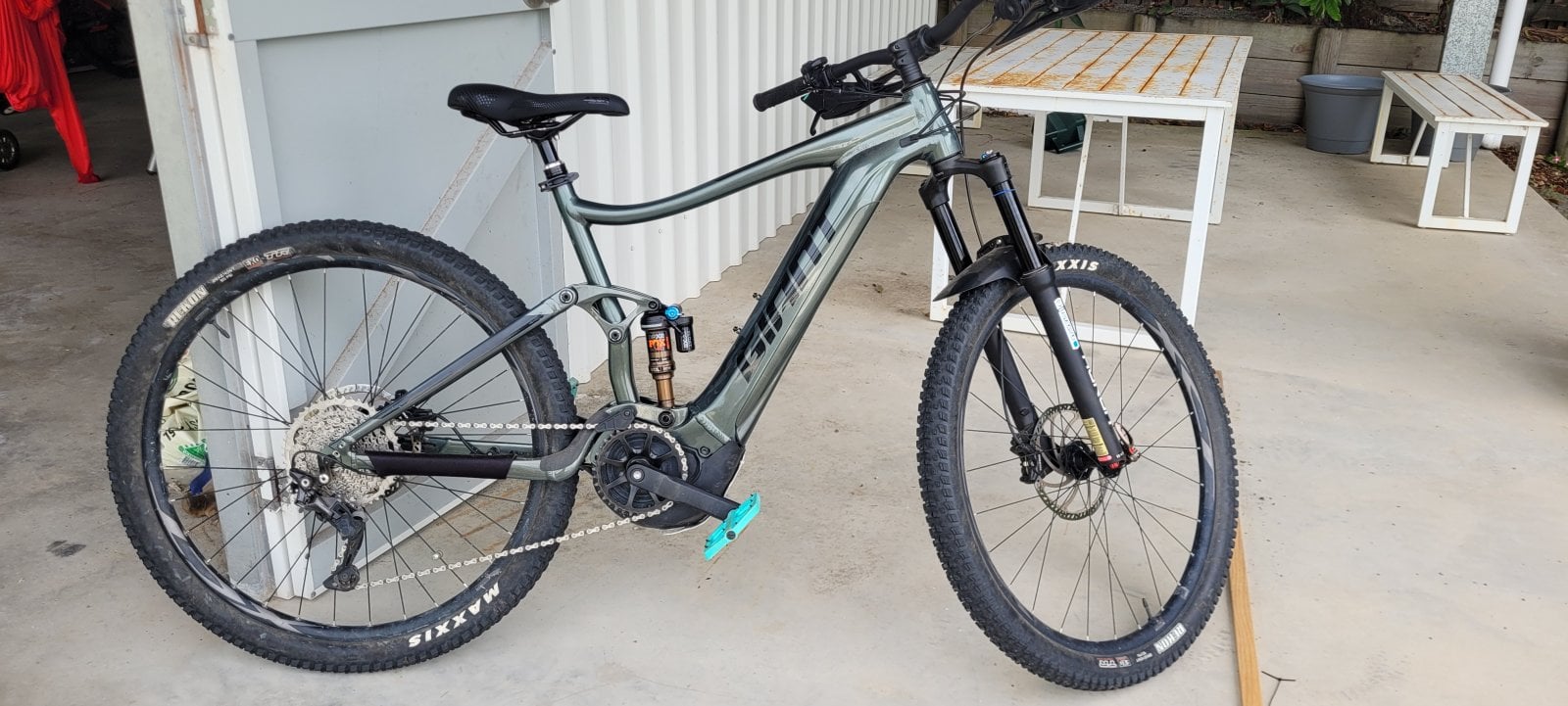

What fork did you end up going with? I have the same stance model, I put a suntour 150mm auron eq boost fork up front and a fox dpx2 on the rear shock.
Have you done anything else to the bike in relation to the tyres or wheels?

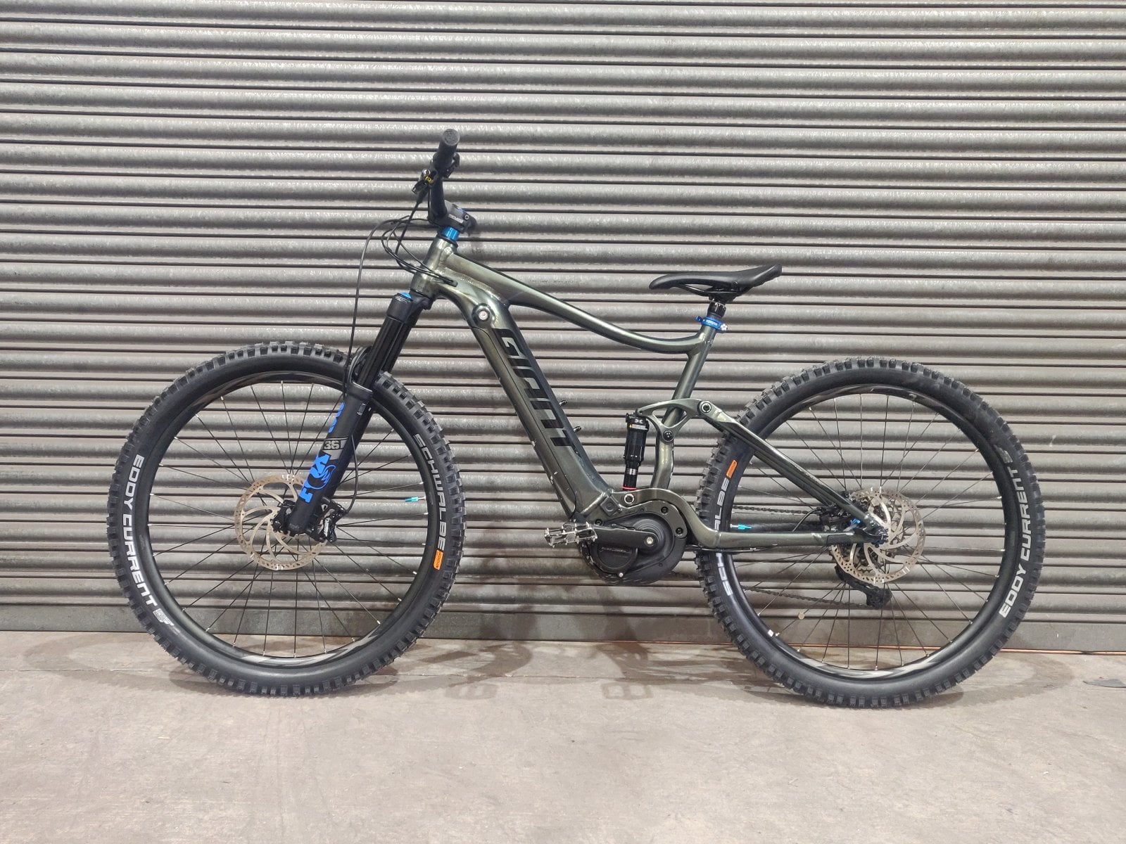

I went 150mm in the end...I put Eddy Current tyres on as well and Hope Pro 4 hubs. I've since given that bike to my mum and ride a Kenevo SL now though
