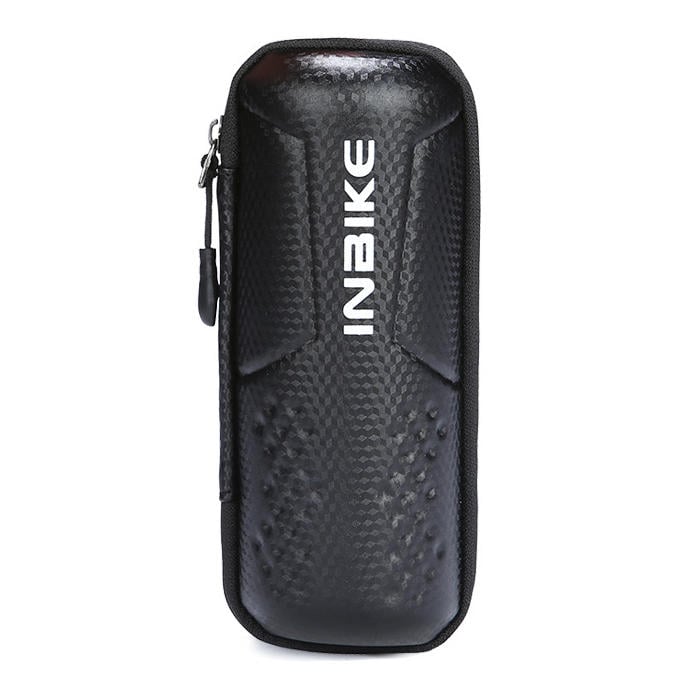

Bought this tool case which goes in the bottle holder. I’ve got everything in there. 3 gas canisters and injector. Bike pump, patch repair kit, tyre levers and loads of other stuff.

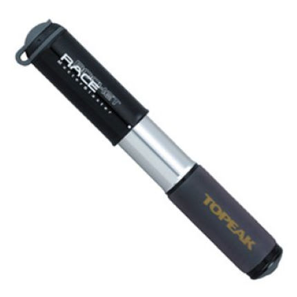

Looks good beekeeper, where did you get it? and what pump fits in it?
Amazon do the cases. 10 left. I think about £12
The pump is a race rocket from Halfords. I use it to partially inflate the tyre then I use a gas canister to pop the rim on properly.
