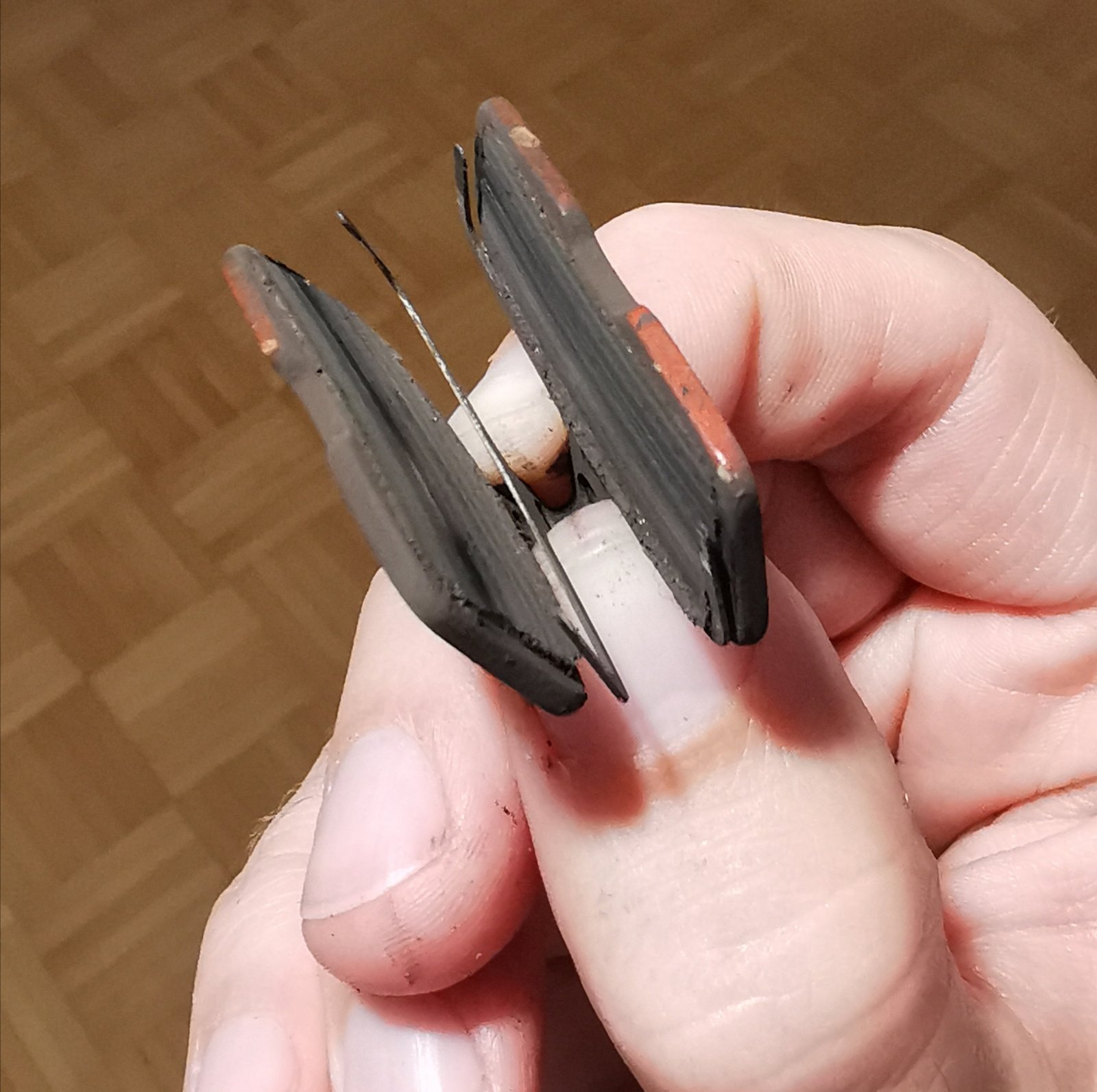

Can anyone tell me based on the photos if I need to change my brake pads?
Sophie777
Jul 3, 2018
215
107
Canada

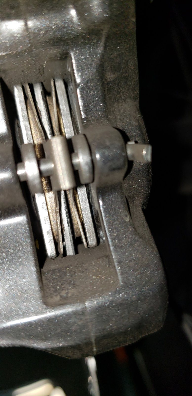

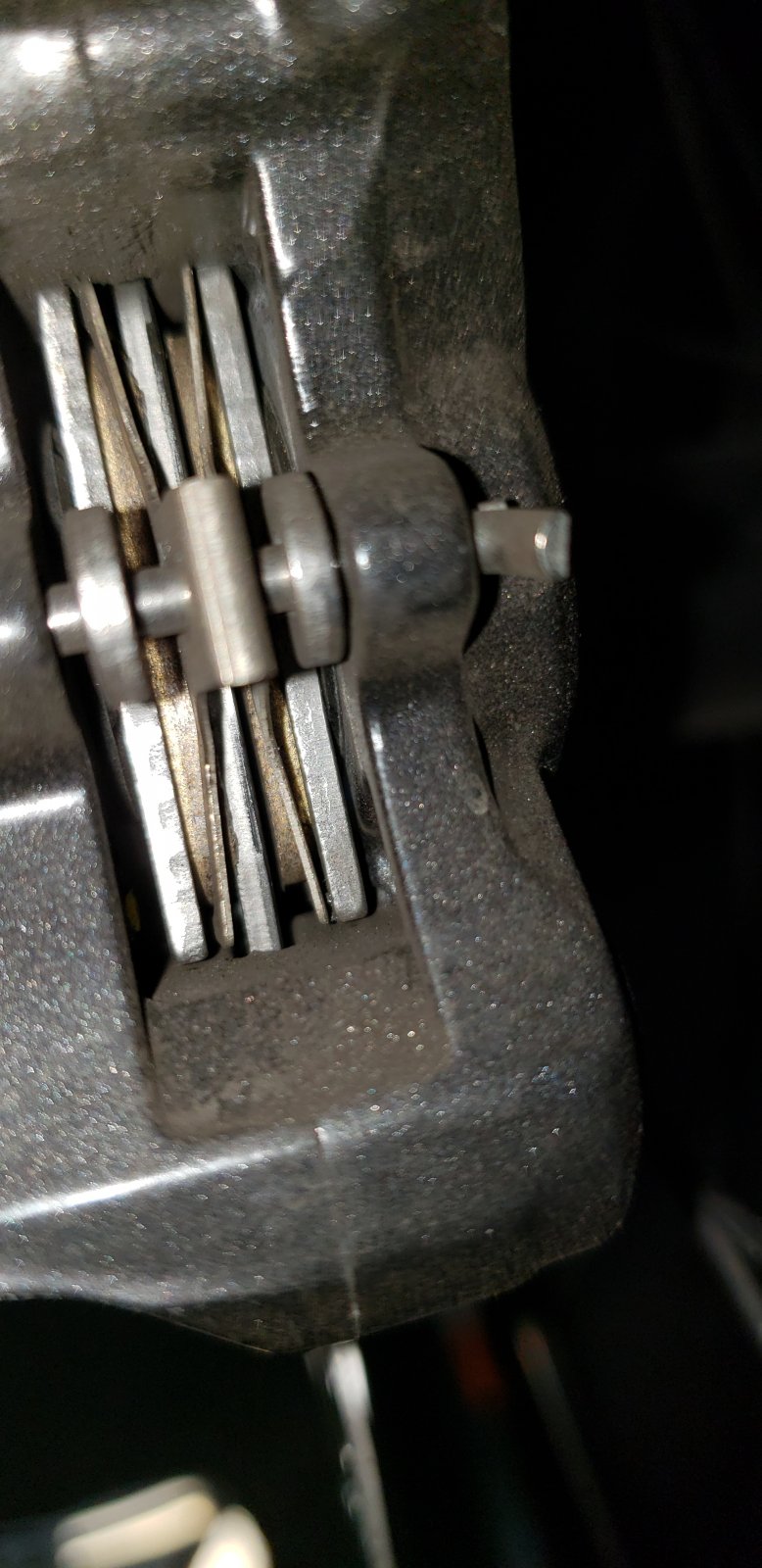

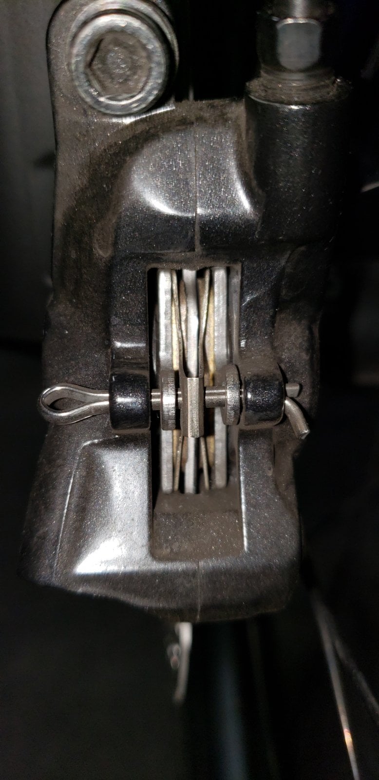

I have a Trek Powerfly FS 7 2019, with 1300 km on it.
Since day 1, I get a high pitched squeal when using my front brake.
Brake power seems normal; I can easily brake using 1 finger.
I accepted the squeal up until now - I thought if the performance of the brake is normal, I'll just live with it.
I thought the squeal would just supplement my bell :)
I did try repetitive heavy braking on descending - this fix is only temporsry (squeal recurs within 10 km of riding).
I also cleaned my rotors with rubbing alcohol - again, squeal recurs within 10 km of riding.
Now I'm reading the squeal can be related to wearing of the brake pads.
Can anyone tell based on the photos below whether I should replace my brake pads?
Also, does anyone know which brake pads come stock on the Trek Powerfly FS 7 2019? (I think I would like to use the same ones if I have to replace them).
Thanks!!

The pads have loads of life left, you may want to switch to organic pads to fix your squeal though and keep the old pads for spares (y)

The pads are far from worn out.
Show a picture of the rotors, front and rear. I'd like to see the amount of deposit and coloration on the brake track, as I suspect glazing and/or improper bedding-in process.
Replacing the pads and rotor is a quick and inexpensive way to fix squealing, but if the user goes a little too hard with bedding in, it will just happen again.

Pads seems to be fine.
I would:
- remove pads + calipers.
- sandpaper the pads, so all contamination is gone.
- sandpaper the discs, so all contamination is done.
- clean the calipers with a toothbrush and some cleaner.
- make sure the pistons moves freely....all of them.
- mount the calipers and make sure they are aligned good.
- bed-in the cleaned pads/discs.

From photos they seems hardly used. Next time when in doubt pult the pads out and measure them (with vernier caliper), if thickness is under 3mm then it is time to replace them.

Not even close to needing replacement. Here's my usual solution to squealing:
1) remove and soak pads and rotors in isopropyl alcohol (a dinner plate works well) for 10-15 minutes
2) using multiple CLEAN pieces of paper tower, clean the rotor, both sides (two pieces of towel), then set on another clean piece to dry
3) DO NOT RE-USE THE PAPER TOWEL, EVER. WASH YOUR HANDS FREQUENTLY TO REMOVE OIL/FLUID FROM THEM.
4) clean all surfaces of the pads (including the metal backing plate) with clean paper towel(s)
5) lightly sand the surface of the pads with 220 or 320 grit sandpaper
6) place the pads back into an alcohol soak
7) wet a piece of towel or clean rag with alcohol and clean out the inside of the caliper(s) thoroughly
8) remove the pads and again clean them with CLEAN towels, then let them dry
9) one more light sanding with 220/320 grit sandpaper
10) reinstall and go ride

Looks like the spring that pushes the pads back is rubbing on the rotor. The pads themselves look good. Maybe just try replacing the spring which appears to be bent.
That was my thought too. The spring seems to have a curve to it......close if not touching the rotor where the retention bolt goes through.
That's what made me think the calliper wasn't centred, probably just needs nudging over?

Hang on, 1300kms, and your pads still look like that! Don't you have any hills?
Well, before I started this thread, I would have said I have lots of hills; but based on the comments, I suppose 188 meters elevation (according to the Relive app) is just a small bump for you guys :)
Now I can see that I do indeed have lots of pad material left; before I didn't know how to interpret/look at the photos I posted.
But I think I have finally fixed the squealing.
I saw some oily substance on the hydraulic housing just above the caliper. I cleaned everything up (housing, caliper, rotor) with isopropyl alcohol (didn't have to remove the pads), and since no more squealing!
Hope I don't have a leak, but all remains dry with a further 44km on the bike.
Because I had the squealing from day 1 - maybe the bike shop accidentally got some oil in the caliper and the housing when setting up the bike?

Good result and well done. I'd still replace the spring as it looks bent; it should look symmetrical. If you don't have a spare, ask at your bike shop as they will probably have a spare they could give you.

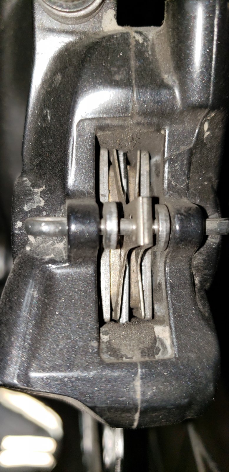

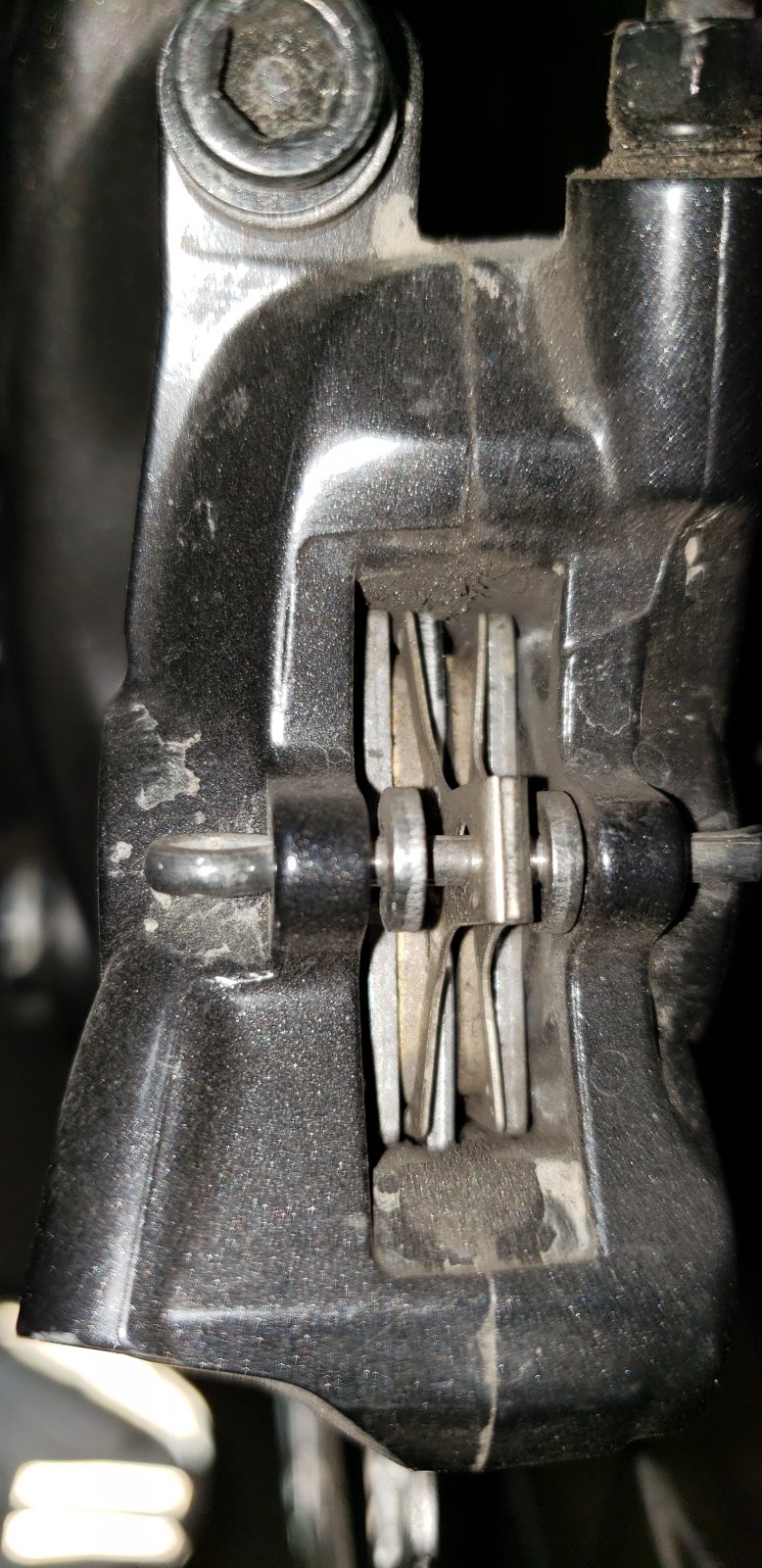

Hi! Could you tell me which side of the spring in the above photos (1st post, looking at the screen) do you think is bent?
And is it bent in the middle (at the hinge), top half, bottom half?
Below are photos of my rear brake pads. To my eye, the spring looks the same as the spring in my front pads. Do you still think the spring in my front pads is bent?
Thanks for your help! (and everyone else as well).

Left hand side. On second viewing it looks more off centre rather than bent but to the extent that it appears to be rubbing on the disc rotor. Try loosening both caliper bolts to the point where the caliper can move freely, pull on the brake lever hard and nip the disc caliper bolts up tight while still holding on to the brake lever. This will help centre the caliper with the disc.

The springs may be bent, but if you've never taken the pads out before, I don't see how they would get bent, unless very careless assembly by your bike shop. To me it just looks like the springs are just not centred properly, in both pics they are canted far over to the right, hard up against the right hand pad but not even touching the left. Also not centered on the split pin, so on the left the spring does look like it could be rubbing on the rotor. I would just give the spring a wiggle and see if you can centre it. If it is bent it will be obvious, in that case replacement is best as others have said, but you can bend them back into shape by hand as well if they're not too bad out of shape
