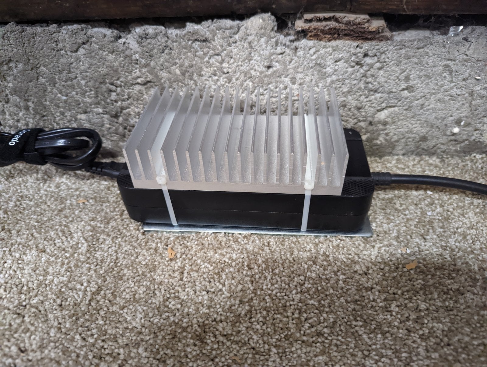

Alexbn921
Sep 27, 2021
545
511
East Bay CA
100 cycles and 90% seems like you are not managing your batteries. Was it hot when you charged them or where they fresh off a hard ride with zero charge?
My charger would get over 155f while charging so I added a heatsink and not it stays around 120f.

Alexbn921
Sep 27, 2021
545
511
East Bay CA
Sucks man.
I have a magnet mounted on the wall by my charger and hang it from that so it's not on the floor. I also have a heat sink on the charger to keep the temperature down.
What are you going to do with the old batteries? I would like to play with them just so I can share what's inside and maybe repair them.
I'm over in walnut creek.
