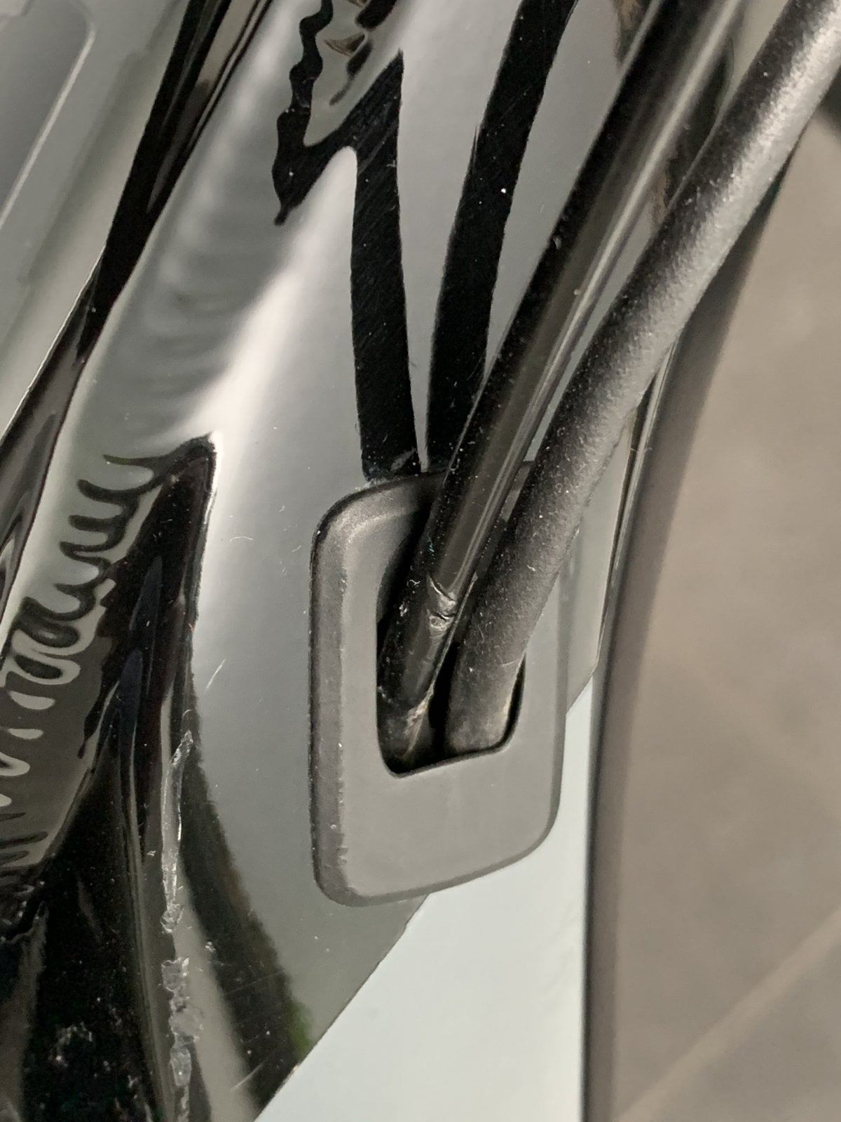

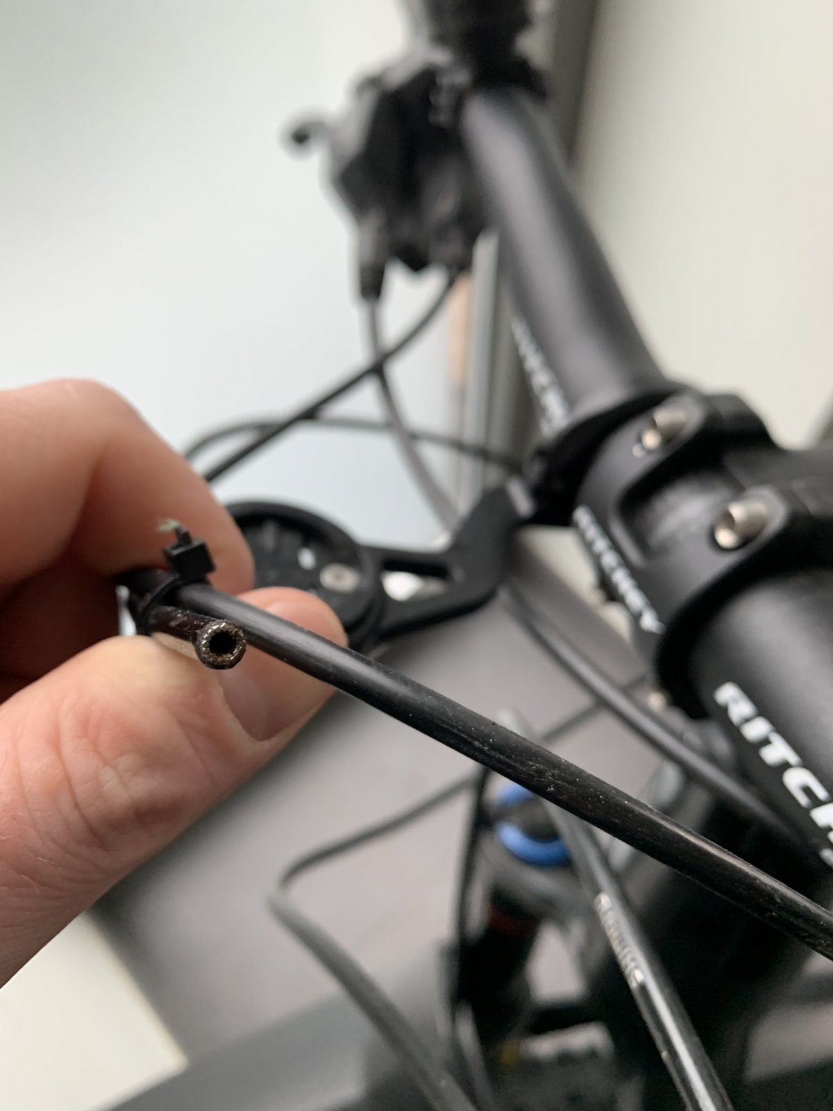

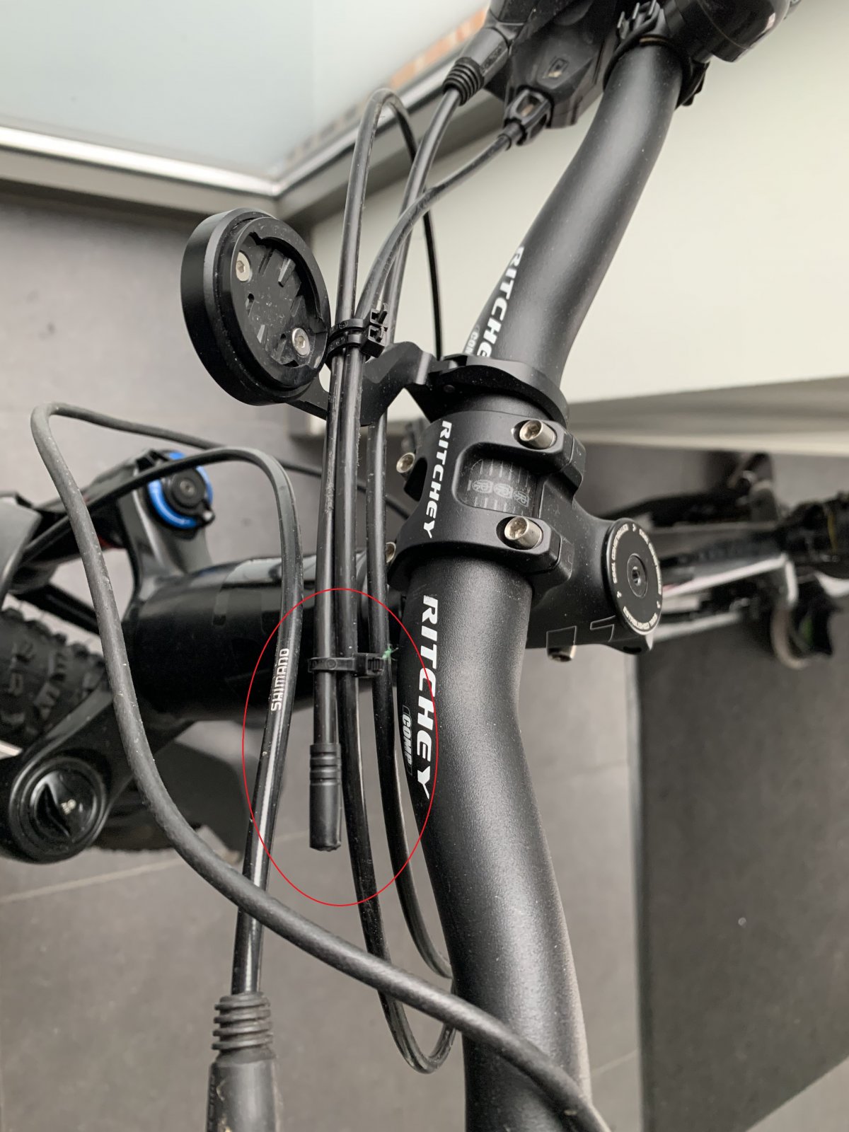

I have the exact same bike and have noticed an unused cable that has been there from when i bought it. It might be pre installed for dropper posts installation. It goes into the frame on the right hand side together with cable connecting the motor with the display unit.
View attachment 49717 View attachment 49718 View attachment 49719
I looked at that first and didn't find an extra cable.I will have another look.
