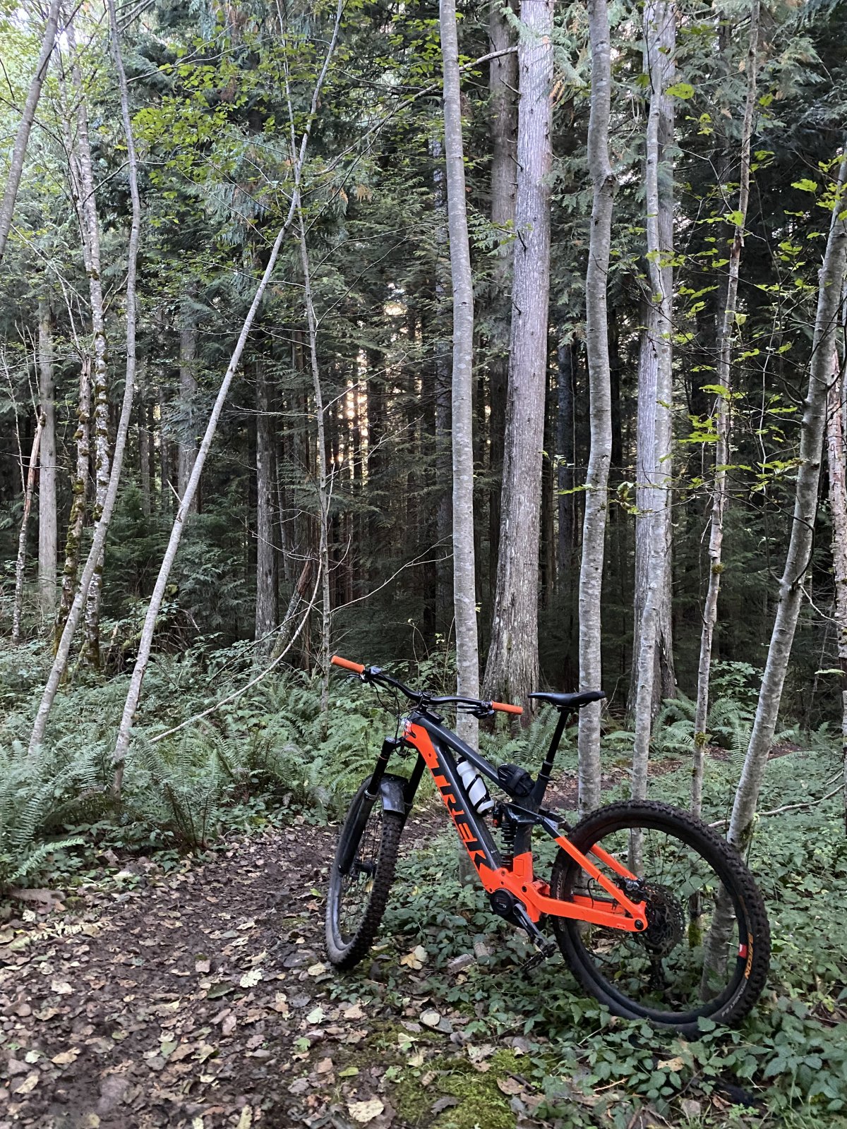

Going to try this in my 2021 9.8 large with a 180 front fork and 165 rear shock in high setting. I typically ride steep PNW rough trails.

I like it, much more agile on steep sharp corners. Had one pedal strike but I can deal with it. Will keep riding it like this for a bit.

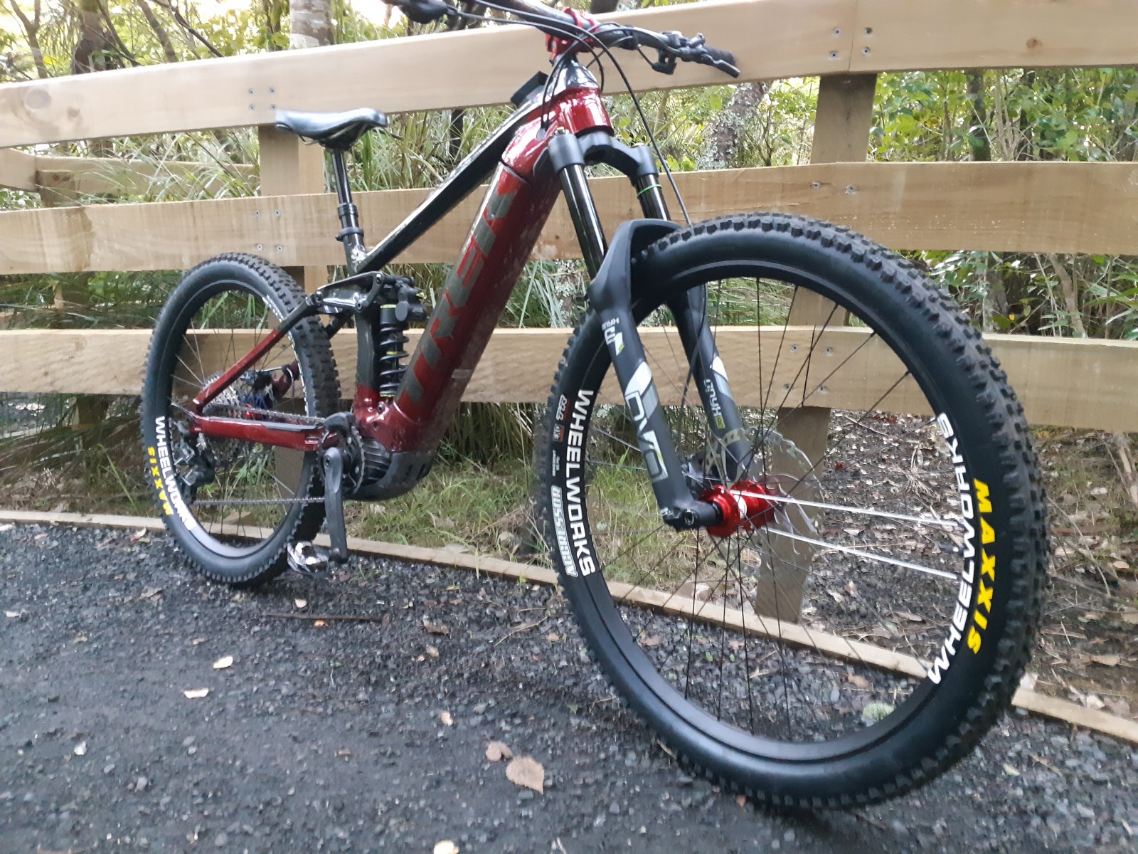

I mulleted (is that a word?) my Rail 7 not long after buying it. I'm quite short-ish and only 63kg, riding a Medium frame. Have found it made the bike much more fun to ride. With 29er setup I felt I was sitting on top of the bike. With 27.5" rear it now feels more like I'm sitting "in" the cockpit. Also, upgrading rims and hubs to custom build was a bonus. I switched the flipchip suspension doodad to high position which slightly offsets smaller wheel. Bike is definately more flickable around tight corners and generally a more playful ride. Pedal strike is slightly more, but that can be a matter of choosing pedal position in rough terrain. I think for shorter peeps, a mullet setup is def worth trying.
