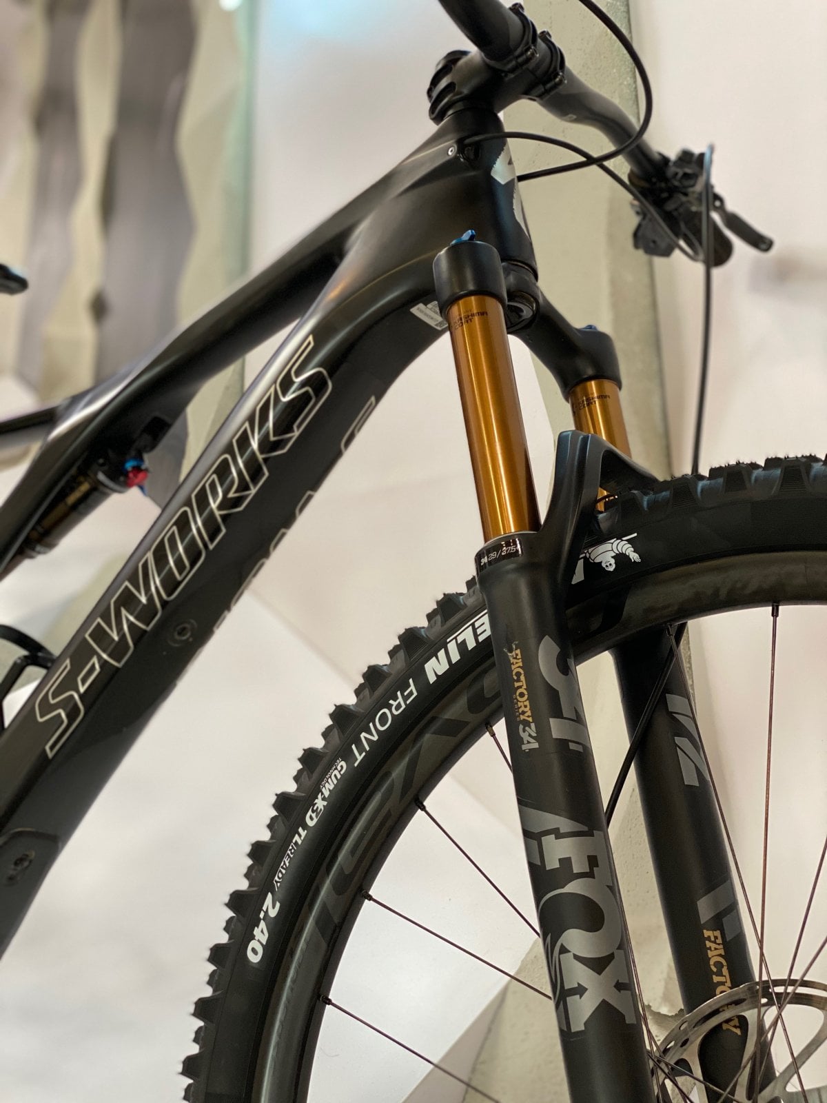

Enduro Wild 2.4 is quite big tire
Got the new kicks and can't wait to try them! The compound is super soft and grippy!

curious to hear your review. I've only ridden Butchers and Maxxis. Why did you pick these?
I've had the Assegai and Aggressor on my last bike and they were great. I'm a fan of Michelin car performance tires and wanted to give them a shot. The reviews have also been stellar. The last reason is one can't have yellow Maxxis logos clashing with gold kashima ;)
Ok... Had a ride and love them! Super grippy and didn't wash out once. They inspired confidence. Now, they aren't as fast rolling as the OEM tires but I'm comparing them after they had 1500 miles and were just about done.
