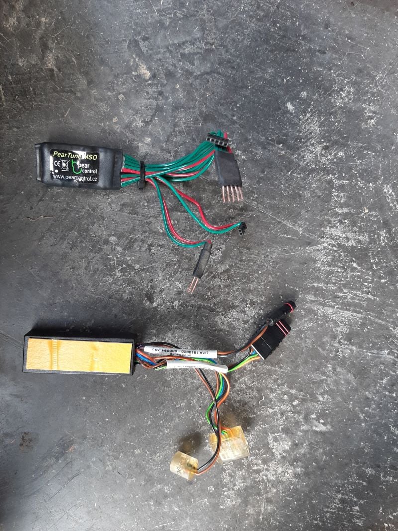

I bought a Peartune from ebike-tuningparts.com ebiketuningparts on Ebay.
It works, but you have to unplug the 2 water-tight connectors (one 2p and one 5p), and plug their cheapo breadboard connectors there.
You loose the water tightning on 4 places, and you loose the "click" that keeps the connectors in place.
To make it worse, they used cheapo stiff cables, so a disconnect while riding or wear-out is preprogrammed.
Paypal dispute is ongoing.

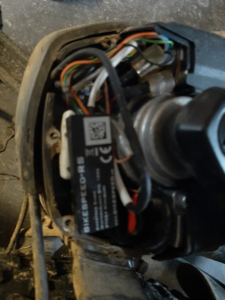

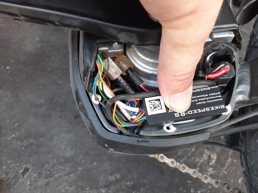

Now I have a Bikespeed-RS from bikespeed.de
This is what you want. A beautiful case, 4 original watertight connectors, flexible cables.
Pic1: Crappy Peartune while removing, with stiff cables and already bent pins.
Pic2: Comparison between crappy PearTune and superb Bikespeed-RS

I also bought the Bikespeed RS unit and it's seriously build with good quality connectors. How did you manage to put it into such small carter. Some original wires are way too long and take a lot of space. There also a quite big ferrite on one wire. Did you take some picture of the install ? Thanks in advance

Hey, I pushed the coil to another location, and the (too) long wires of the bike, indeed you have to rearrange somewhat.
But it fits :)

Thanks again for the tip. I'll try to stick the coil and the Bikespeed RS unit with double side tape into the cover to be sure they don't move while reassembling.

I didn't tape them, but that might be a good idea.
The biggest challenge was to make sure the wires don't get stuk between both sides of the cover, when bolting together.

Your image saved my life :). I broke a little piece of plastic inside the 2 wires round connector and wondered which way to connect. I wanted to connect following color code (black /black) but the image shows black to brown and red to black which could seem strange. I managed to put all wires correctly inside the cover. Could you tell me the procedure to activate and deactivate the system because the manual mention "Tour" and "Sport" modes that we don't have. Thank you in advance.
