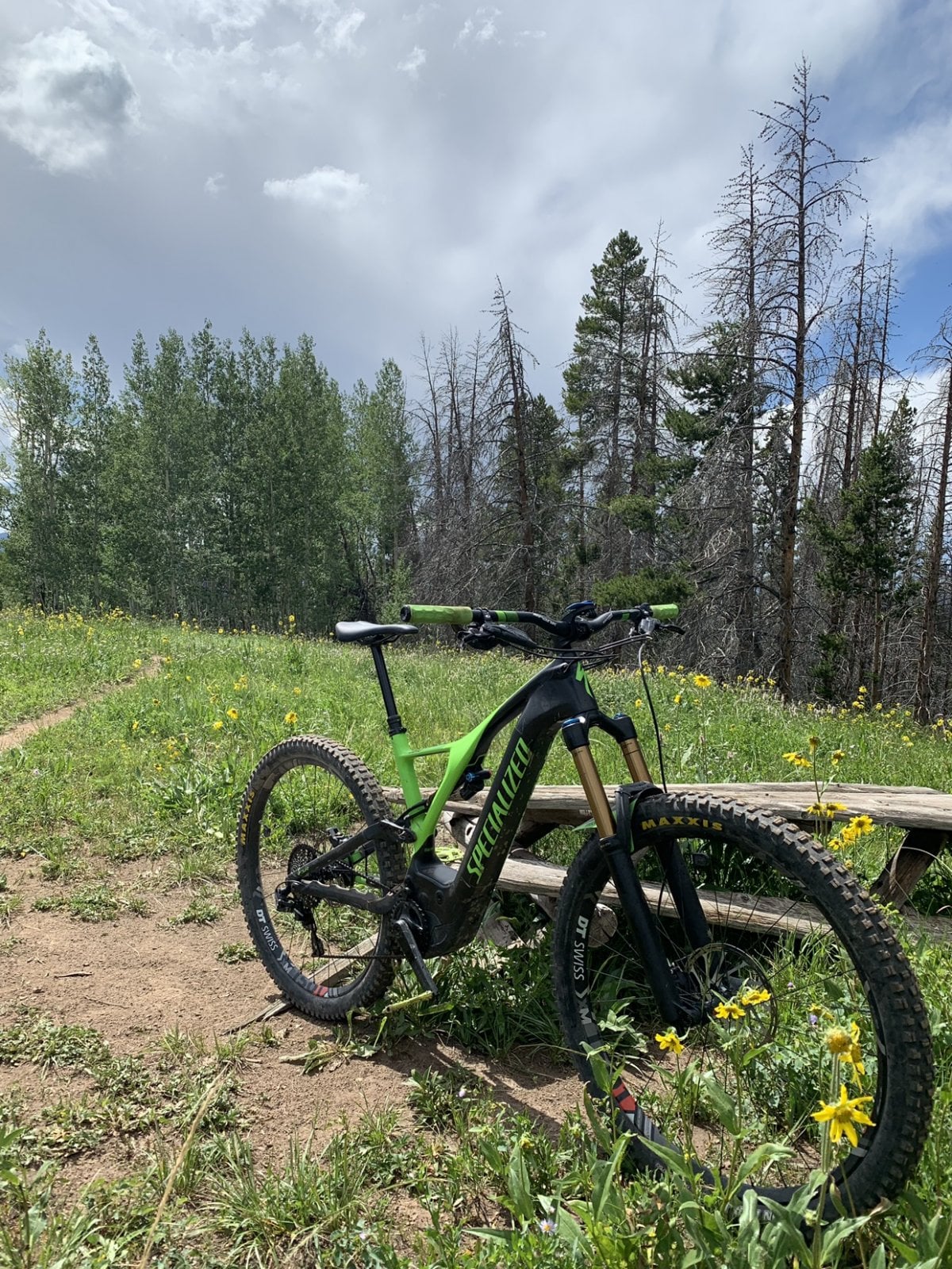

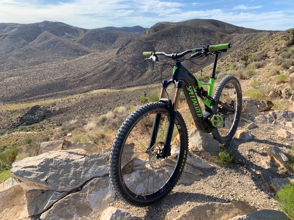

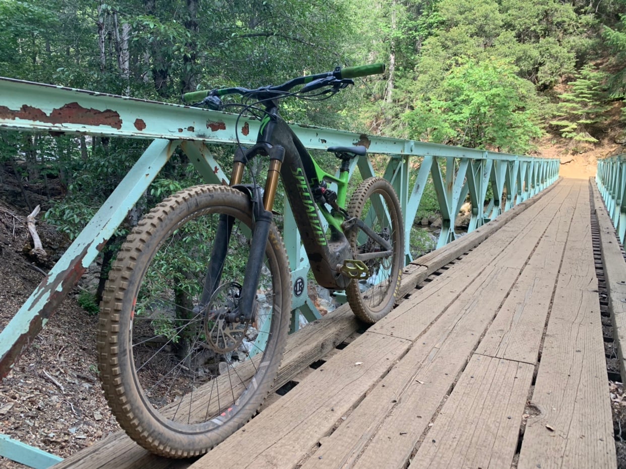

For this bike’s intended and potential use, the stock RS suspension was not capable. The Fox upgrade has made this bike a beast. In the past three weeks I have had mine on three iconic black diamond trails in the Western USA:
Downieville Downhill: 28 miles w 3800’ in California
Relive 'Downieville Down After Packer Saddle Up'
The Hurl Cottonwood/Blue Diamond Las Vegas 30 miles w 3000’ in Nevada
Relive 'Techno & Hurl 30mi for 3k’ with 3 bars'
Two Elks and Game Creek Vail 25 miles w 4200’ in Colorado
Relive 'Game Creek, Two Elks Loop Minturn/Vail 25mis for 4'
I’m also getting 180mm of drop now from a OneUp 2.0 post.
The stock Roval wheels were not up to the challenge, either. Upgraded to DT Swiss XM1501 w 54t Ratchet. Maxxis Minion 2.6” DHRii front (16.5psi) AND rear (18.5psi) with Cushcore. Loads of traction and smashing chunky gnar fast & hard-proof. Downieville and the Nevada desert are ragged and janky riding. This combo holds up w no flats in 400+ miles so far.
TyreWiz makes tire pressure management easy for consistency.

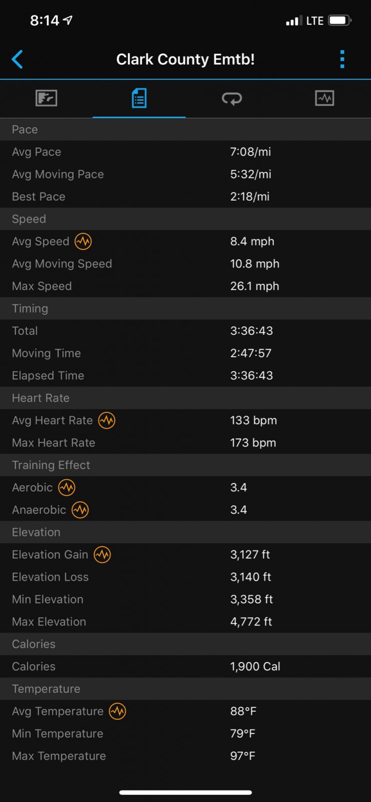

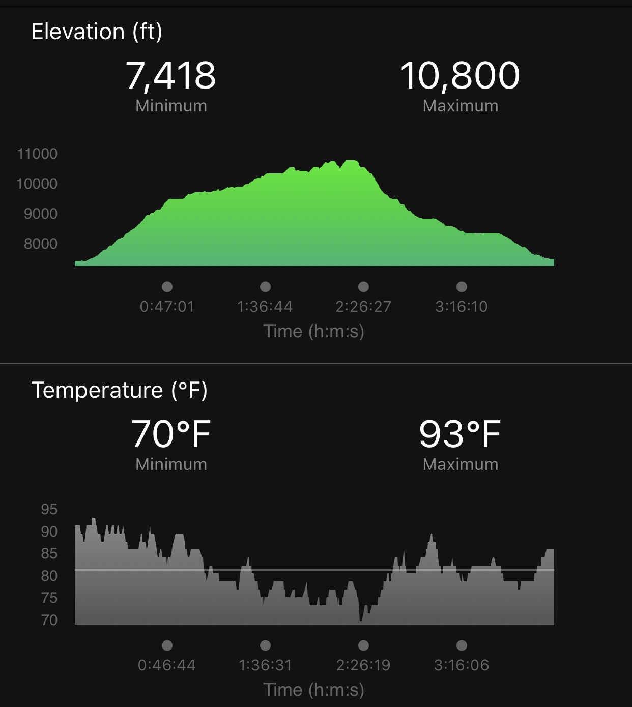

Well bad news...one day after the last big ride I described above, I have a dead motor.
Observations:
1. On the Downieville climb, ambient temps 25-33C (77-91f), ~2500’ of climbing in first 5 miles, motor temp reached 84C per Mission Control. Power delivery became erratic.
2. On the Two Elks climb, ambient temps 21-34C (70-93f), over 2000’ of climbing in first 5 miles, motor temp reached 82C per Mission Control. Power delivery became erratic.
During both rides, at no time did Mission Control nor the bike give a warning. Mission control noted no system health issues.
Within 4.5 miles of riding after the last ride, the motor failed with free spooling/slippage under power.
