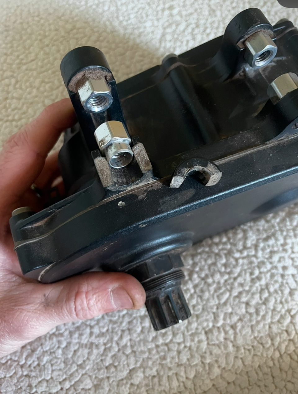

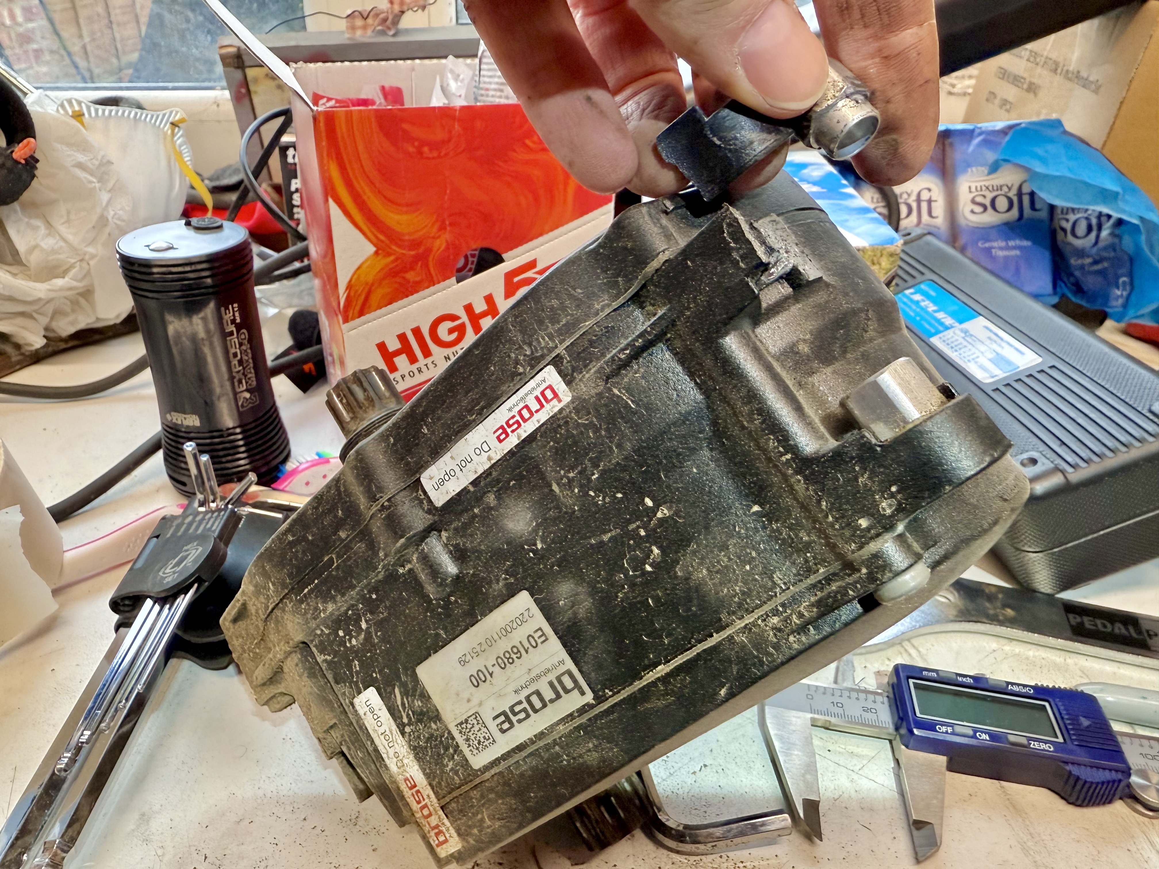

I removed the motor today from my 2019 Levo and was shocked to see that one of the motor mounting points had snapped. See photo.
I was planning to get the motor overhauled anyway so expecting to be spending close to £400 with postage.
Does anybody know if the case is an available part and if so how much this might add to my bill?
Also, could I have done this while removing it? I didn’t have to apply any force to remove to I doubt it.
Anybody else have any experience of this?
Thanks
DS.

Had same problem and motor was failing went down the ebike motor centre route cost me £560 but if it was to happen again I would contact specialized first and see how much a new motor would be just had to do a 500 battery that had failed from a 19 Levo and got 25% off a new 700 battery

Thanks. I think I’m on the outside of the Specialised assisted purchase scheme having bought mine Oct 2019 but I’ll defo check.

I think this fault would be covered by the Consumer Protection Act, but your first call should be to Specialized.
Edit: manufacturer liability for faulty design and/or manufacture does not end with the end of the warranty period.

I had same other week couple of lugs had cracks . Torquing up (duh ) bolt sheared and lug came off as well. I will just ride it till motor breaks and get new motor , 4 bolts still ok.
