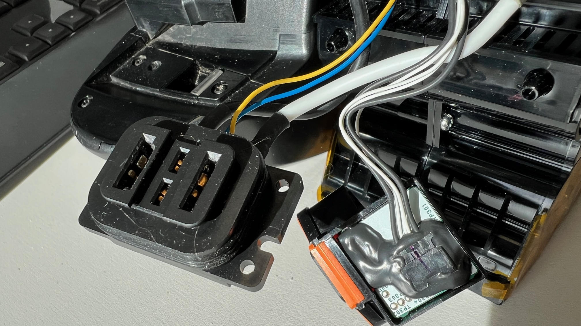

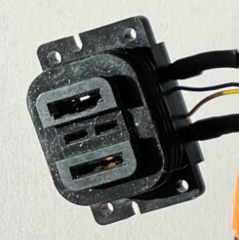

I need to replace the Bottom Connector of the BT-E8016 Batterie (i think BT-E8010 is the same)
Does anybody know where i can order this Part?

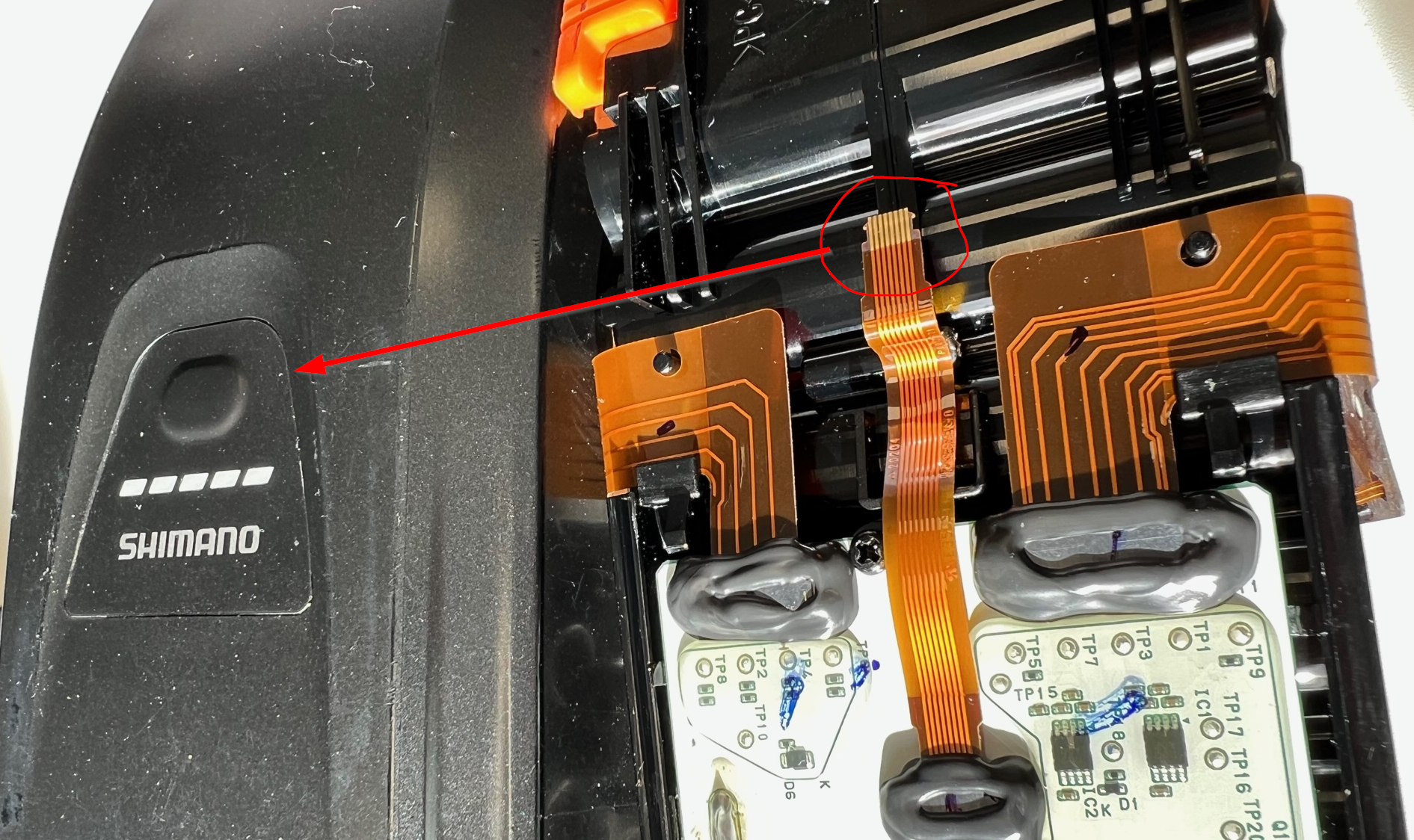

I actually can't imagine how I can plug the ribbon cable back into the ON-OFF switch ... :unsure::unsure::unsure:

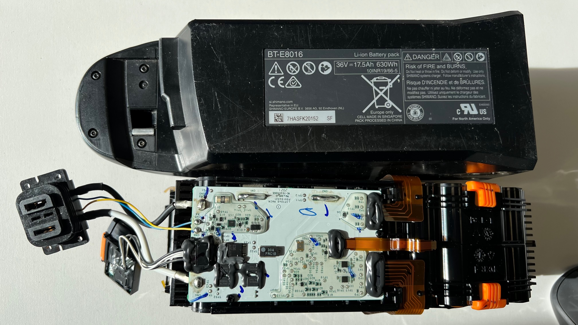

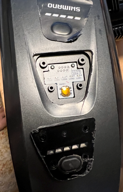

Did you see the post about the battery re-cell? Looks like at least on the e8010 battery the on/off switch is on the mainboard of the battery so nothing to re-connect. Can the switch be removed from the case shell and connected?
What cells are in the battery out of interest?

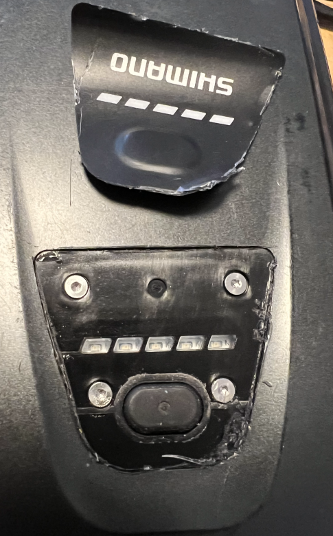

sticker ? where ? over the power button on the case?
so what would the steps be afterwards?
thanks for the prompt reply
just remove carefully the Sticker over the Power Button with a Knife and you will see

just one more thing how did you guide it in to the cover to get to the right spot - any tricks for that too
thanks again this has helped heaps

i don't remember ... slowly put in and fishing at the right moment with tweezer somehow ... was'nt to hard i think
