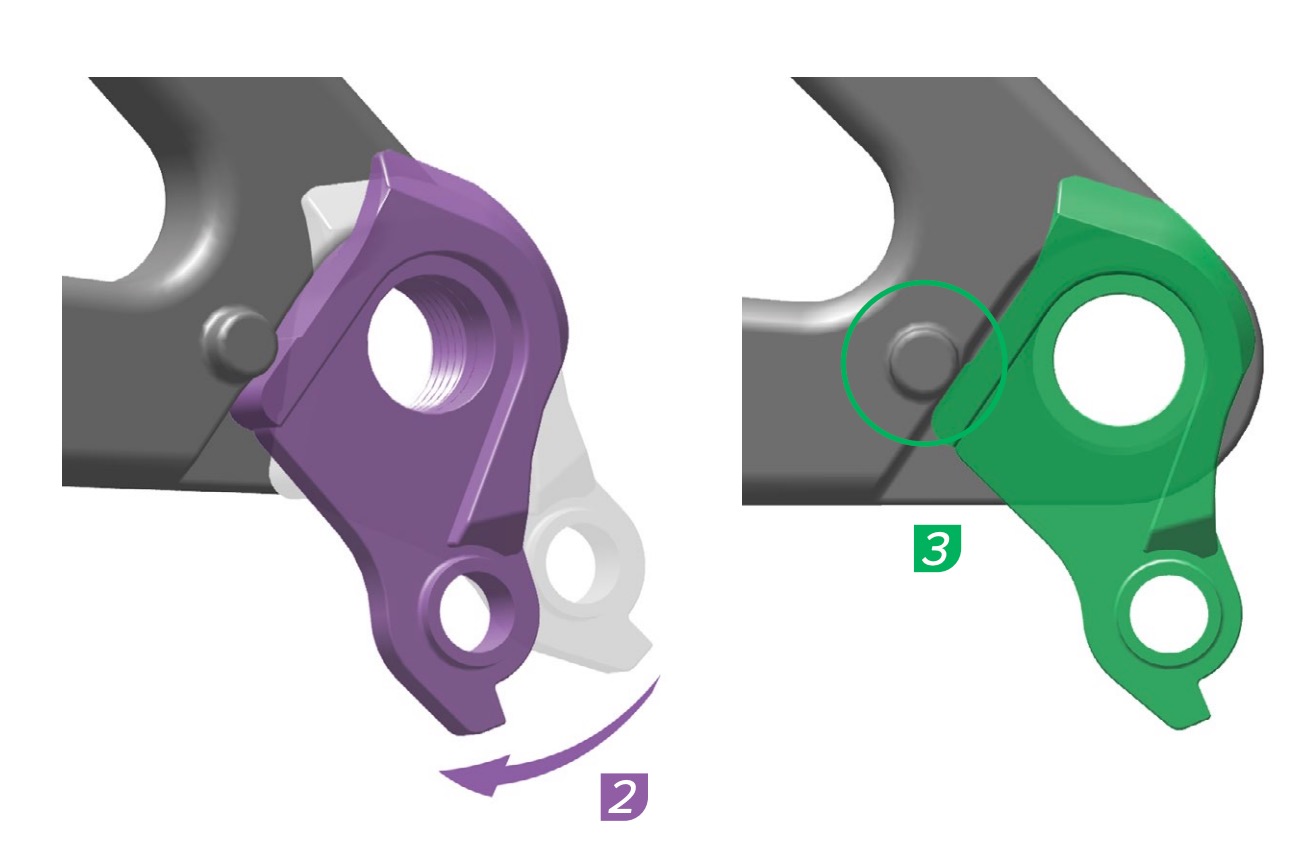

It would have been installed incorrectly or was VERY loose to rotate forward - either way, it's on the shop/Trek to make it right.

Must of been in correct as that little lump circled with number three is missing / broken off and that ridge has been broken away

I was wondering whether you contracted the job out ,or the LBS did it...and if so did they apply invisiframe under the mounting. If you did the job and stayed clear of the hanger area there is no reason why anyone can hang the blame on you. It looks simply like a case of the hanger not being rotated properly against its stop when originally fitted. It then only took a couple of gear changes for chain tension to rotate it with force sufficient to rip the stop off etc.
That said, it does look like the design was an attempt ( failed) to prevent damage to the carbon chainstay in the event of impact. They avoided using a locating/securing grub screw and just went for fairly feeble stop instead.............well any impact causing the hanger to be rotated is hardly likely to be stopped by a small carbon stop ..........so it would get destroyed regardless. The shear point needs to be on the hanger so it breaks first!!

Thatā€™s exactly what I believe it was when I took the wheel out today to see what had happened the hanger had ridden over that little stop peg so I think it wasnā€™t sat against there properly when the bike was built , itā€™s then been force further round via the gear changing thatā€™s caused further damage to the frame

Its a known problem, unfortunately yours wasn't caught early
This video is about the damage caused when the derailleur hanger moves toward the back when not torqued to spec. Something caused the OP's hanger to move forward, which means incorrect installation or it was VERY loose.

A word of caution. The Trek Rail 5 is ally not carbon and on the YBM video there is clearly no "stop" against which the hanger should be positioned as on the carbon frame version. So the arrangement appears to be different and that torque of 25nm may be excessive on the carbon framed bike.
Both systems look to be lacking good design to me! One relying on friction ( are the faces of the nut and hanger serrated even??) and the other on a carbon stop.
totally agree on the video the guy says torque to 25 nm which is to high for the carbon frame
my bike the bolt says 20 nm
it look like when mine was built the hanger was possibly sat on top of the stop peg so the hanger was at a angle which is why it moved so easy and the stop I think is completely broken off

Not possible, the gears would never have been indexed and your derailleur would have been in your spokes the first time you got anywhere near your biggest cogs. Mech hangers have to be sat in perfect alignment for the gears to index, especially with 11 and 12 speed groupsets, which is why a derailleur alignment gauge is probably one of a mechanic's most used tools.

Mine was loose at purchase (rail 5) - be careful tightening it, when I did the hanger rotated as I tightened it and it cracked. Fortunately local shop had the hanger, bought two and I carry the spare n my pack.

Here's SRAM's page for the hanger, with some explanation of why it is what it is how it's supposed to operate - it is expected to rotate.
