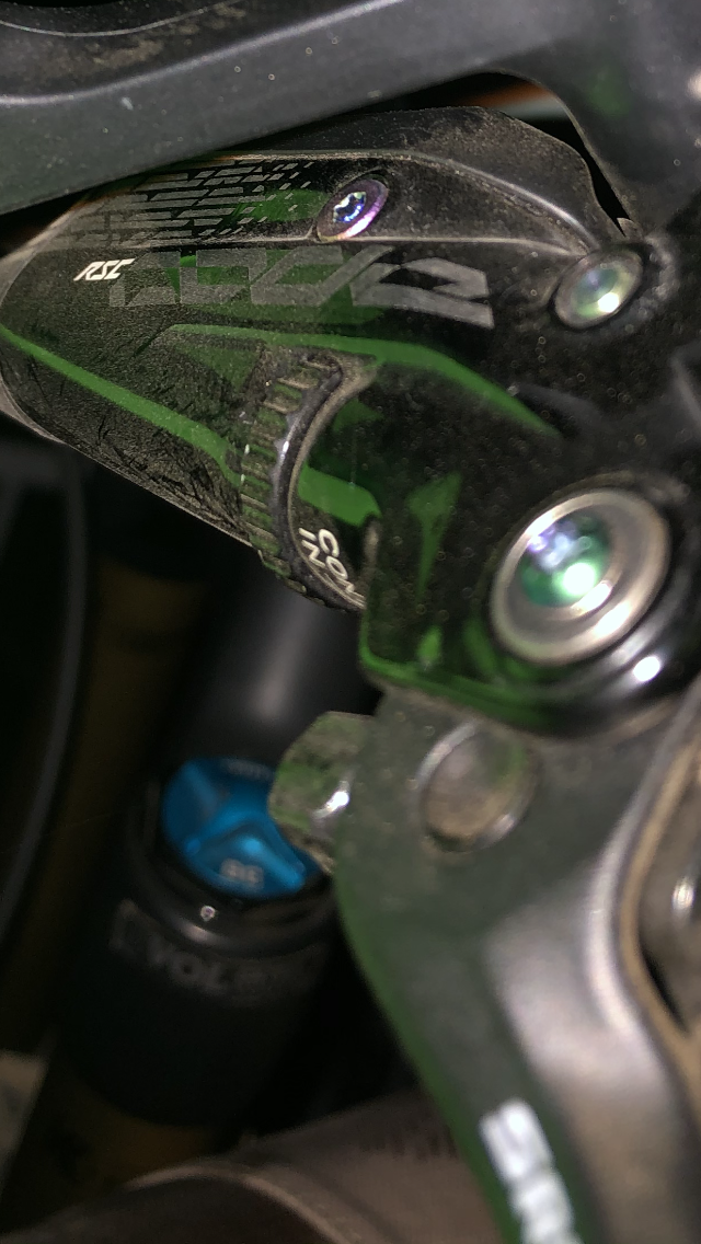

I've had plenty of woes with the Code R's fitted to my Whyte. I've come from 15 year old Hope 4 pots and the Code R brakes left much to be desired; spongy, lack of braking force and horrendous lever travel. Bled the rear, lots of air in it, a little better but still lacking force and too much travel.
Much googling ensued, one post stood out, something like:
I've fixed my SRAM brake issues - I had the LBS install Hope brakes
Don't really want to chuck 400 odd at new Hopes but I've now got to point where I'm reasonably happy with the performance due to a better bleed procedure and some Trickstuff 840 power brakepads:
I've also got some deslackinators on order but god know how long they'll take to arrive.
I followed the GMBN videos How To Bleed New Sram MTB Brakes and Henry's Disc Brake Hacks, both of these helped especially the balancing of the low and high pressure systems but the key factor in improving the overall performance came from a post on PinkBike by a guy called slabshaft: Sram guide ultimate rear brake spongy
The key is at the end of the bleed, once you've pressurised the lever end and removed the syringe (thereby losing all pressure and spilling loads of fluid...) is to slightly undo the bleeding edge port and apply quite a bit of pressure on the syringe to force more fluid into the caliper, pre-loading them, then with the pressure still applied, close the bleeding edge port.
Getting the amount of pressure/fluid in the caliper correct took a few goes to get right, too much and you can't get the block out, too little and it's spongy.
Could do this with wheel and pads in, lever depressed a little and very, very carefully opening the bleeding edge port. Warning - If you do this with the wheel in, be really careful not to spill any fluid on your nice clean, uncontaminated pads and disk - it'll end in tears.
I got to the right pressure by doing this with the pads in and the wheel out and used a spreader like this (super handy tool) between the pads for them to squeeze on - you can then massage the pads and pistons back in if required.
I've now got my levers screwed all the way out, the bit of slack allows me to hook my finger over the lever and hold it in a bit before they bite - the deslackinators should help there - but the braking performance is much, much better, lever no longer goes to the bars and confidence much improved.
Is it the pads? Is it the bleed? A combination of both? Not sure but I've not crashed due to inability to slow down and I've not had cause to bitch about them at all since ;)
