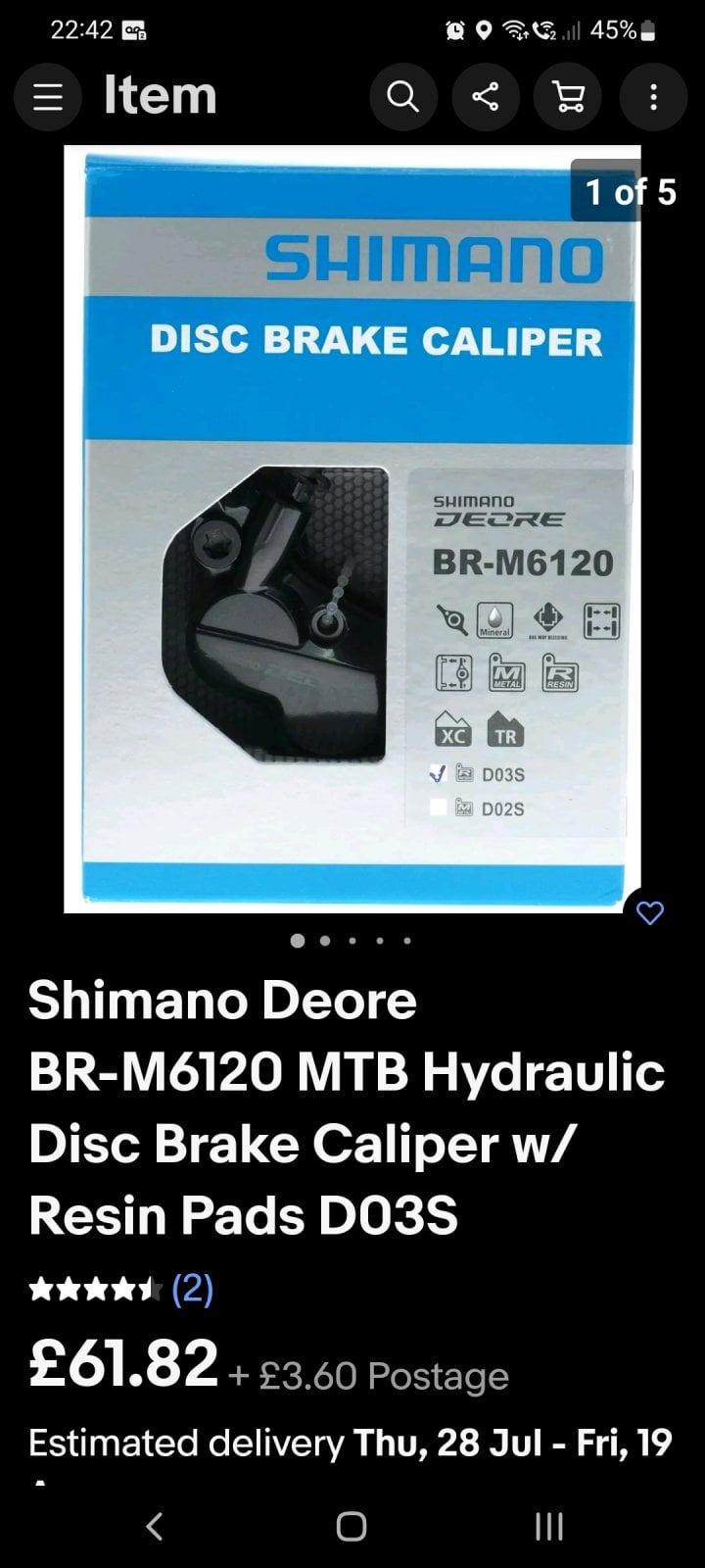

I also bought M6120 calipers, reason being is I didn't want to have to run new hoses and I believe the M6120's should be a straight swap and a brake bleed will be all that's required.

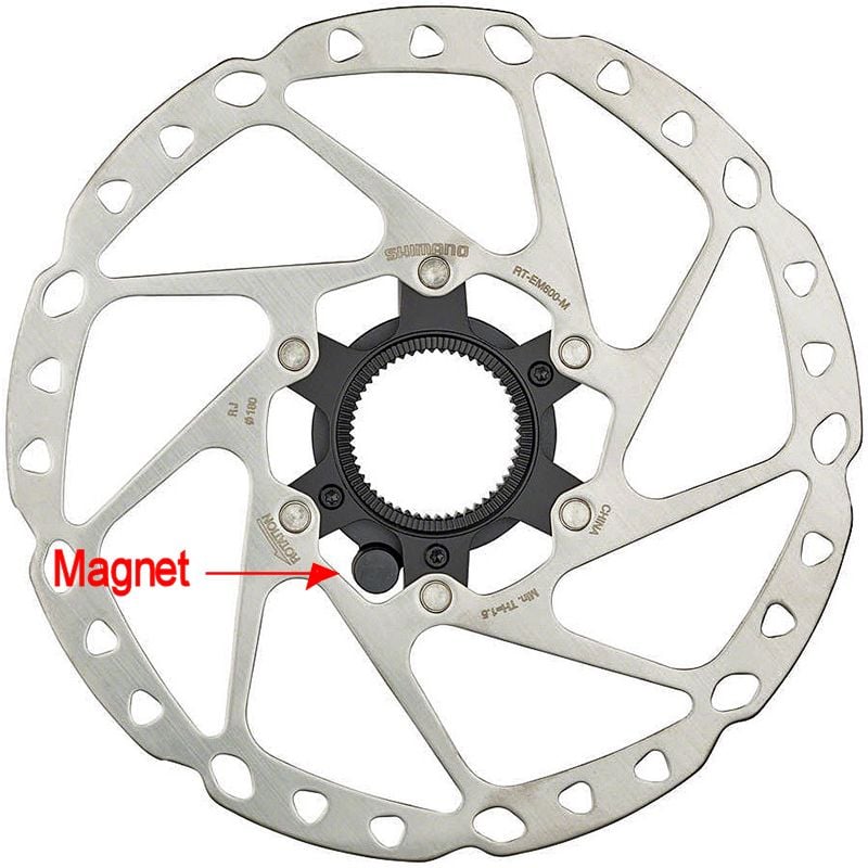

BuggBairn, I've attached answers to your questions. I hope this helps.
Question: I ended up buying 203mm MT-800 rotors, I was a bit confused about the magnet on the rear, I believe the one I have purchased has the magnet attached to the lockring. I hope the ones I have bought are compatible.
Answer: eBike assistance speed is regulated by law. In the USA it's 20 mph for Class 1 eBikes. In Europe, I believe it's 25 km. On the Rise, a speed sensor pickup is mounted on the inside edge of the non-drive side chainstay.
Orbea Rise speed sensor pickup mounted on non-drive side chain stay

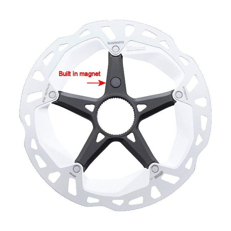

A magnet is mounted on the rear brake rotor. As the rotor turns, the magnet passes over the speed sensor pickup. The speed sensor pickup records the magnetic pulse and sends the information to the motor. The faster you go, the more rapidly the magnetic pulses occur. The motor's computer uses pulse frequency to determine bike speed and when to turn off motor assistance.
Rise M20, 180mm centerlock RT-EM800 rear brake rotor with magnet.
I once saw a picture of an Orbea Rise using a magnet adapter that clamps around the circumference of centerlock retaining ring. I've yet to see one in person. If your M20 came with the clamping magnetic adapter, then you do not have to buy a "Rear" brake rotor with the built in magnet. If your Rise M20 did not come with a centerlock rotor magnetic adapter, then you will need to use a centerlock brake rotor will built in magnet.
Note: If the speed sensor pickup does not register a magnetic pulse as the wheel turns, the motor's computer will throw a fault code and the motor will turn off.

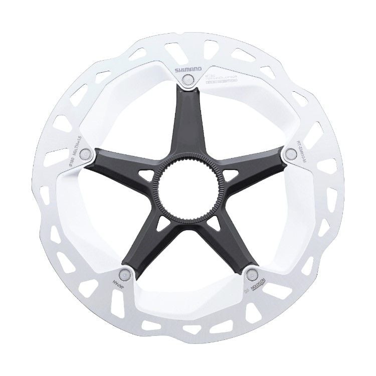

Shimano XT, SM-MT800 centerlock brake rotor, non magnetic version.
Shimano XT centerlock brake rotor, SM-EM810, "Magnetic" version
Question: I also bought M6120 calipers, reason being is I didn't want to have to run new hoses and I believe the M6120's should be a straight swap and a brake bleed will be all that's required.
Answer: You are correct. The Rise M20 comes with straight fitting Shimano brake hose. The M6120 four piston caliper uses straight fitting brake hose. I recently installed a set of M6120 brake calipers on my buddy's Rise. We left the stock Deore brake levers that came with his Rise M20 on the bike. They M6120 calipers and 203mm rotors are an excellent upgrade.

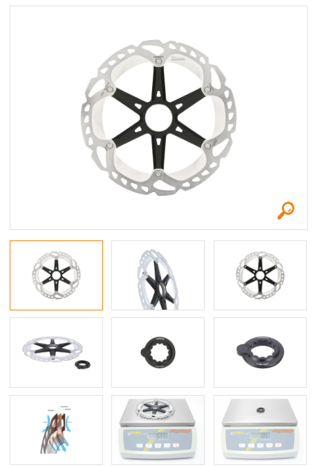

Hi Rod
Thanks again for such an detailed response, I appreciate you spending time on this.

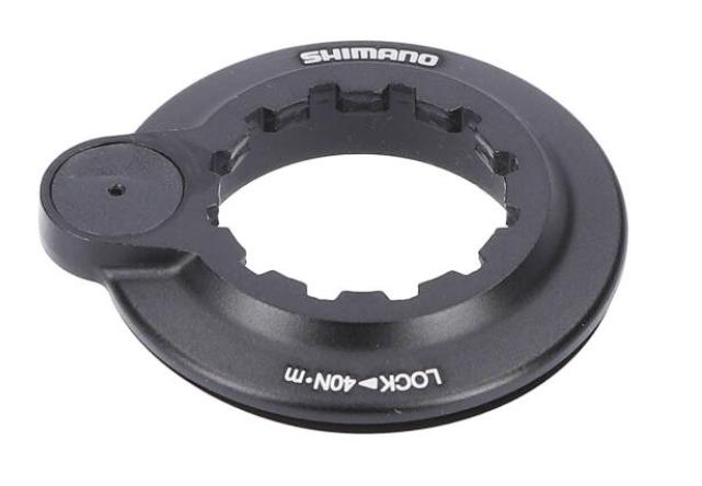

This is the rear rotor I have purchased
It does look slightly different to the one you illustrated as the magnet is built into the lockring. I am hoping that it is still in the right position to pass by the built in side of the speed measurement hardware.
Rod B.
Aug 18, 2021
525
911
USA, Orange County Ca.
Hi Rod
Did the the magnetic locking ring come installed on your Rise M20?

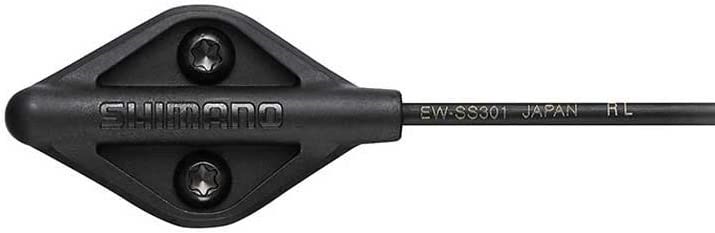

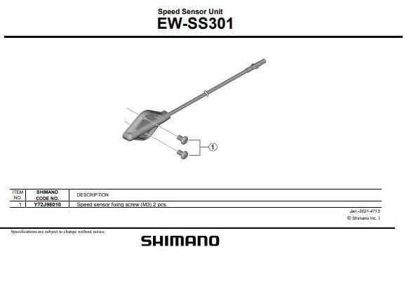

Buggbairn,

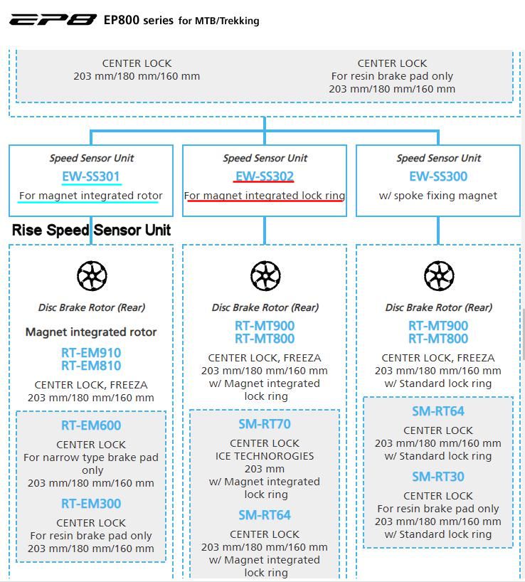

The Orbea Rise uses the Shimano EW-SS301 speed sensor pickup.
I checked Shimano's compatibility chart for the EW-SS301 speed sensor unit. I've highlighted the Rise's EW-SS301 speed sensor unit in light blue. Below the EW-SS301 speed sensor are all of the brake components which are compatible with the speed sensor unit. Any Shimano centerlock rotor will work with the Rise's EW-SS301 speed sensor unit as long as the magnet is integrated into the rotor itself.
I've highlighted in red, the brake rotor and magnetic locking ring which you purchased. You will note that the compatibility chart shows the magnetic locking ring is compatible with the EW-SS302 speed sensor unit. Listed below the EW-SS302 speed sensor unit are all of the brake components which are compatible with the EW-SS302 speed sensor unit.
NOTE: I would give the magnetic locking ring a try and see if it works. It may work. According to the compatibility chart, it may not...I've experimented in the past with various magnetic adapters. If the magnetic locking ring doesn't work, you'll encounter one of these symptoms I've listed below and will need to purchase an integrated magnet rotor, i.e. RT-EM810, RT-EM600, RT-EM300, etc.
Symptoms of the Speed Sensor Unit not picking up the magnet:
1.
The bike will power on. When you try to pedal, the speed sensor unit will not pick up the magnetic locking ring's pulse and immediately turn off. A red light will appear on the EW-EN100 black junction box. The motor will not power up unless your turn the bike off and back on. The moment you try to pedal again, the bike/motor will turn off and the red light will appear again. If you open the Shimano E-Tube app and connect to your bike, it will display a fault code for the speed sensor error in the maintenance section on the E-Tube app.
2. The bike will stay powered on at slow speed. However, as you gather higher speed such as on a downhill section, the speed sensor unit will not read the rapidly spinning magnetic locking ring. The bike will turn off. If you wait a few minutes and turn the bike off and back on, the motor will work again as long as you maintain a slow speed. It the bike's speed picks up, it will red light on the junction box again and the motor will turn off. If you go into the E-Tube app and connect to the bike you will find a fault code in the maintenance section of the app.
3. The bike will work, but as you ride, the motor will cut power and cut back in again. This is due to the speed sensor not reading the magnet correctly. If you go into the E-Tube app and connect to the bike, you will find a fault code in the maintenance section of the app.

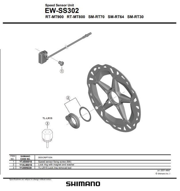

The magnetic locking ring which you purchased is compatible with the EW-SS302
EW-SS302 Speed Sensor Unit and magnetic locking ring
The Rise's Shimano's EW-SS301 speed sensor unit. Note the difference between the two speed sensor units.
