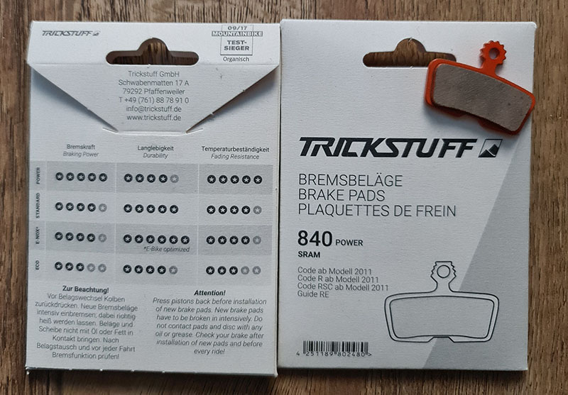

Before you make an expensive swap, try these brake pads. It will blow your minds!
You think you have new brakes.
