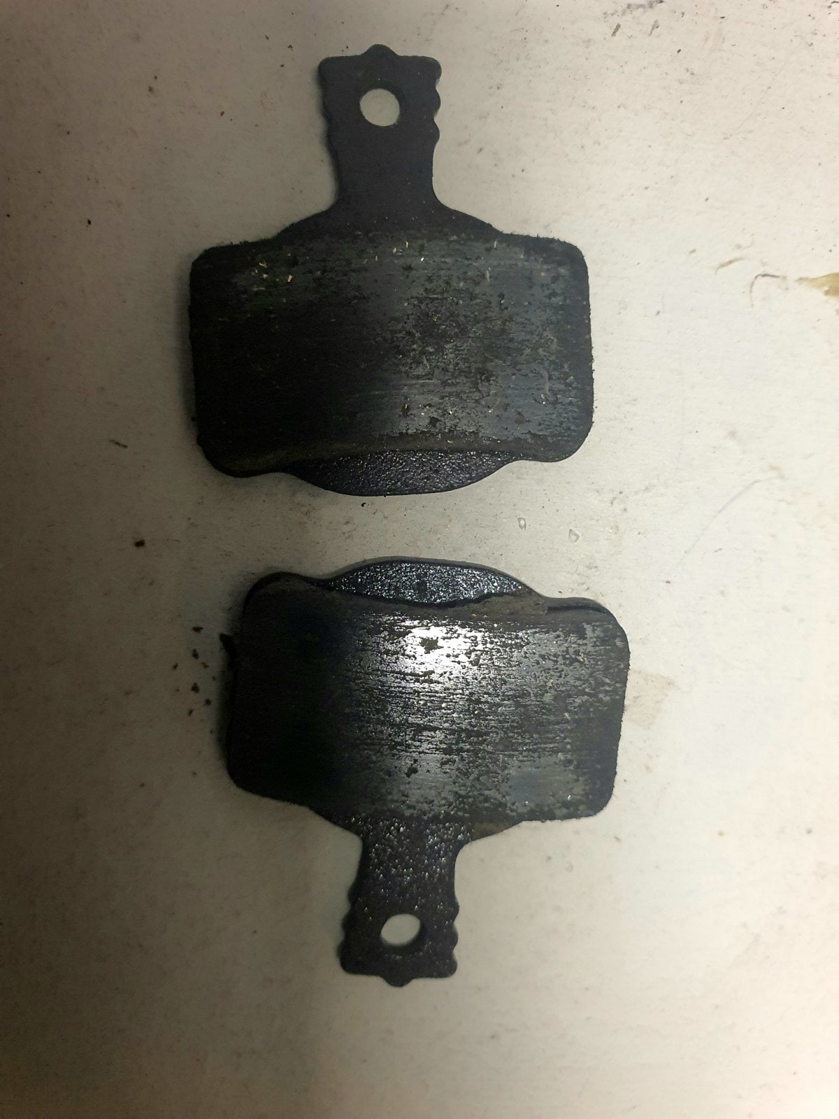

Bloody hell! I have NEVER seen pads that black and shiny before!! Are they a special type, made of carbon fibre or something? Those would be a write off on my bike. They look as though they have been oil-polluted. :eek:
well they are certainly not sintered.........more like cindered!!
Semi metal pads and I don't come close to the pads with oil or sprays
