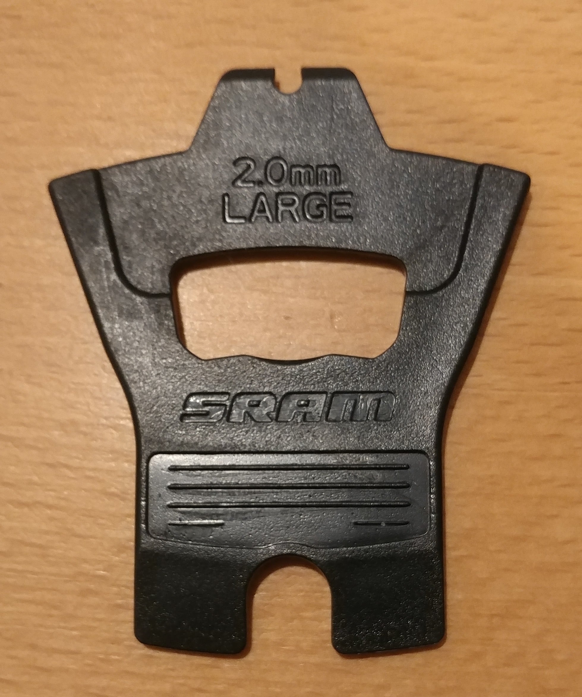

This is perhaps one of the best instructions on how to clean and adjust the brake caliper.
I personally use a plastic tire lever to press the pistons in. It's an old Pedro's lever.
I've used this Sram tool to push back the pistons. Worked well for me and doesn't damage piston or caliper surfaces. Hope this helps.
