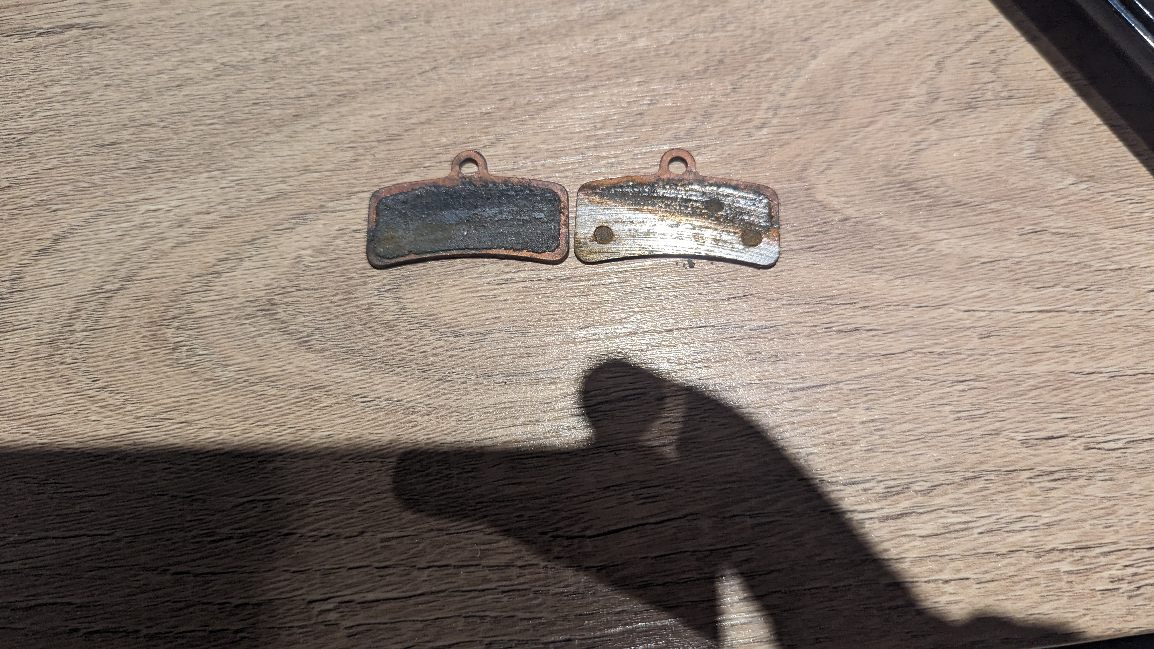

I'm wondering if this is normal after about 200 miles the pad seems to have seriously deteriorated noticed a sequel while out on Saturday just taken pads out to clean and noticed this, brakes are
TRP Trail Evo, 4-piston, sintered metal pads, 220mm front rotor, 203mm rear rotor

I don’t think the rotor is any better. Metal on metal …and the heat that causes. Check for rotor wobble also. Make sure the callipers are centred and secured. Test that each piston is moving correctly.

OMG man.... how did you not hear the brakes making a horrible sound every time you applied them for the last 25 miles? :oops: What kind of trails are you riding on, puddles of mud? At least it you are OK and its only money to repair the issue.

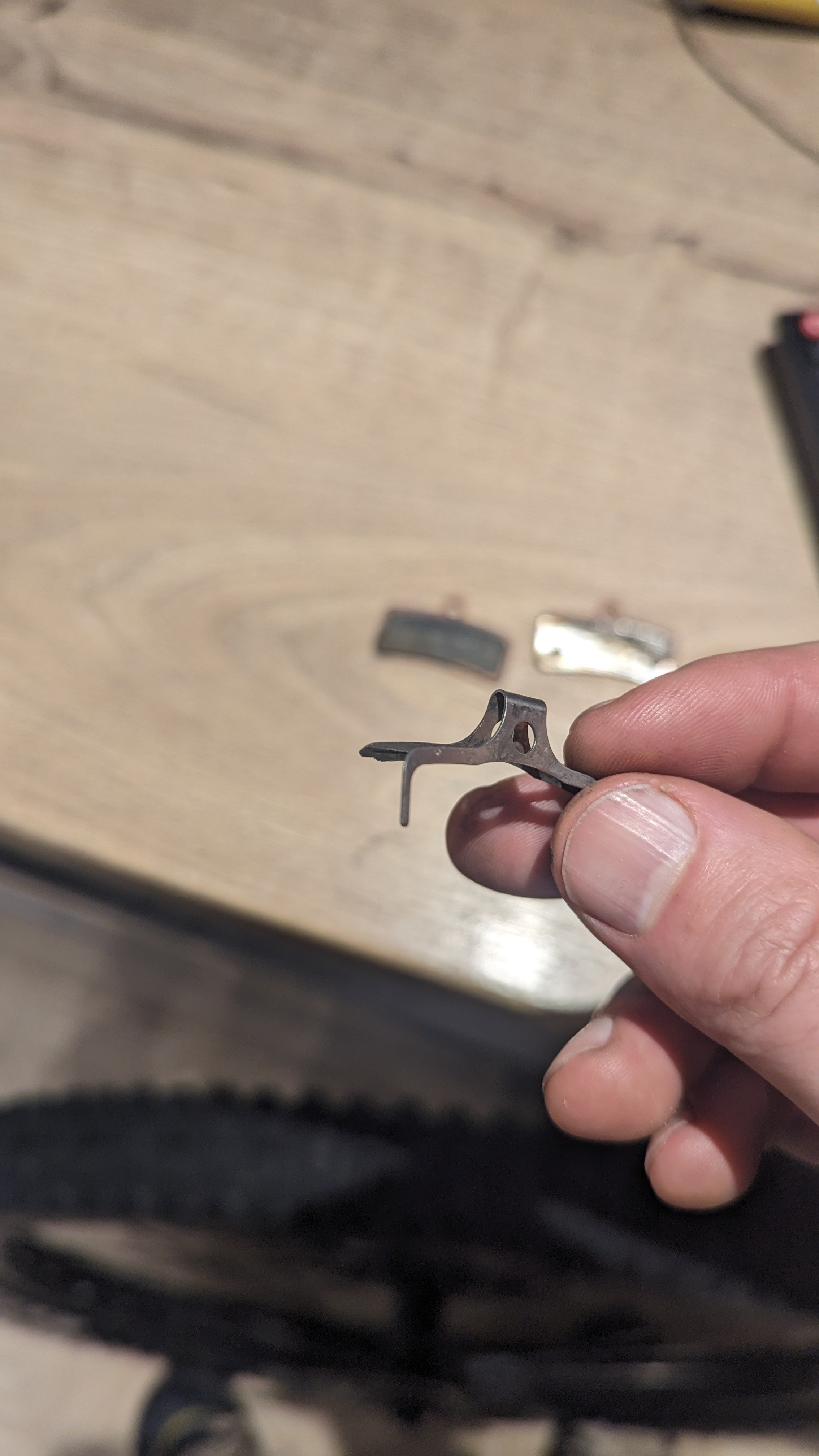

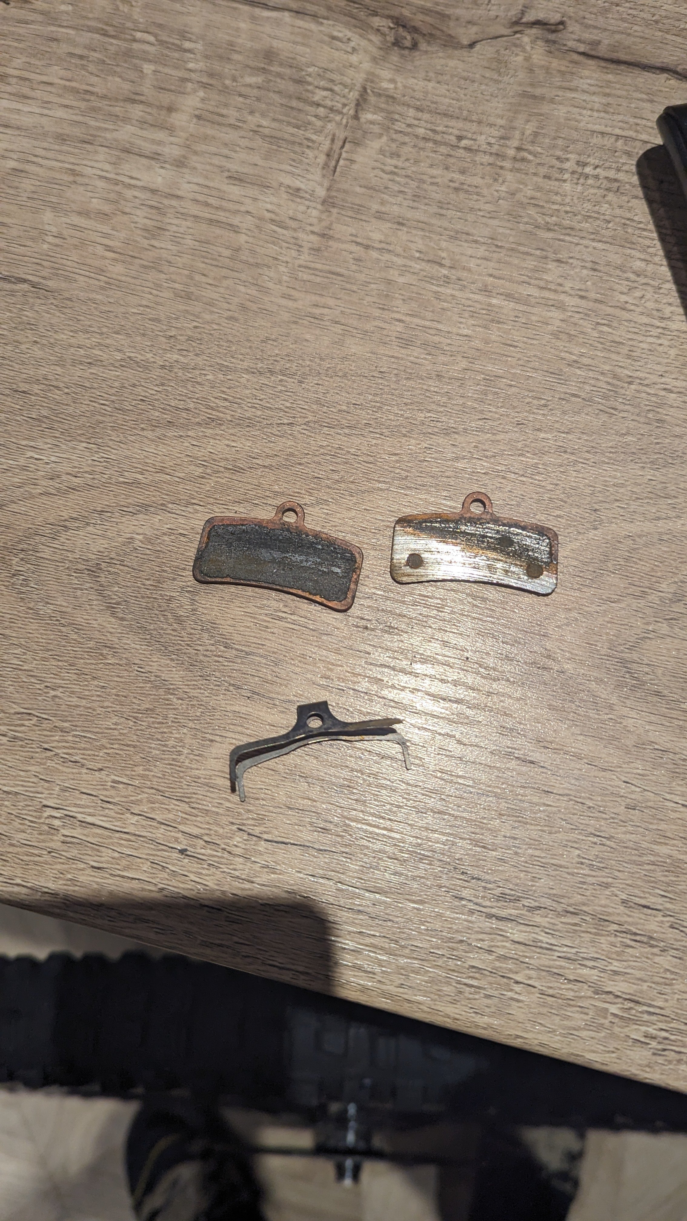

Has he worn the spring away, along with most of his pads ? Dude really needs look after his bike, Check your pads after every wash..
Had a bike shop put one pad in backwards once... got a new disk and set of pads out of them.

If the pads were fitted with the spring in front of (instead of behind) the pad then I guess that's what you could get. If so, the rotor will be toast and as @KnollyBro says, must have made a hell a racket.

that spring is supposed to go inside "or infront of" , not outside.. its to push the pads apart, so back off the disk
That's what I meant. We use the same shaped pads on our Trek Rail 4 piston Shimano calipers. Looked to me like the spring may have been fitted crooked with one end in front of the pad surface.

He's just wore all the surface away, spring along with it

Will get a pic of rotor later, ride a lot in rain and mud!! But shouldn't do that, never even botherd checking pads since having it, but I will now going forward

i wouldent put too much thought into it, pads wear uneven, 2 pot, 4 pot, its just how it is, yours look quite even actually. You just need check your brakes every few rides. Do it after you wash the bike. Theres also no rocket science in bedding pads in, its only to clear off the surfaces, just go steady on the brakes for a few mins, No long drops getting them hot,simples.
But it wasn't not bedding them in that done that to your pads, its the fact you didnt check them.

The damage to the spring is the clue. The spring was not fitted properly in the first place which means the brake pad was not releasing from the rotor on one side and being presented to the rotor at an angle when the brakes were re applied. The accumulated rubbish on the pad shows that it was not being wiped......it only gets wiped by the rotor if the contact is along its full width front to back.
Those pads are toast...........best to check the rotor for damage as well.
