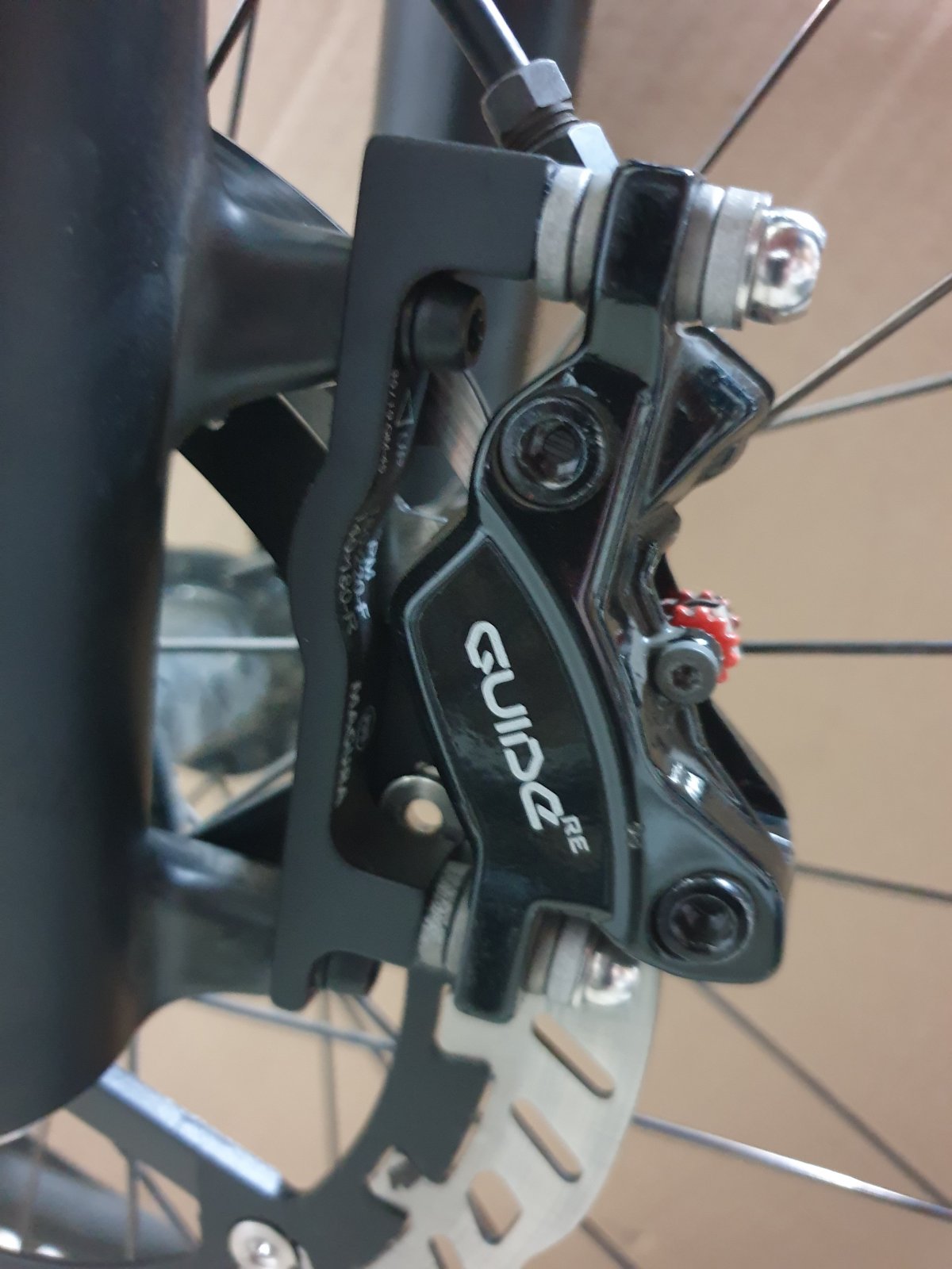

This really depends on the fork and the brake you have on your bike.
E.g. on my 2020 Levo Comp the RS Lyrik fork has a PM7 mount (direct mount for 180mm disc) and for the stock 200mm disc it came with a p20 adapter that was mounted with the same bolts as the brake calliper (bolt going through the brake calliper and the pm adapter into the pm mount of the fork).
For PM7 mount using a 220mm disc a p40 adapter is required.
I used the MAGURA Adapter QM45 (PM to PM | +40 mm FW/RW), it's coming with the bolts to mount the adapter onto the fork.
For mounting the brake calliper to the adapter separate bolts are required as the mounting points on the adapter for the fork and for the brake calliper are offset (not inline as for the p20 adapter). See the pictures attached, one shows my bikes original stock configuration, the other one the setup for the 220mm disc (MAGURA MDR-P 220mm) with the SRAM Guide RE brake.
Next tricky thing is the SRAM Guide RE calliper that came with my bike. It's an older calliper that has the old SRAM/AVID CPS system that requires the CPS washers when mounting the calliper. If you have that brake then read ahead.
I personally would not recommend to mount that calliper without the CPS washers, because it wasn't designed for this and for that reason I guess Specialized used them too. One point is the offset from the calliper mount (vs todays standard direct mount) which must be compensated the other point is getting everything good aligned as the adapter is changing the angle. Attached also a picture about the order that washers a attached.
The original bolts from the stock configuration are too long and can't be shorten as the thread would then be too short. New bolts are required.
I went for the original SRAM/AVID CPS bolts set (EAN: 710845714481, MPN: 00.5318.006.000). It includes the long CPS system bolts & washers and two shorts bolts for standard mount.
