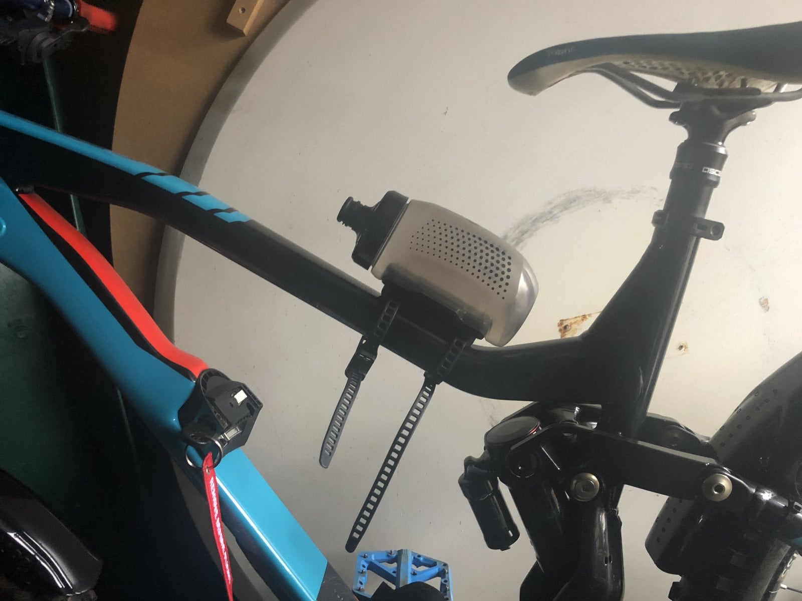

Hey fellow Vitus riders,
Looking for ideas to add a bottle cage to my ride. Anyone out there tried the various strap on Bottle cage holders ? If so, what do you use and where do you fit it ??
Looking for ideas to add something either to top tube or seat post (below dropper if possible)
Cheers,
Fraz
9,190
This thread covers some of the options:
Drink Bottle Mount Alternatives - EMTB Forums
The best option is the fidlock bottle, which isn't covered in that thread, and is also not the cheap. The strap on Unibase mount, with the smallest size bottle will work on the underside of the top tube on the L and XL, but not on the smaller frame sizes. You can also mount it on the top of the top tube, or the underside of the down tube.:
produkte.html
