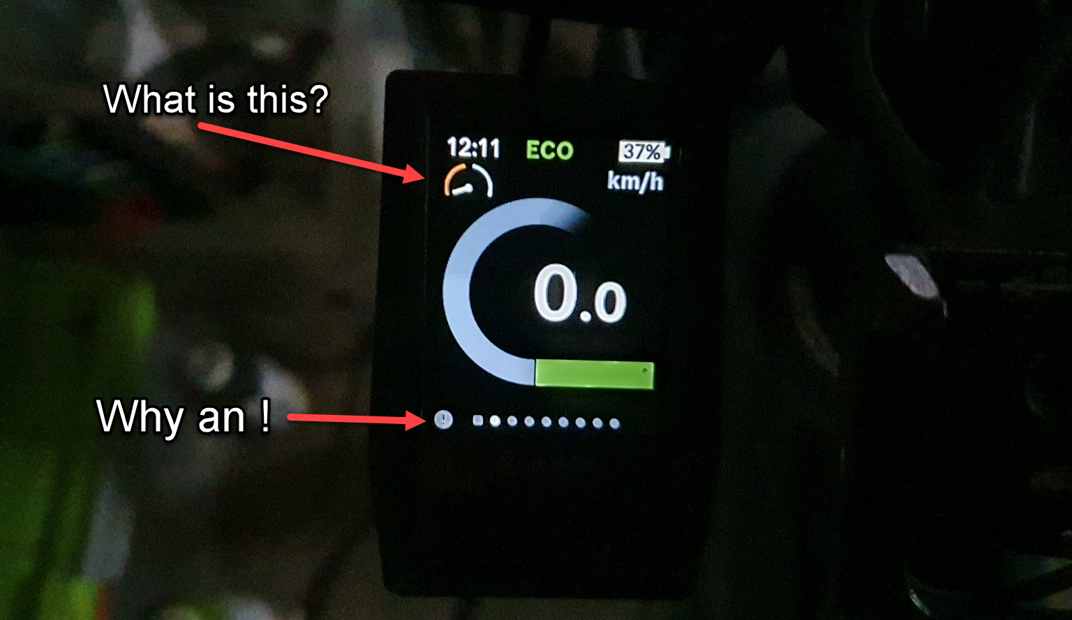

The layout of the kiox has changed. a bar has changed to a gage. But can anyone tell me what it is showing?

I'm pretty sure the 'speedo' in the top left corner is an average speed indicator.
Needle to the left = slower than average (orange)
Needle to the right = faster than average (green)
The old one was a couple of bars that worked similar
Not sure what the ! indicates though.

And the bottom left can show a ? as well which means your phones connected but it hasnt got a gps signal

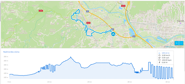

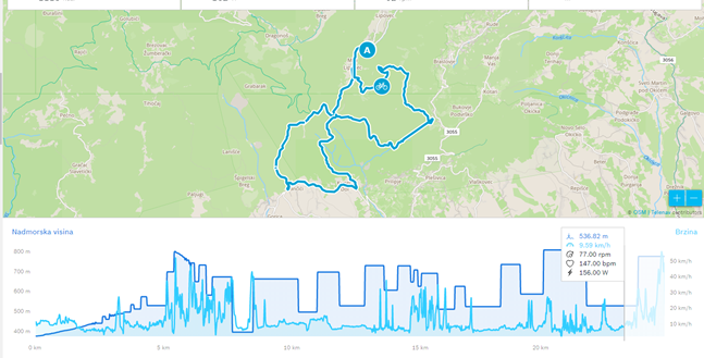

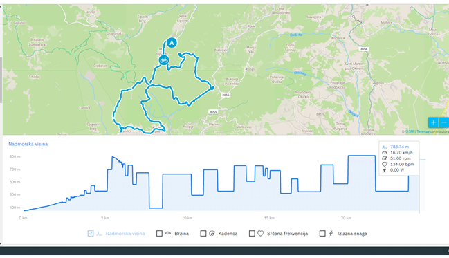

After upgrading Kiox to 4.0.2.0 version ascent/descent data are available, but are ridicules. I'm using iPhone 5s for connection with Kiox, does anybody has similar problem?

I suspect your phone is switching into a power saving mode or something preventing it from recording the actual height changes
I try with Android phone and it was little bit better but still not good. What settings in iPhone should I check to prevent it to go in power save mode?
