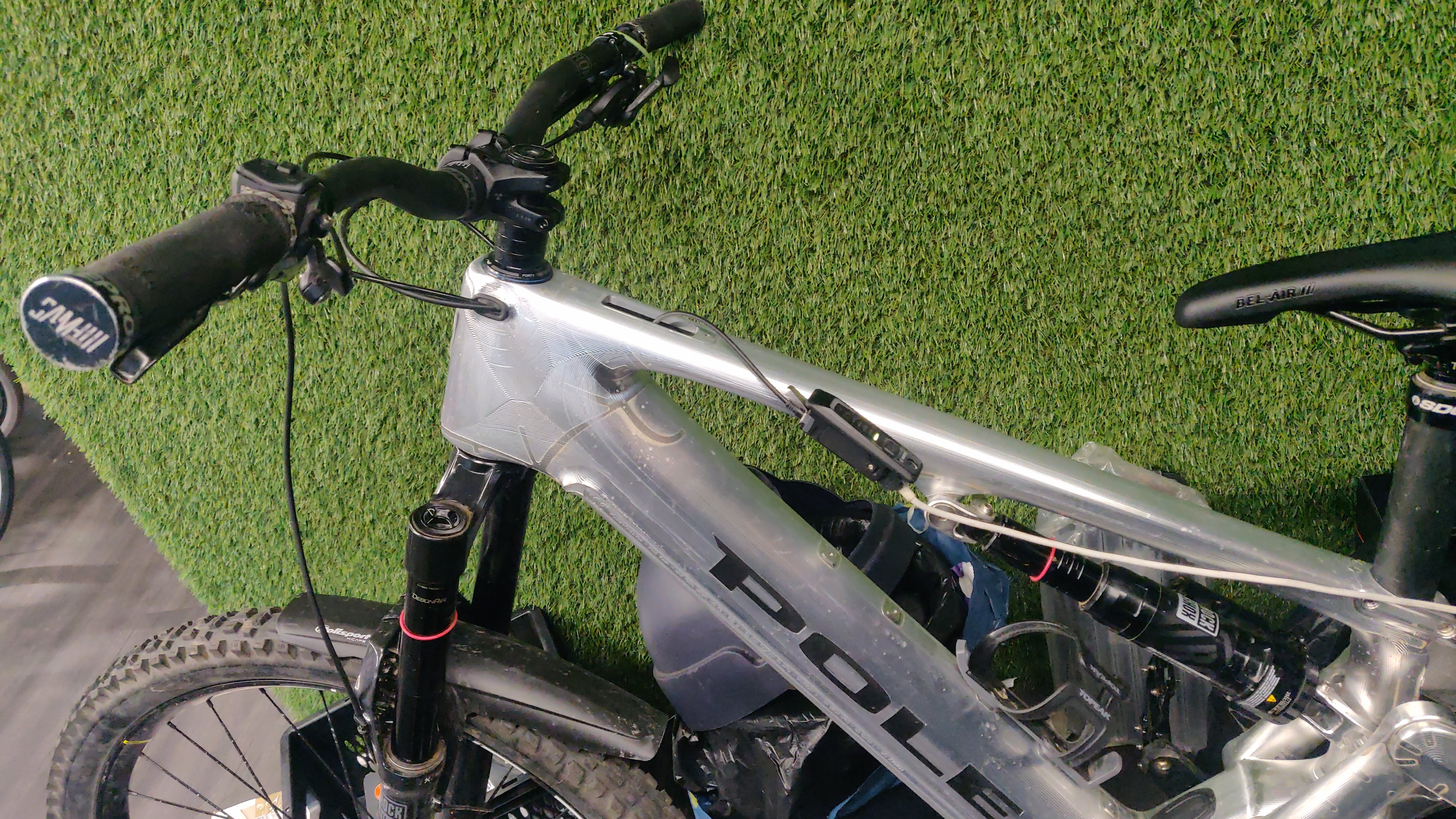

Anyone know how the dealer connects a Bosch smart system, without a display, to the laptop ?
Sijmes Member Sep 22, 2018 126 48 Netherlands May 5, 2023 #1 Anyone know how the dealer connects a Bosch smart system, without a display, to the laptop ?
Mikerb E*POWAH Elite World Champion May 16, 2019 6,521 5,001 Weymouth May 5, 2023 #2 usb connection on the LED Remote.
Sijmes Member Sep 22, 2018 126 48 Netherlands May 6, 2023 Thread starter #3 My led remote is in the top tube, as far as I can see there's no port ?
Sijmes Member Sep 22, 2018 126 48 Netherlands May 6, 2023 Thread starter #4 You can remove one torx screw and lift the display out of the top tube. The usb port is in the led display behind a rubber cap.
