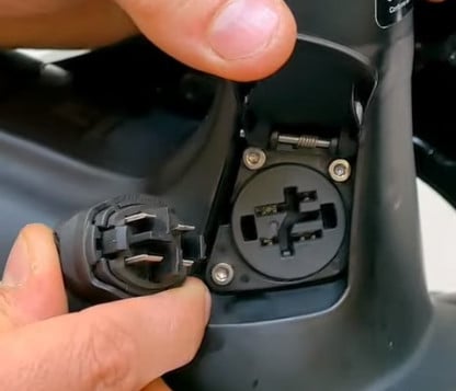

I just bough my Cannondale with Bosch 4Gen Smart System, according Serial Number label, it was manufactured on May 22th 2023, so I was checking if the new Power More Extender is compatible with it, and it isn't. I'd say Bosch is shooting himself in the foot, there is a huge market of older ebikes willing to use a Bosch Extender but they don't provide it.
Power More has a new plug that will not match older Charge Sockets, probably 2024 ebikes will have "Bosch 4Gen Release 2", and they will include the new socket.
I found it in this video:

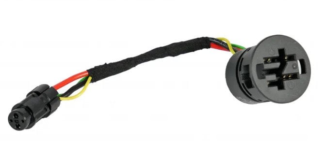

To make things even more confusing, ebike24 shop is announcing the new Bosch Charging Cable as: Compatible with Motor Performance Line CX starting from 2022 Smart System, so according this, if I buy this cable and install it then my ebike would be compatible with Power More Extender.
But Bosch web states that Power More is only compatible with 2024 Smart System, so I guess we won't know for sure until somebody buys the cable and installs it in a 2022 Smart System and tries Power More 250.

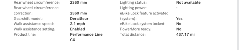

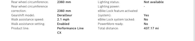

I have a 2022 cube. I noticed on my service report that is says”‘power more ready: no”
Most of the other settings shown there can be changed. So maybe it can be activated?

Ebike24 states that it's only possible to run a diagnostic to find out if the bike is compatible. They also say if thats not the case you can try to mail the manufacturer if they can provide a software update

  • All ebikes with Smartsystem have the SW prepared to connect the PowerMore Range Extender, and in the diagnostic this new line appears POWERMORE READY = YES/NO.
  • But the other requirement is that the frame has reinforced threads for the water bottle so that theycan withstand the 1,5Kg weight of the PowerMore, compliance with this requirement is decided by the bike manufacturer and it is reflected in the Diagnostic configuration: POWERMORE READY = YES/NO
  • If it is NO, you must ask the Bike Manufacturer and request a SW update to set it to YES

As far as I have heard, the Monterra is not yet equipped with the new style plug necessary to use Powermore.
You can buy the new charge cable for 23,28€, and the installation is not difficult.

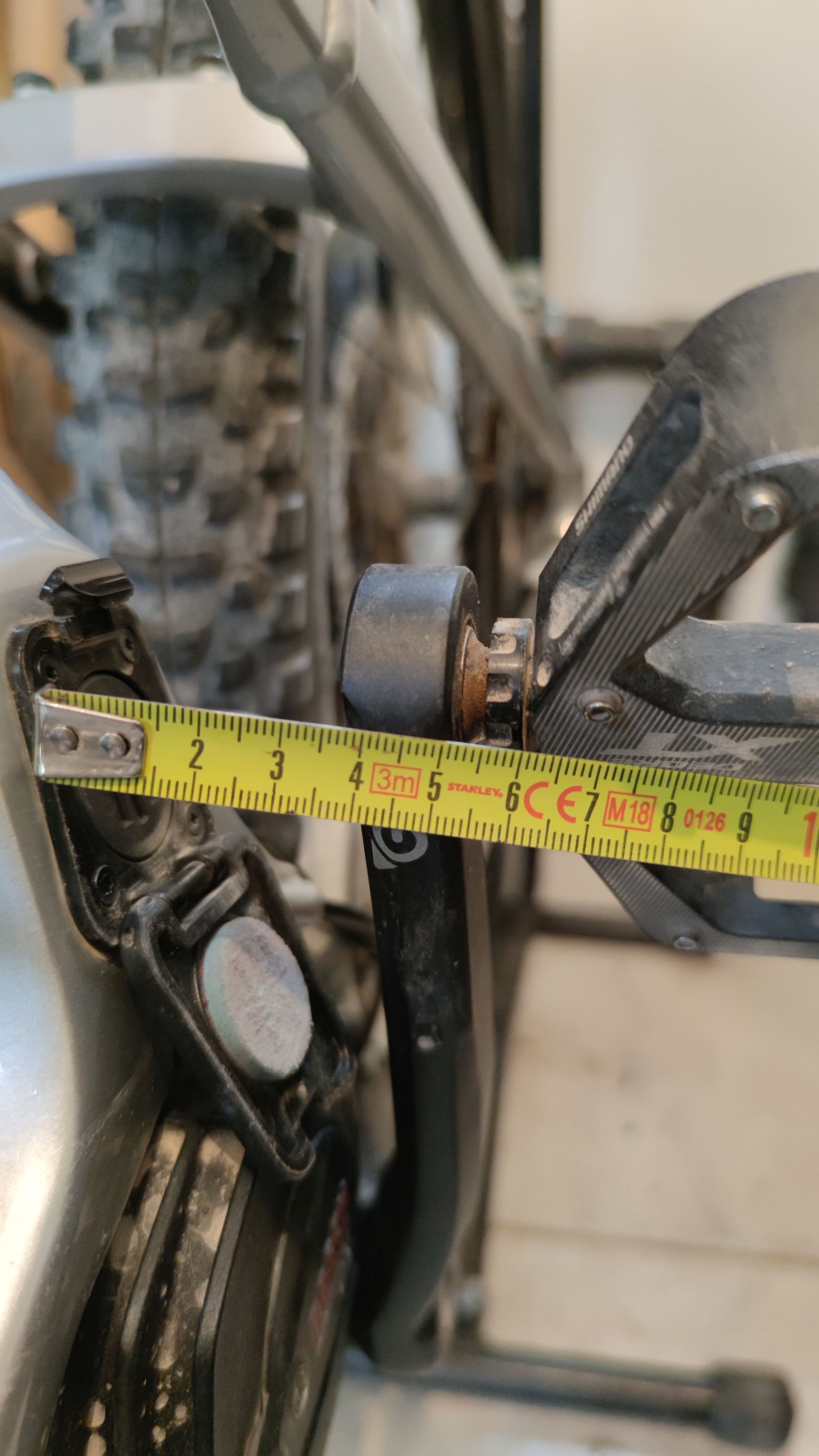

Maybe you also will have a problem with the position of the charging on that bike. I remember to have read a test, claiming that the cranks of the Monterra LT can collide and will damage the flap of the charging port when left open. As you have to plugin the Power more cable there, this could be a complete showstopper for the Powermore on your bike.
Regarding the position of the charging port and the flap door for it, I checked it again and the flap door opens 180º and there are 35mm from charge port to the crank (See attached picture), which should be enough for the Powermore connector, you just have to install it so the cable exit is pointing upwards and use a zip tie to secure the cable to the frame downtube. The only issue I see is that when the flap is open 180º (flap pointing downwards) the spring is not holding the flap strongly in this position, so it might be neccesary to secure it using adhesive tape or some other method, but as I said, I'll use the Powermore sporadically and at the end of a long day, after the the main battery (750W) is depleted
Anyway: there is a hint in the video obove to a theoretical solution: in the video they tell us that you can use the power more battery standalone, so you can remove the standard battery (of course not on my crafty ;-). In this case the main battery is disconnected from the CAN-Bus and the only battery present in the system is the Powermore. It migth be, that in that scenario the system will accecpt the Powermore as the main battery without complaining.
I just have an idea to do this, I'll give it a thought and post later or tomorrow

Can’t you just find someone with the bosch software that is willing to turn it on for you?
This parameter is in a Configuration Protected Area that the LBS can not change, I have been told that the procedure is:
  • LBS plugs diagnostic into bike
  • LBS asks Cannondale for the new configuration file
  • LBS loads the new configuration file

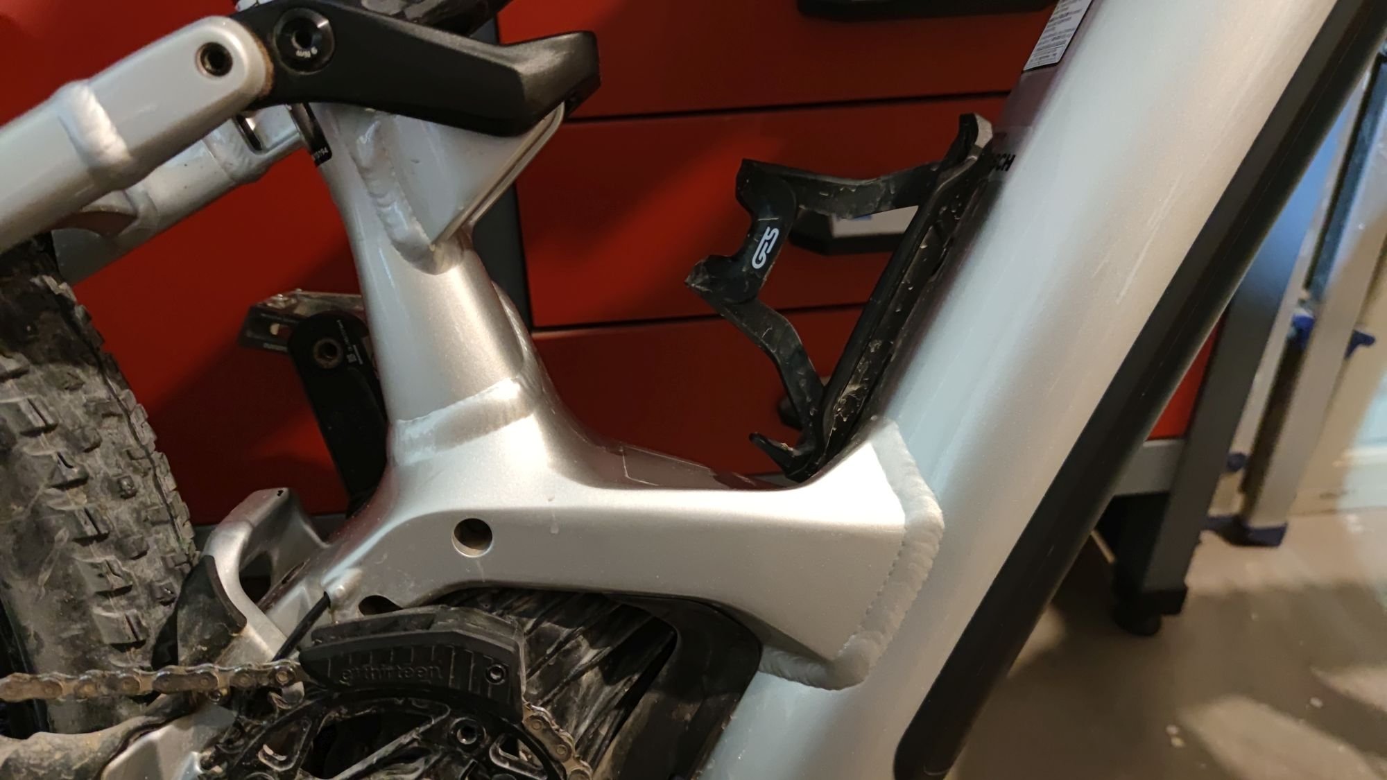

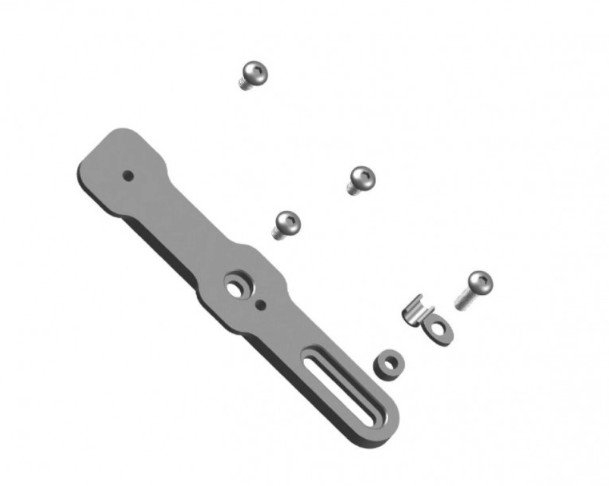

There is another issue to mount the Powermore, the problem is that in some bikes the threaded inserts in the diagonal tube, used for the bottle cage bolts, are very low, probably to lower the Gravity Center. This is not an issue for the bottle cage, but Powermore Mounting plate requires around 90mm clearance below the lower mounting screw and if the clearance is smaller then there is a mechanical interference between Powermore and ebike frame.
This interference happens in Cannondale Moterra Neo, and also in other bikes, and among them is the Orbea Wild FS, and each of them has taken a different approach to fix the issue and keep the customer happy:
  • Cannondale quick and easy solution has been to refuse authorization to mount Bosch Powermore, so now there is no assembly problem.
  • Orbea has taken a more proactive and customer oriented approach and has designed an interposer plate that can be bolted to the low frame inserts, but it has 2 additional threaded inserts in an upper position that allow to mount Powermore. This way customer is happy and Orbea is happier because they sell this interface plate for 44€.
I am attching a picture of the low Cannondale bottlecage that can be moved upwards with Orbea Interposer Plate in second picture.
