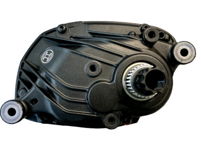

Hello everyone. I bought a new bike, CUBE STEREO HYBRID ONE22 SLT 800, with a Bosch Performance Line CX 5th gen 85nm motor (BDU384Y). Bosch Kiox 500 display.
I live in Spain, and we have a speed limit of 25 km/h, as in the rest of the European Union. 32 km/h would be enough for me. I thought I could easily buy a chip that would remove this speed limit, but after reading the forum more carefully, I realised that it's not that simple. Please help me, what is the most stable and proven solution available today?
There is no good solution unless you can find a Local Bike Shop to flash it to USA or any other country that supports 32kmh.
None of the chips work without issues.

Sorry, I may be asking a strange question. I have now bought a Cube bike with a Bosch performance line cx 5 gen motor. As far as I can see there is no guaranteed solution at the moment. Moreover, I don't see a 100% working solution for the Bosch Gen 4. If I have a new bike and I want to ride without speed limits, why not buy a new motor in America, New Zealand and so on and install it on my bike and just sell the one that came with the bike? The price difference turns out to be the price of the chip, which ends up working like a lottery. Speedbox now sells the chip for 399 euros, which is almost half the price of a new motor)))

Good afternoon and thank you for your advice. I contacted them and they replied that they do not have a Bosch gen 5 motor. I searched on eBay and elsewhere, and it turns out that it is not easy to buy one today.
