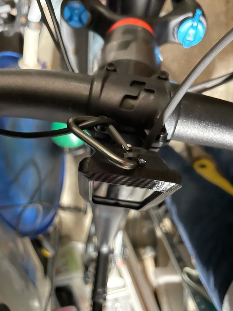

Mine is mounted on top of the headset and I knocked it off twice on my first ride. So I bought a little bumper on eBay with a little loop at the top. Now I have a little carabiner from the bumper to one of the cables so if it comes off it stays connected to the bike.
I’ll take a picture at some point to show what I mean.

This is what I mean, although I can see a screw would also work well.

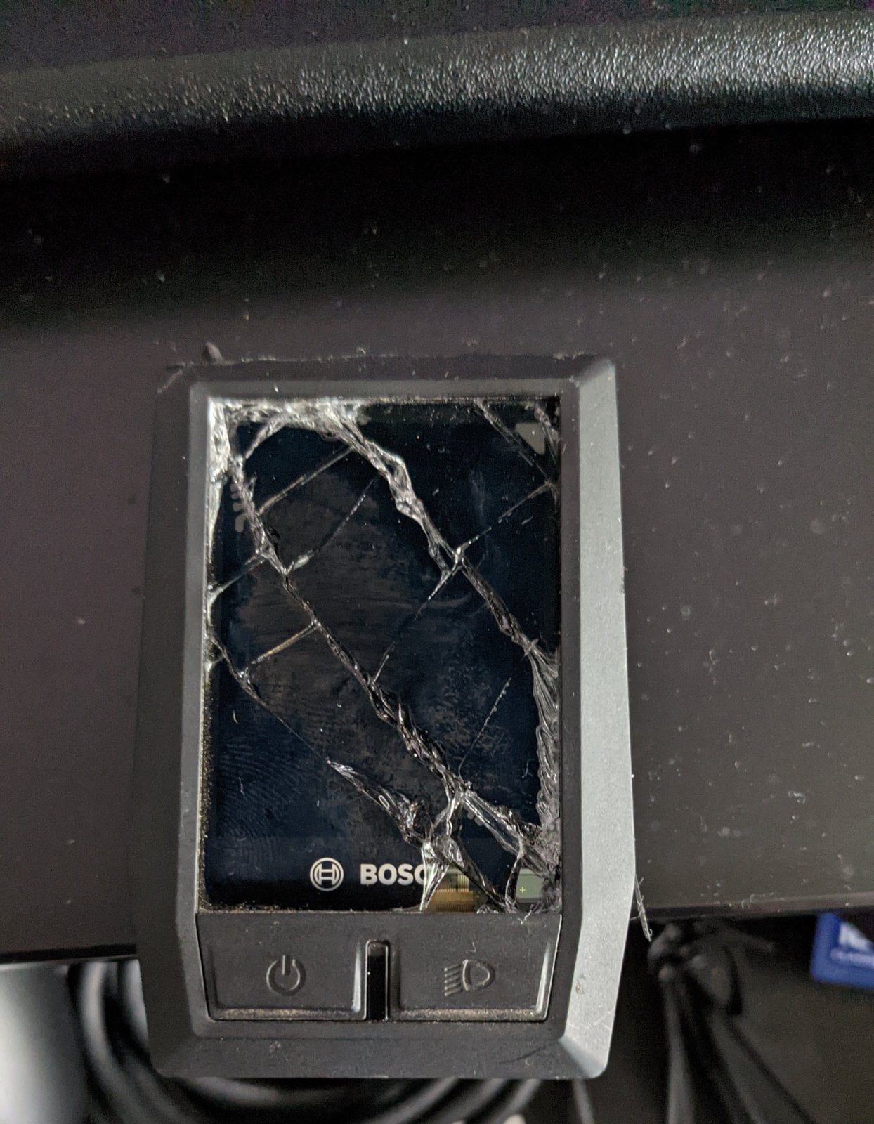

You need to be a bit careful with the kiox to ensure that no water gets in the USB port, ie make sure that the crappy rubber cover is properly closed all the time.
I have taped my cover shut, and I remove the kiox from the bike when washing, because I broke one kiox by getting moisture in it.

Thanks for the tip, I'm going to attach a lanyard. Only had my Cube 160 with kiox display for a month and I've already had it pop of twice. (light falls, nothing serious) Fortunately the display is still sound. The magnet is strong until its not. I prefer the lanyard idea to screw as I think if it pops off it's less likely to break.
