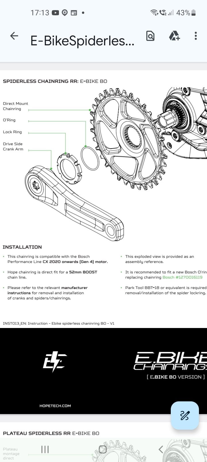

I have recently replaced the chainring on my Trek Rail and noted that there was no rubber O ring fitted between the lock ring nut and the chain ring. I believe there is supposed to be one. The chain ring was a SRAM type, which I have replaced with a KMC. I just refitted the nut and torqued it up. Does anyone know of the O ring is required or optional? I note that E-Thirteen recommends not fitting one at all.

Sometimes, rather than a rubber “o” ring there is a brass one. I believe that this behaves like a spacer when used with the thin plastic “o” ring.
When I installed the ethirteen chainring I only needed the thin plastic “O” ring. Also, the castle nut, or retaining nut, can become stretched, deformed or damaged during removal and replacement. Some say that a small amount of blue Lo-tight is helpful to prevent loosening of the chainring. That may not be necessary if a new nut is used.
