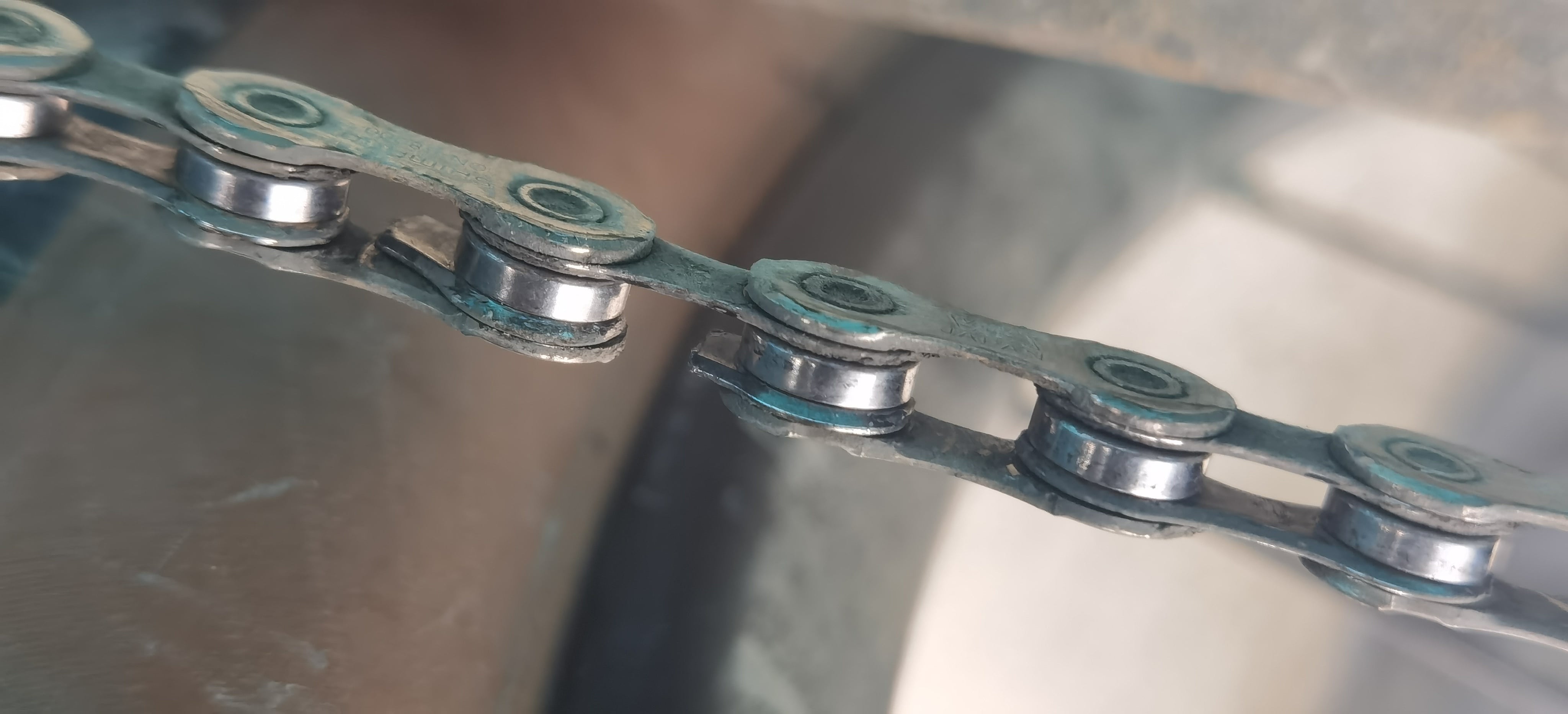

If you’ve developed some chain-suck your consumables are starting to fail. 1700km+ seems about the time to start charging these worn out parts. Servicing, grit and use plays a factor in the life of these components. Like it was said here, isolate the motor by removing the chain and check for noise, movement, bearing slack etc. 43F15B00-390A-4E6F-A1C0-D0BC2F5B6275.jpeg 84D6C5BF-5E97-4038-ADAC-3ACB75AFE91A.jpeg
