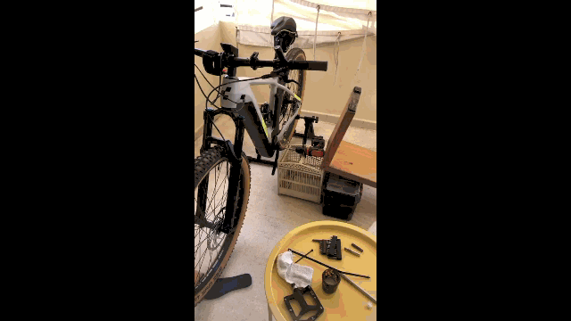

thought i give my update for anybody in the future that has the same problem.
so this morning i fully charged my drill battery and have it a go, 45 min - 9km/h pretty steady on eco mode.
and Thank God the error is gone, what a relieve.
i was already thinking of shipping the motor only for an update, along those lines.
so yeah super excited.
went for a easy (fear) ride, all went well.
thanks to all you guys and the responses, hopefully in the near future bosch would have a system in play where we can update our own engine.
cheers!
