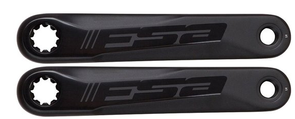

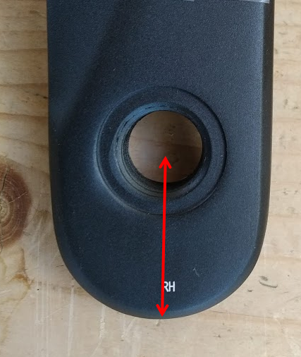

I had ordered FSA CK745, the 165 mm after bending left side.
they looked nice and stong, but...
the advantage of 165mm crank arms is having more clearance when (mountain-) biking in rocky/rooty terrain.
the holes for the pedals are at 165mm, but the length of the crank arm itself is the same as 175 mm. this is not so on the picture on the website:
this part is too long to use on a E-mtb:
this saves them to make 3 molds for the base part, but it is missing the point for MTB if you ask me.
i send them back and ordered cube acid e-crank 165mm (same as the ones that came original
