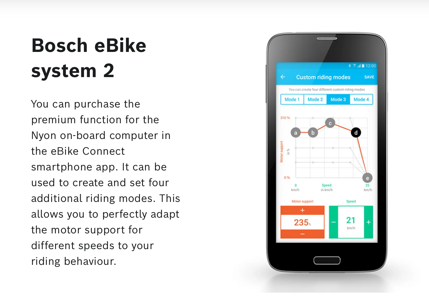

But you can upgrade the display to a Nyon 2 from the Purion. With the Nyon you can buy „individual modes“ as a software upgrade for about 5 Euros one time fee. With that you can define four additional modes to your liking and then change between standard modes and individual modes any time you like. The possible modifications are limited but give you the ability to set the desired support factor at 4 speed points between zero and 25 kph.

From the Bosch website.
Individual riding modes:
Nyon 2:
