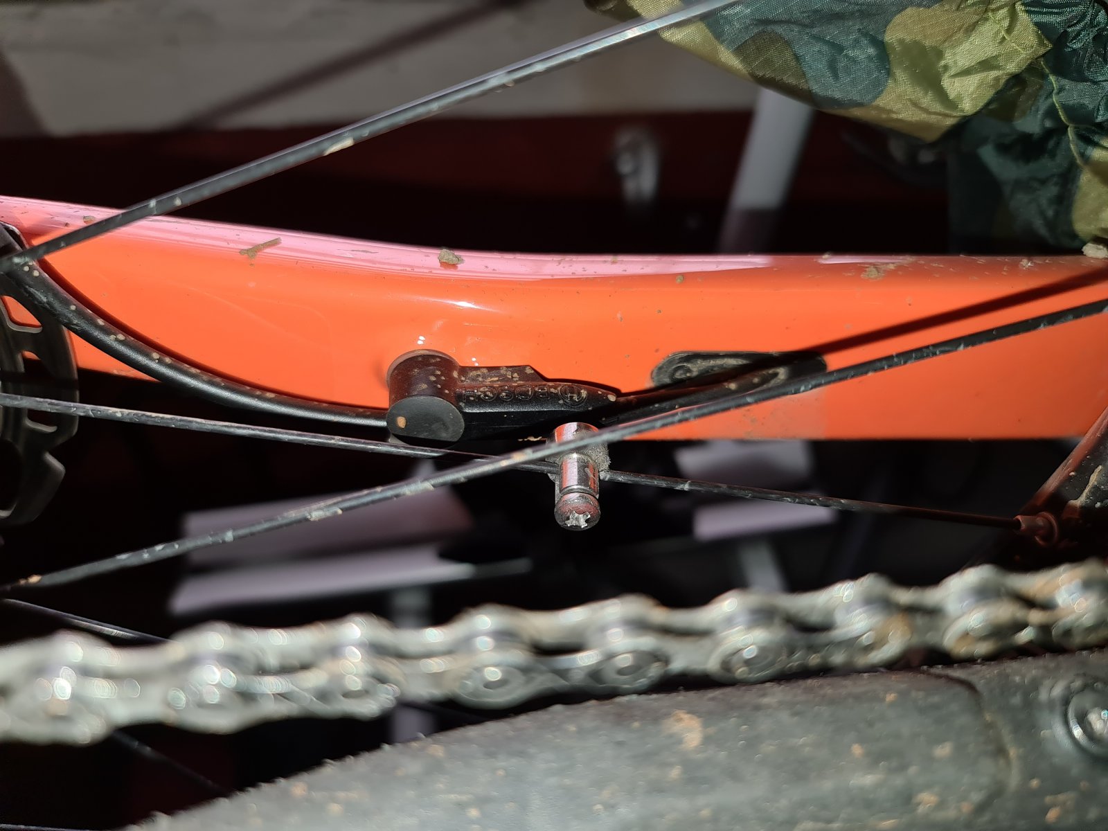

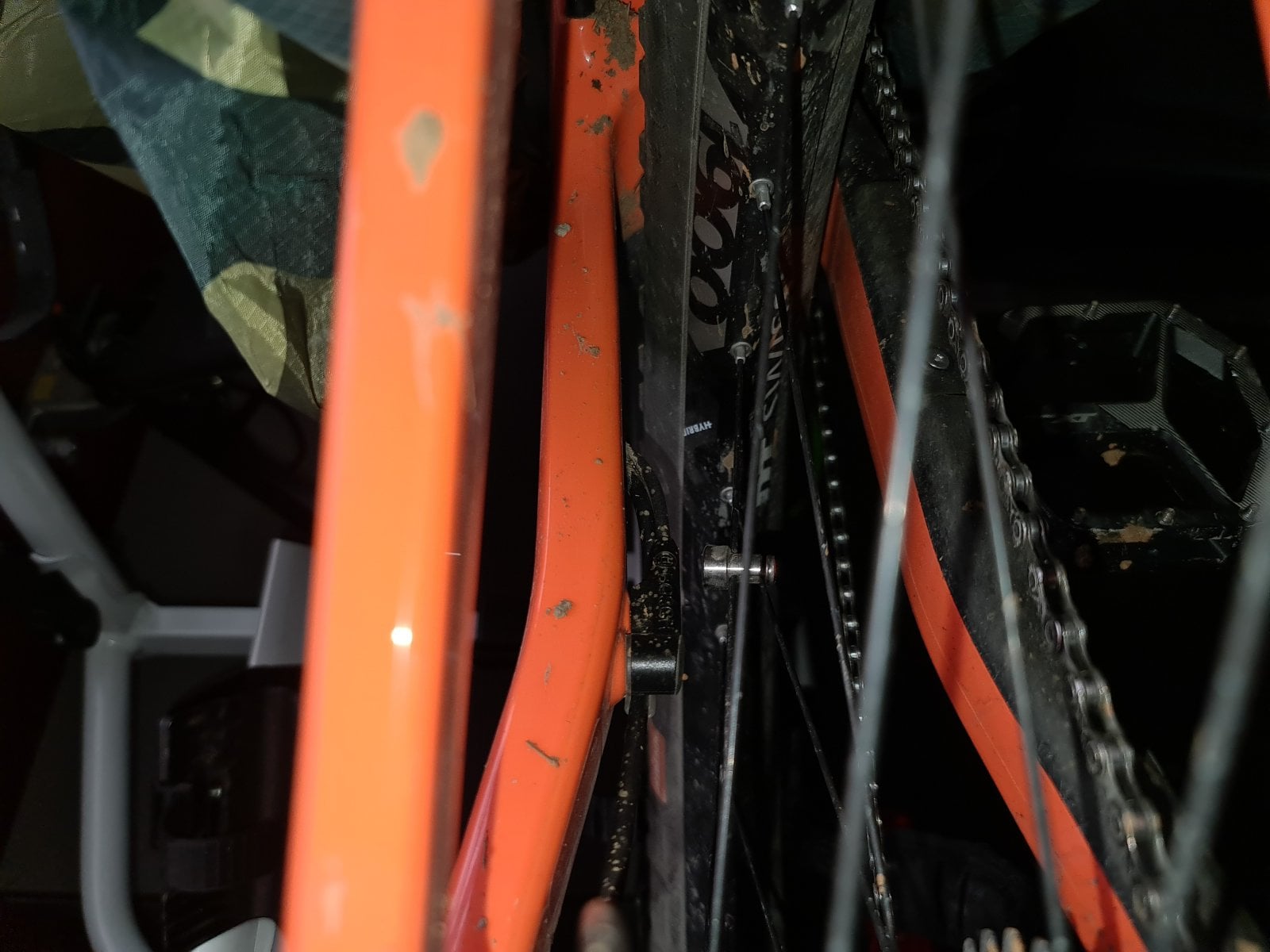

This is how my magnet is positioned. I see it perfectly in line with the sensor. Now I am a bit puzzled because if the failure does not come from there I do not know where it could be, and I am afraid of taking it to the store. I think they will begin to disassemble and do tests without having any idea where the failure comes from ...
EebStrider
Apr 18, 2020
712
763
Surrey, UK
Have you taken the cover off the motor, and cleaned out any dirt or water that may be in there? Mine fills with mud and sludge regularly, so once a week I take the sump guard off and clean it all out. It’s a pretty crap design tbh, considering these bikes are made to go off road all the time.
