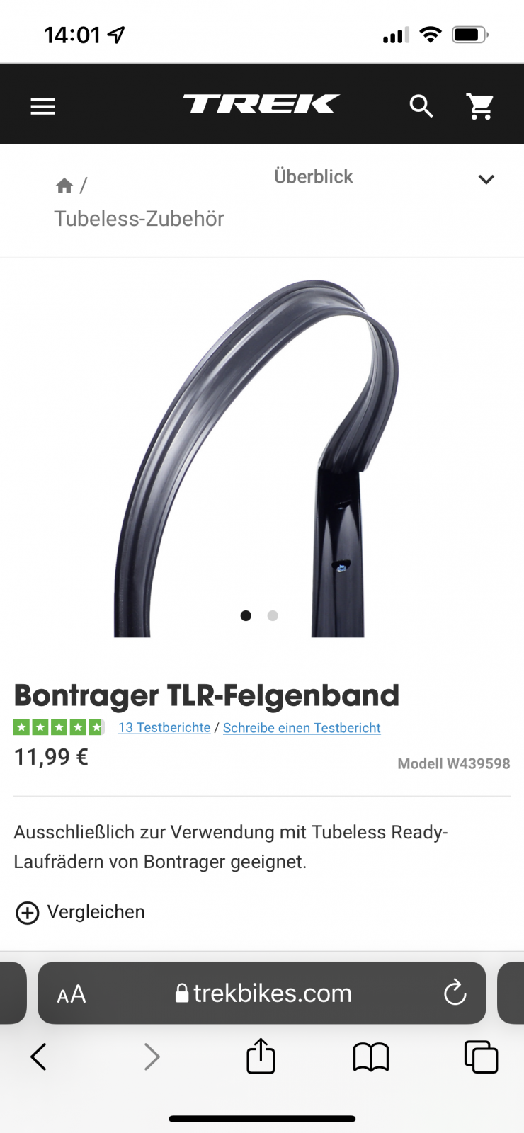

You're right Doug. The plastic rim strip actually forms a step that you have force the bead over. I was reluctant to remove it as it's a very neat rim / valve seal for going tubeless but you're probably right to say removing it is the only solution. Thanks.

Hello, are you talking about this? View attachment 81041
Another question for me is: Does it make sense to go with 2.4 tyres insteas of 2.6? Or a combination of both? For AM and light enduro biking? Or does this has more disadvantages?
Yes. I didn't realise they cost so much. Someone going through my rubbish bin could have made some money.
