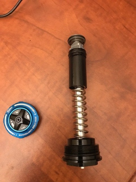

Yep good question. Maybe a picture will help - the top has broken. Yes, I can get new parts - but those will also take a while. I've booked two weeks off from work after Easter to go riding. I upgraded the brakes, wheels and rear shock - but of course it's the fork that has to break... and I want to be riding again asap - hence the ask on the Fox 38. I'd get a new fork to be up and running again, and then when the warranty replacement came in I'd sell that.
I have asked YT about the Fox 38, but didn't think it would hurt to ask on here as well.

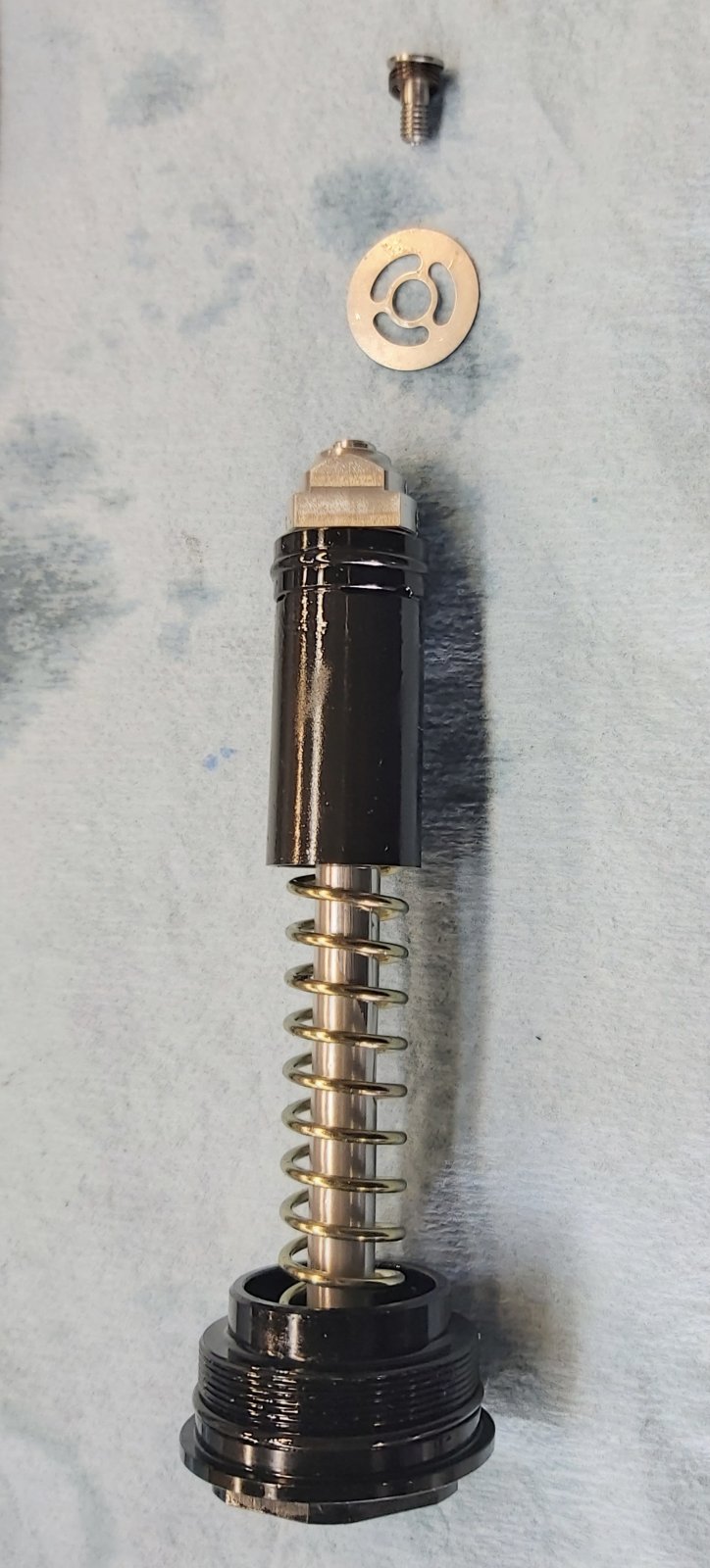

The first picture is the inside of my fork. The second is how it should look.

So just the compression damper assembly then?
If you can't get hold of one anywhere...
Unless you're loaded I'd just get a 170mm Yari - it'll be massively cheaper. Easier to get hold of. Will do the job fine and you'll lose way less on the re-sale.
and no you don't need anything Emtb specific

Hope you get it sorted dude. I just blew my shock and paid to get it fixed as warranty was going to take too long. I even tried to buy an upgraded coil shock but there was no stock in the size I needed.
It looks like the screw holding the valve and shim together came out, interesting failure.
