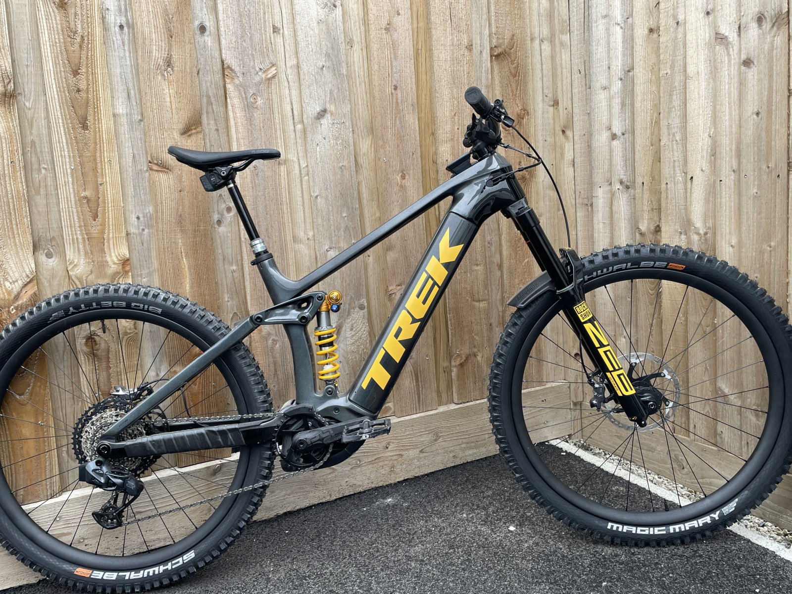

Rail (750Wh) Bling innit….

150. It’s OK, could ideally use a 170 but it’s what came with the bike.

👍🏻. I was able to fit the 170mm reverb into my medium Rail (just), but It sure cleans-up the cockpit. I’ve got the Lyric 170mm forks on mine …but I think that’s all I need (for now). Very nice looking ride.👍🏻
Btw…your brake levers are backwards 😉.

She looks beautiful! What rims are those?
Bontrager Pro Line Carbon. the most user unfriendly rims I have ever had. I cannot get tires on them. I have to do the walk of shame to the bike shop. The middle channel in the rim is very shallow, no matter how hard I try, I cannot get the tire on. I would need 4 hands.....
