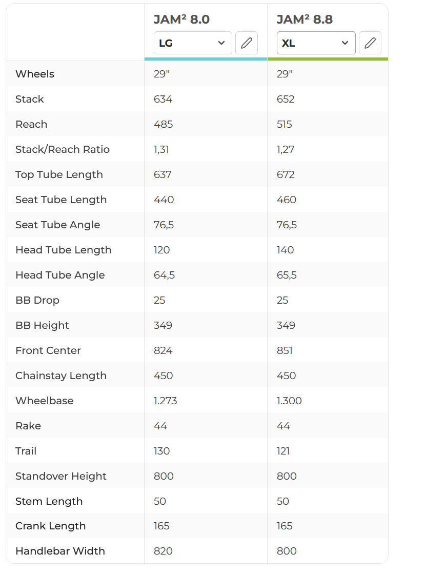

Well he's ridden only trail and road bikes, and we have a simple trail decathlon bike at home on rol that he uses for simple workouts and I don't think it fits him well, and doesn seem to be too comfortable there and has some lombar back and shoulder pain if seated for too long. Mine is an S as I'm 160 cm, not much really a point to sit him. So I don't have a strong starting point. He's strong built, wide shoulders, a former rugby player, I would say normal proportion.
I know if I have a good confortable bike he will ride it, but if I tell him my plans I'll try to persuade me not to do it, it's expensive..... he's not sure he's going yo be able to ride it, etc. ....So having him sitting bikes won't be possible.
So looking at this recommendations I'm checking out this FOCUS models they have good price components, there is a pricier model one (JAM2 8.0) with a Fox Factory Float 36/Fox Float X Performance, would this be better and worth the upgrade? it's about 500€ more. Put their geometry in a pic side by side from L to XL as frames are the same
Again thank you for your help!

what do you want to know more about that Focus ?
Well quality of the FOCUS bikes and general Brand impressions. Of the models themselves the 8.8 or even the 8.0 if they are considerable comfortable or too stiff, and ideally some idea with sizing, if they in general ride small or big. Focus website puts him on top of L and button of XL, and says Xl for more comfort.

If Focus L vs XL, given this has to be a surprise for him I think the best you can probably do is ask the advice of the LBS with both sizes available.
Although not directly relevant, I sit exactly mid way between M and L. My old Trek Fuel EX M/L was a perfect size for me (5'10"/178cm) so for my Trek Rail I had to choose between M and L. M was too small (the size my 5'7"/170cm wife has) so I bought L then adjusted stem length/bar height&sweep&width/saddle etc. to get the fit I'm comfortable with.
Too small is impossible to make 'larger' but too large can be made 'smaller' IYSWIM. Good luck.

Yes, that's the problem, your husband is in a middle between L and XL, for comfort and more straight position (with handlebar higher) I'd say XL (stack 18mm higher + spacers 3-4cm spacers under a stem and handlebar rotated a bit back).
Higher model has better suspension, but you can feel improvement only when riding hard, not on easy rides or touring.
