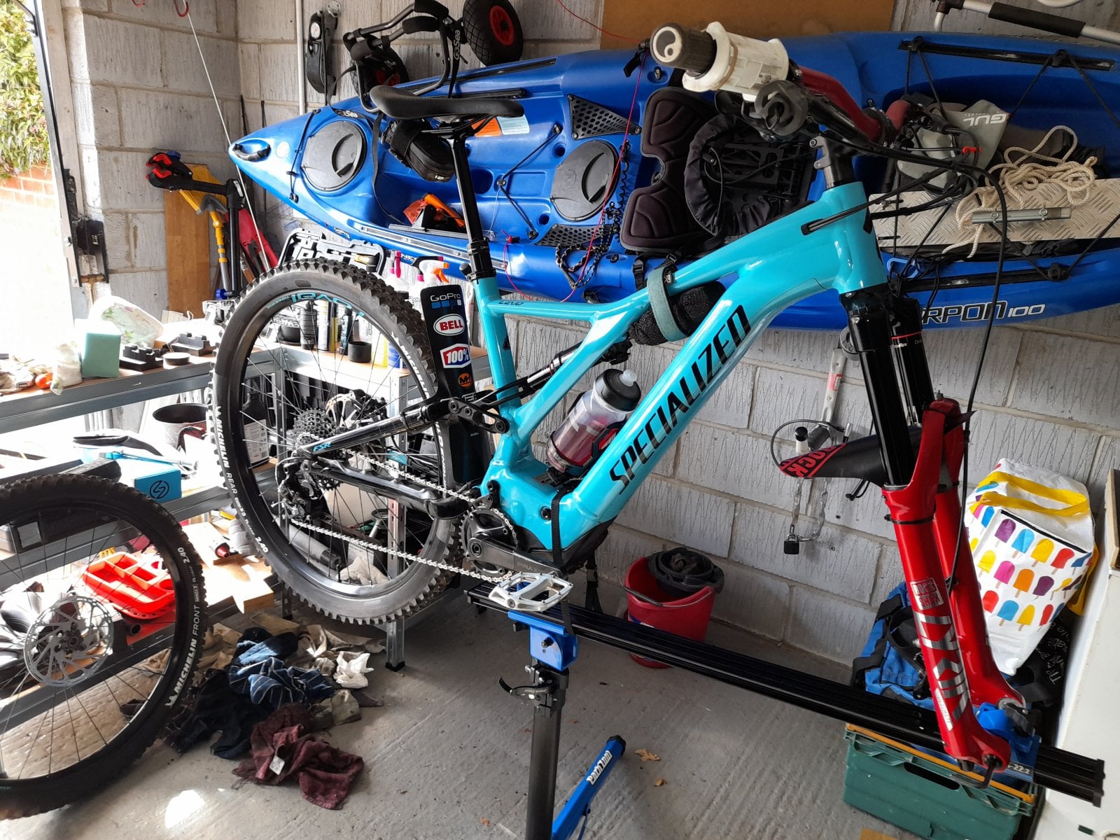

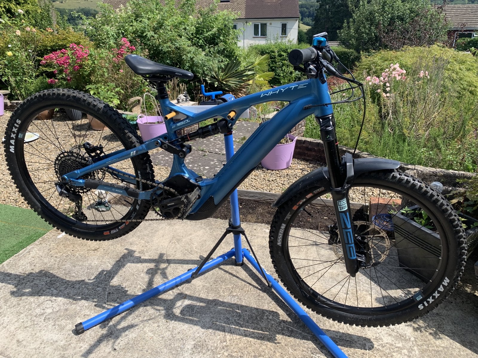

I use one of these...Park Tool.
You can secure the fork in the clamp with the bike still on the floor then lift/lever the rest of the bike up and onto the BB rest ( for an EMTB it sits on the bottom of the motor)......no strain on the back. Whilst the Levo ( pictured) is possible to mount on a standard bike stand using the back end of the top tube, it is not possible on my Whyte E 180 RS of my wife's Cube Access......hence why I bought this type of stand.
Mounted as per the photo the only part of the bike you cannot service is the headset but the bike can be mounted with the rear wheel through axle in the clamp ( ie the other way around) if you needed to do that.
One thing I find really useful with this stand given the limited space I have in my garage, is that you can rotate the stand and therefore work on both sides of the bike without moving.
I bought the rail extender at the same time to ensure the rail was long enough for my Whyte but it is not needed for the Levo or Cube Access.
The only modification I made to the stand was to fit a rubber block between the "prongs" of the BB support.
It may be an option for you.........Park tools so not cheap!!

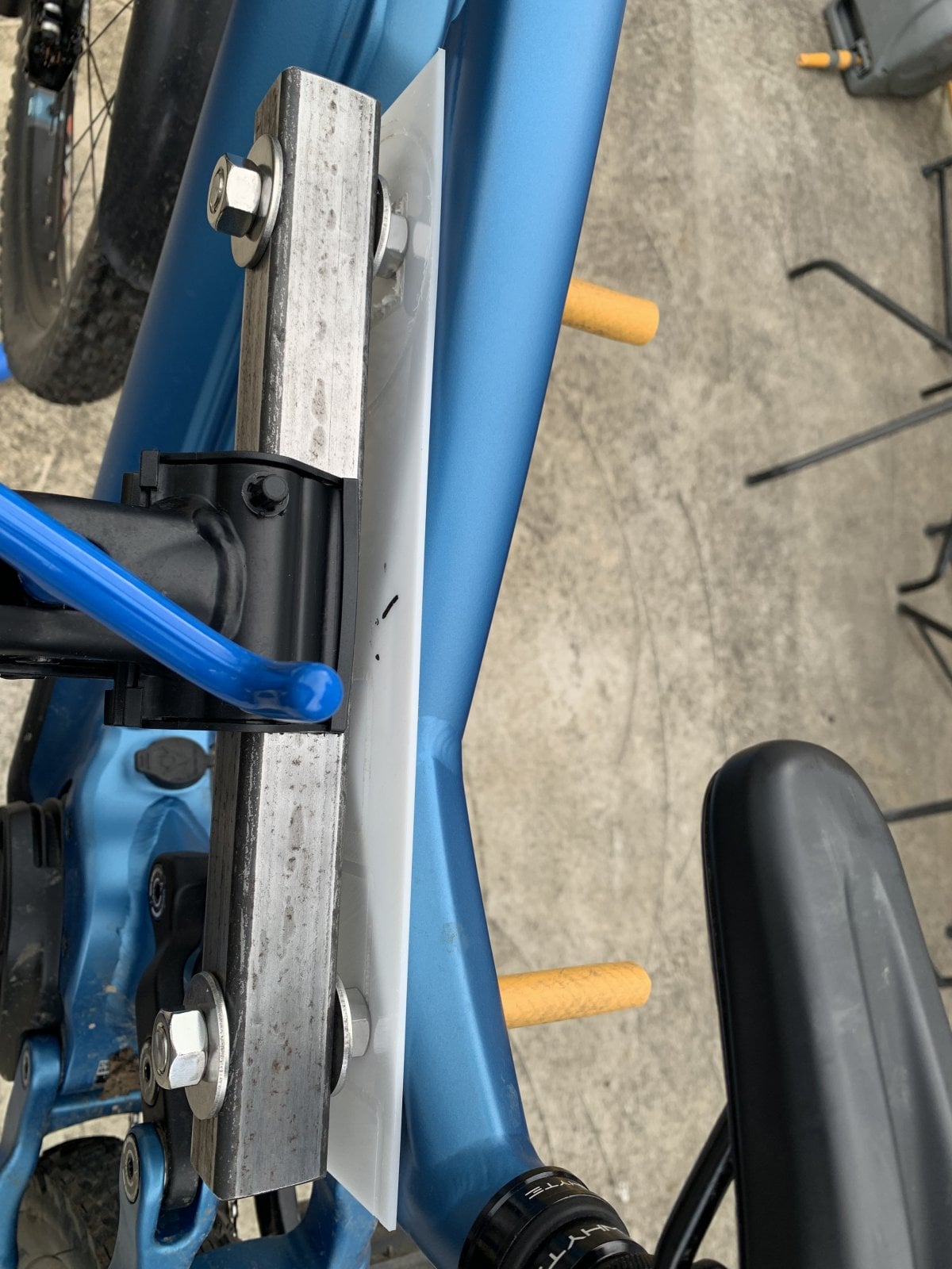

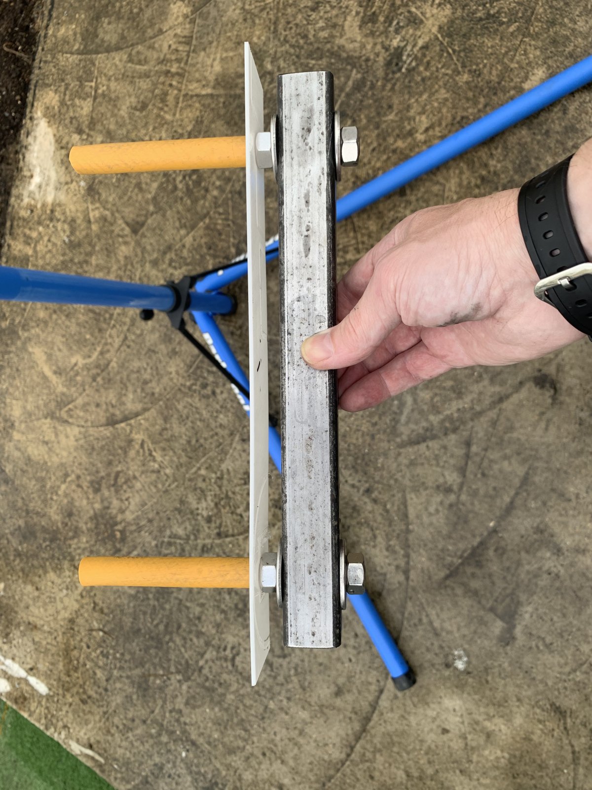

Where is the best place to attach the work-stand clamp on an E-bike? If you have enough space on the stem, 3 cms or so, then this homemade false crossbar will take the weight. At 25 mms diameter, it is quite strong enough to support my 25 kgs Cannondale, although you should check your clamp will close securely, otherwise it may need to be packed-out first with a layer of insulation padding, or something similar, to ensure that it's held tight. Chrome tubing & pipe clips, available from Screwfix.
That one is very nice and looks absolutely ideal for our heavy ebikes, but £330 is really expensive. Possibly a bit overpriced for what it is.
Lifeline do a similar stand for £90- I couldnt say though ifit is as strong, in truth it looks a bit flimsy, and i cant find any YT vids showing it in use with an ebike.
Mikerb
May 16, 2019
6,551
5,041
Weymouth
May be worth a try. To be honest they do not really need to be that strong because the BB/motor sits right over the main upright nd that is where most of the weight is. One thing to check is the maximum distance between the fork mount and the position where the BB/motor casing sits. On the Park Tool I have to also buy the small platform extender piece to mount my Whyte E 180 although that bike admittedly has a pretty long front centre. Another aspect to check is the BB mount. The Park tool one is designed for a normal bike BB. I used a solid rubber block wedged between the 2 "spikes" that form the BB mount so that it became a flat surface....a block of wood cut to size would do the same job. As I mentioned a bove the 2 aspecs I really like a bout the latform type design is that the bike is far more stable than on a clamp type stand and the bike can be rotated 360 degrees.
