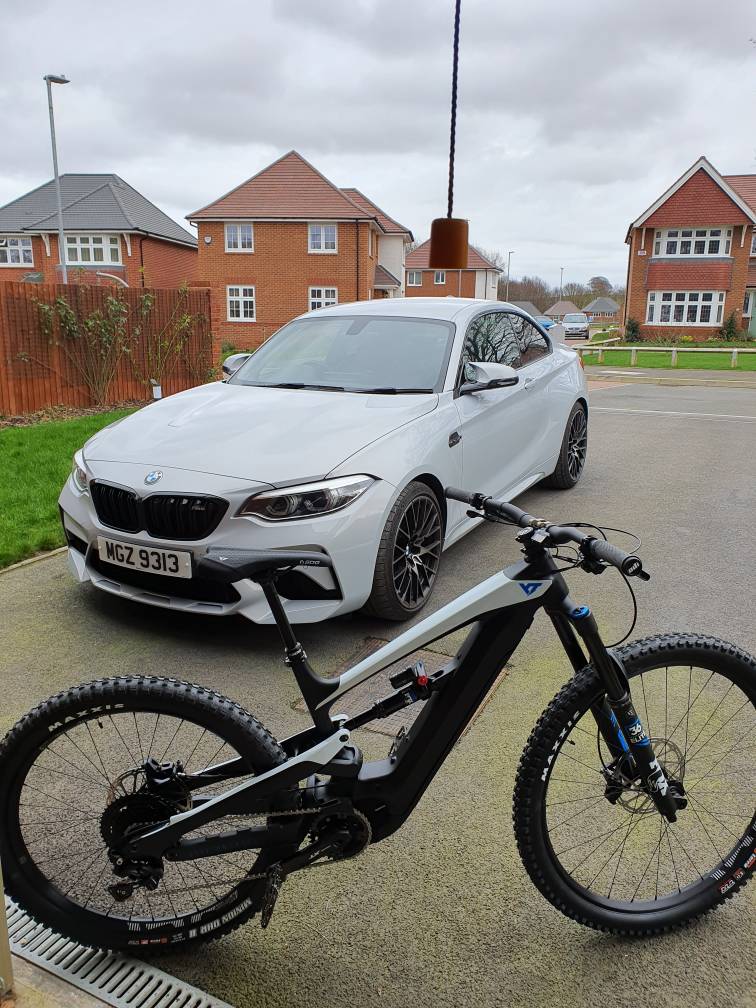

Hi.
Got a few questions.
Wtf is the plastic thing behind the cassette? Can it be removed?
Also why did they install the brakes backwards and do I need to change the cables or just switch over?
Thanks

1 it's called a dork disc and yes you can.
2 the brakes are all fitted that way in Europe. Some can be flipped others need the hose swapping.
3 should have gotten a bike from a shop if your this green with bikes direct brands are a bad idea.

The bike is up and running. Turns out that when the battery is low you cannot get the app to work. So I'm stuck in low power mode for now
Removing that dork disk was a PITA. I cannot find my tool to remove the cassette since I moved house. I have never seen a high end bike come with one before.
I just scored it with a utility knife and broke it off, easy as pie.

You can take cassette off by loosening axle clamp on disc side and pull cassette with axle out i had to do this to grease the hub as their was strange popping coming from it. Noise went after some grease as some stated on an other thread. When apart you can take the dork disc off.

Also, the cassette can be removed without removing the axle. You just need a chain whip and cassette tool.

The dork disc can be removed without taking off the cassette using a set of snips and a little common sense!
Yes that is what I did. Painful on my fingers though.
