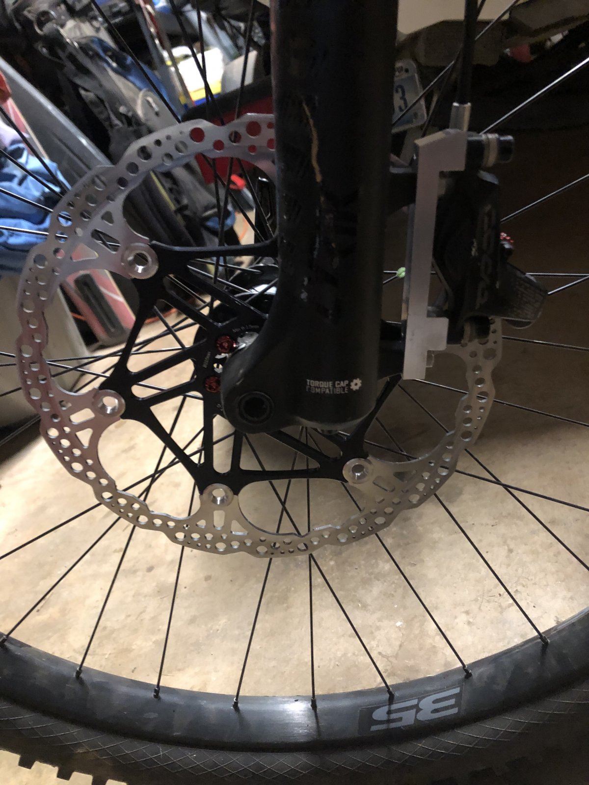

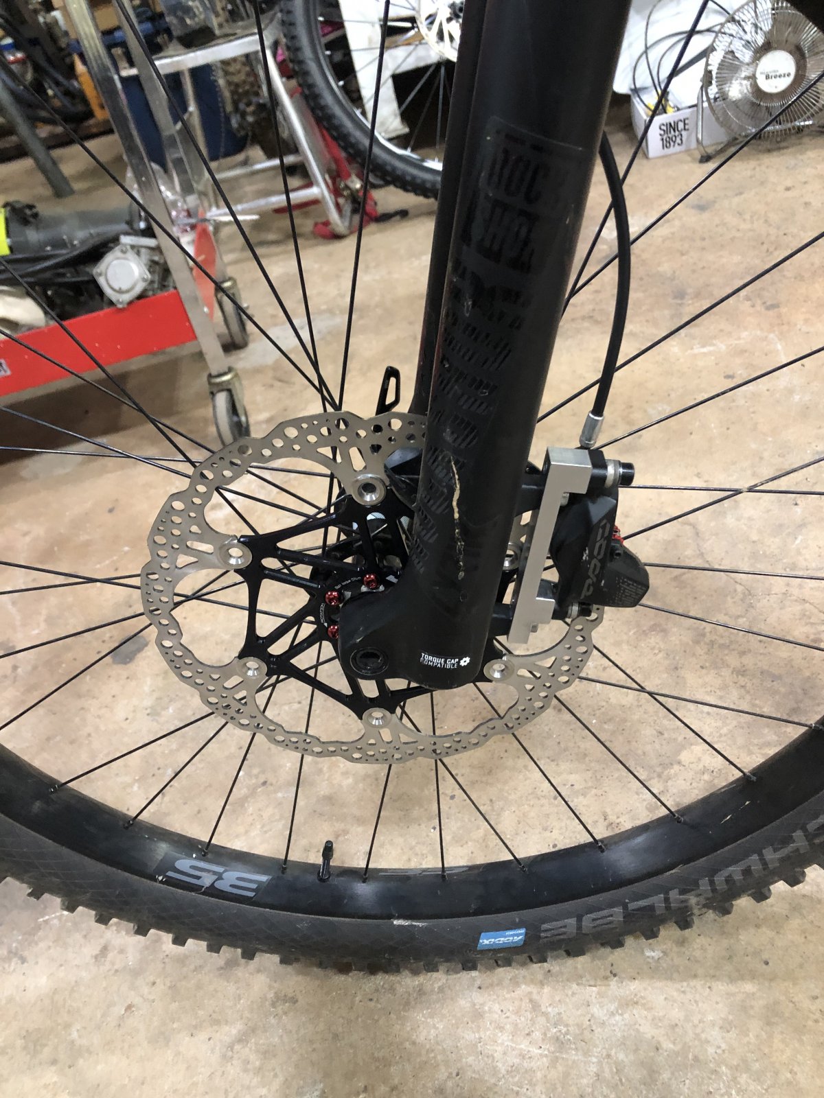

Been trying to get these Code R brakes to work for a decent long downhill and without fading and squealing like a dying pig.
I have trick stuff pads, and tried about every pad exp the new carbon metallic braking pads as there impossible to find in the states.
So made a bracket and slapped the Hope 225mm rotor up from give it a go tomorrow see how it rolls, or should i say slows the roll!!
Wasn’t able to find a stand-off bracket so put my mill to work.
Why buy one when you can make one for 5 times the cost. Lol
2hrs 16 min to machine that hanger.

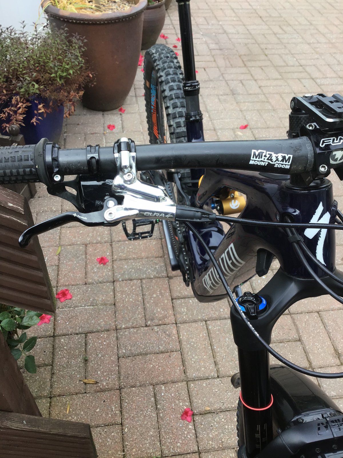

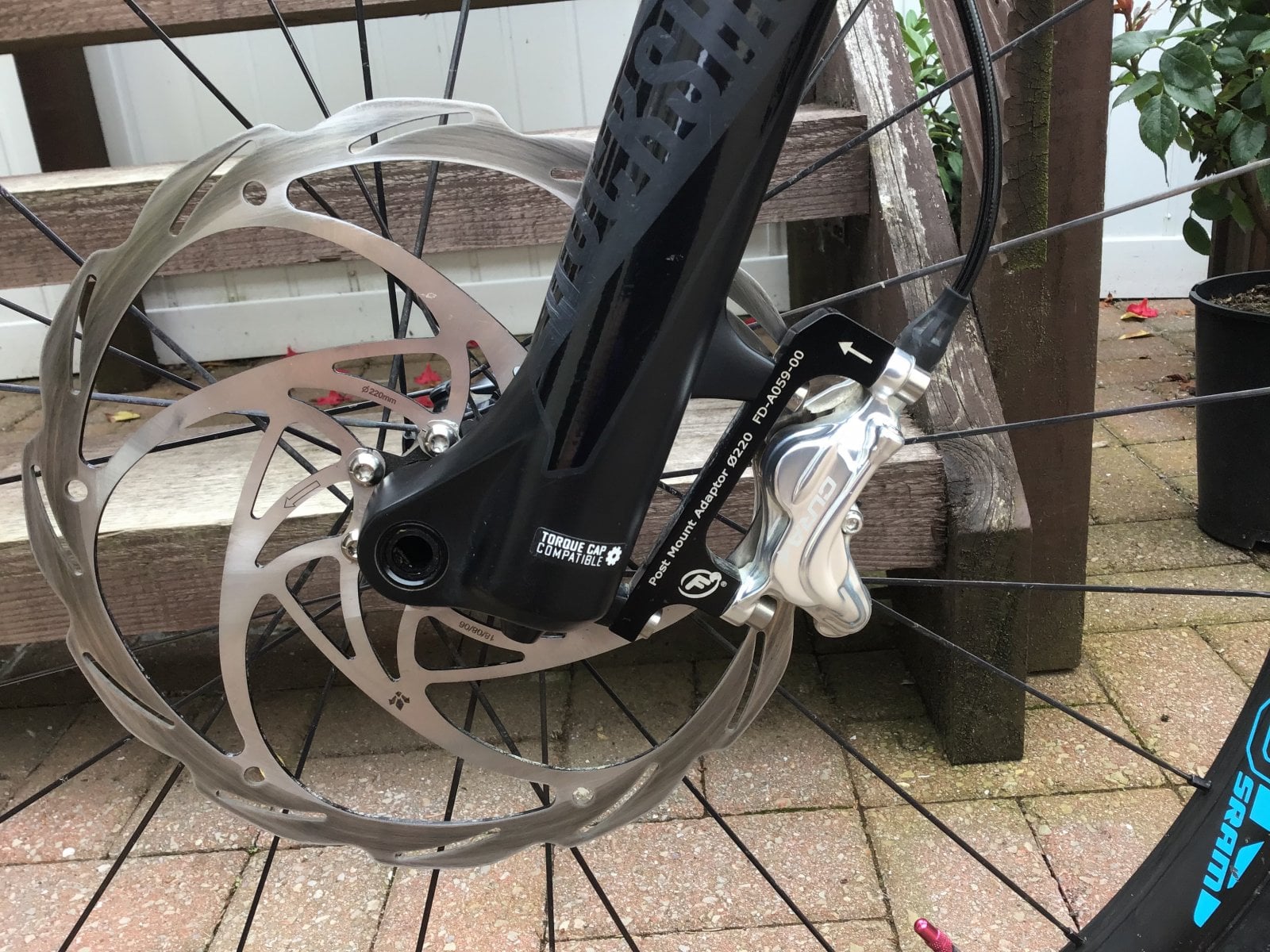

I am running the recently new mineral oil Formula Cura 4 pots with sintered pads on the front of my 2019 Levo with the new Formula 220mm rotor and 160-220 adaptor. Been very happy with the power and modulation over the last 6 months of use. It has taken my one finger braking to a completely new eye popping level :eek:
I used to be a real big Formula fan a number of years ago (R1’s, T1’s and the super powerful RO’s) but they all used to seep fluid and destroy my bar and frame paint work and they could be a bit tideous to set up without the rotors dragging on the pads :(. Now they have gone down the mineral oil route and they have a much bigger pad/rotor clearance it is back to happy happy Formula brake days again!
I managed to get the brake, 220 rotor and 220 adaptor from the same seller (Lordgun) but see they are now out of stock re the rotor as I suppose everyone is going down this bigger rotor route now ;).

That 225 with trick stuff pads makes saint brakes look weak!!
But still has the code feel
I did 32 miles today and 9 long 3 mile steep DH RUNS with heavy braking 180 switch backs from high speed and usually by the third switch back i can’t let the bike run out in straight as i don’t have enough brake left with 3 fingers pulling.
My rear rotor isn’t blue, and my brakes only had a little squeaking after they cooled at the bottom but cleared up in a few miles of trail.
