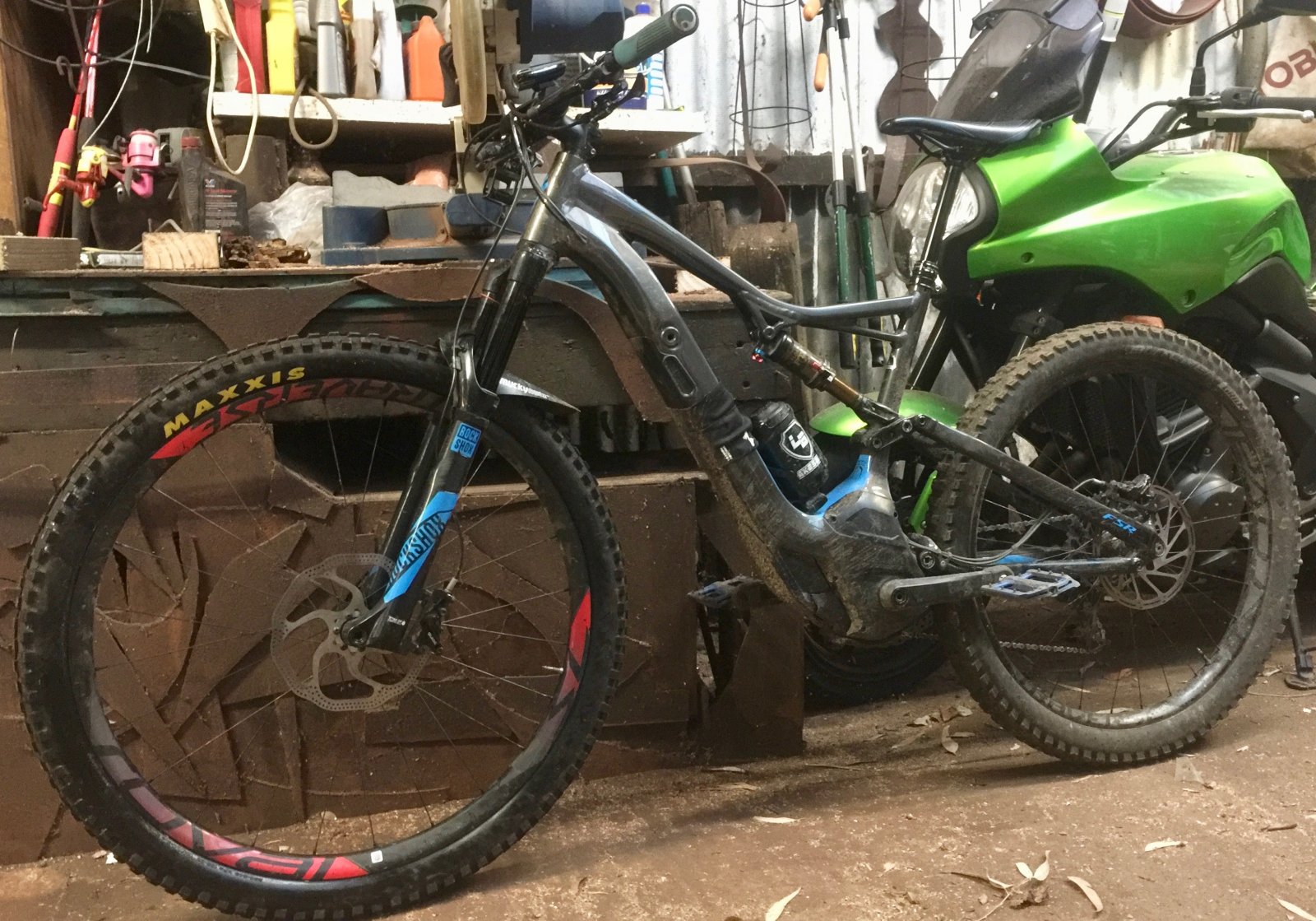

Off and on for the past year or so I’ve been riding my Levo with a 29er front end, 2.5 DHF, love it on my acoustic Trance so though id give it a whirl and it worked a treat .
Recently added a pike airshaft in my 2016 levo to increase to 150mm.
Rode with the original wheel then a few days ago put on the 29er front and it felt terrible, wide on corners and flopping over on uphill corners.
Same thing happed a few years ago when i tried 150mm fork on the Trance, seems to only work for me on 140mm .
Might try lowering the handlebars.
So just after any feedback/ideas from those who are using a 29er front end these days, what length forks, handlebars slammed etc.
The Levo image is over a year old
Cheers
