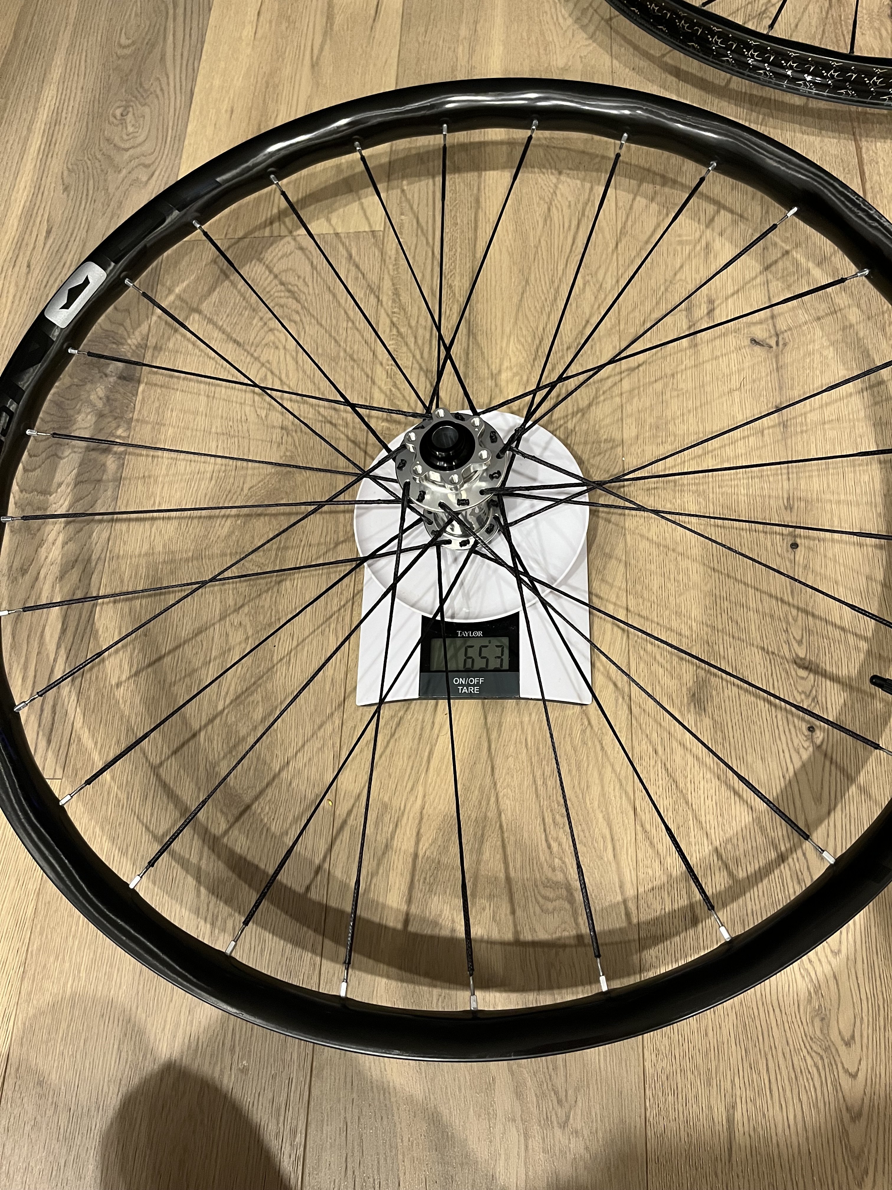

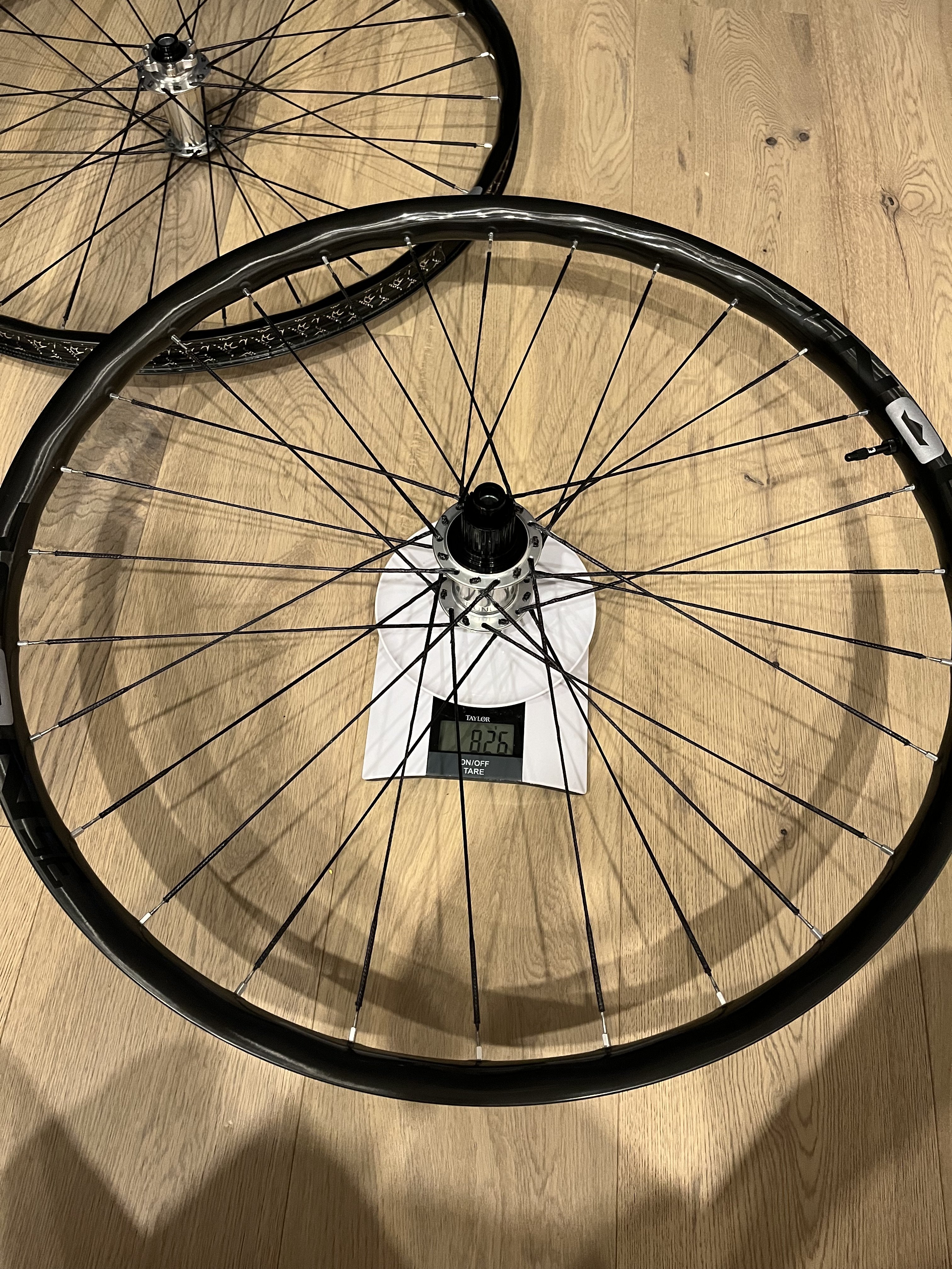

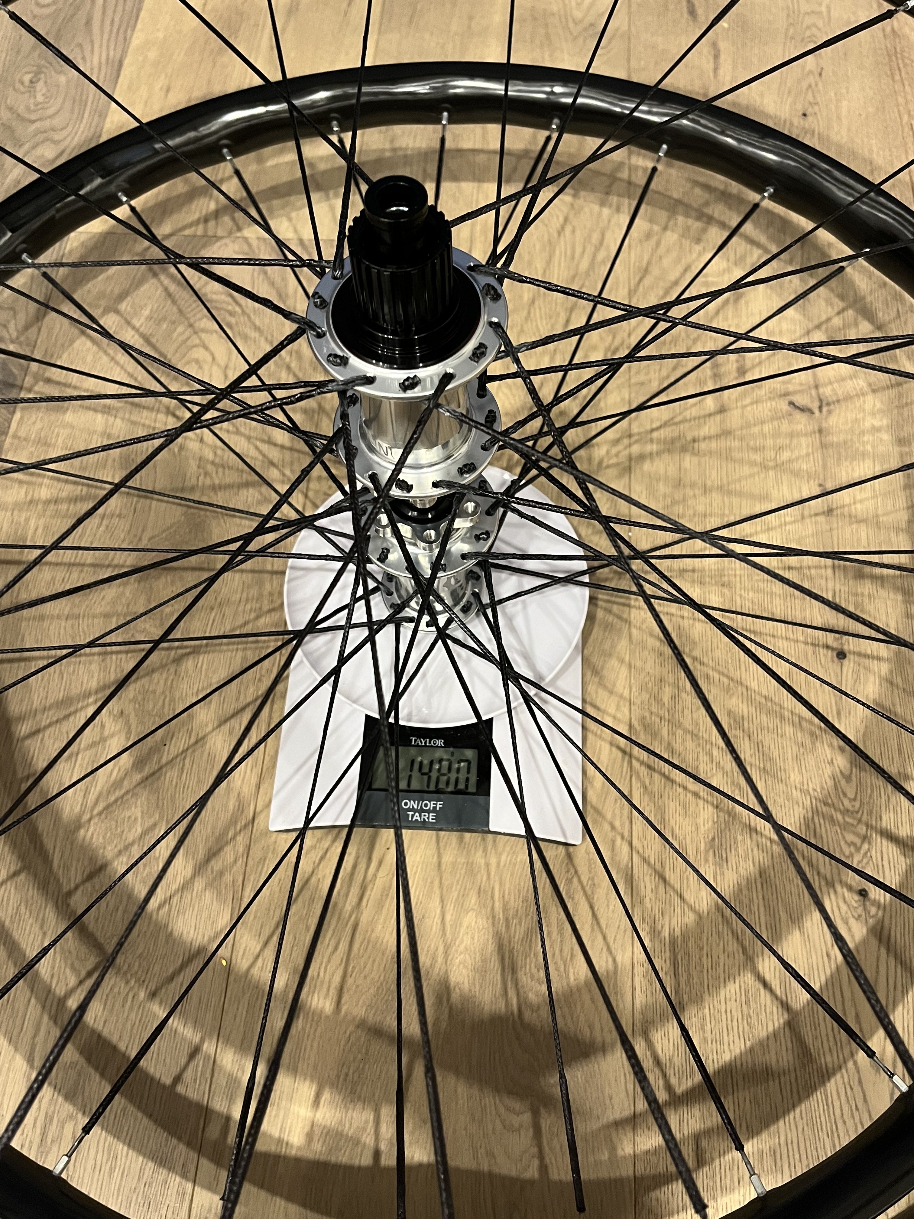

Nobl TR35 + Berd Spokes + i9 Hydra.

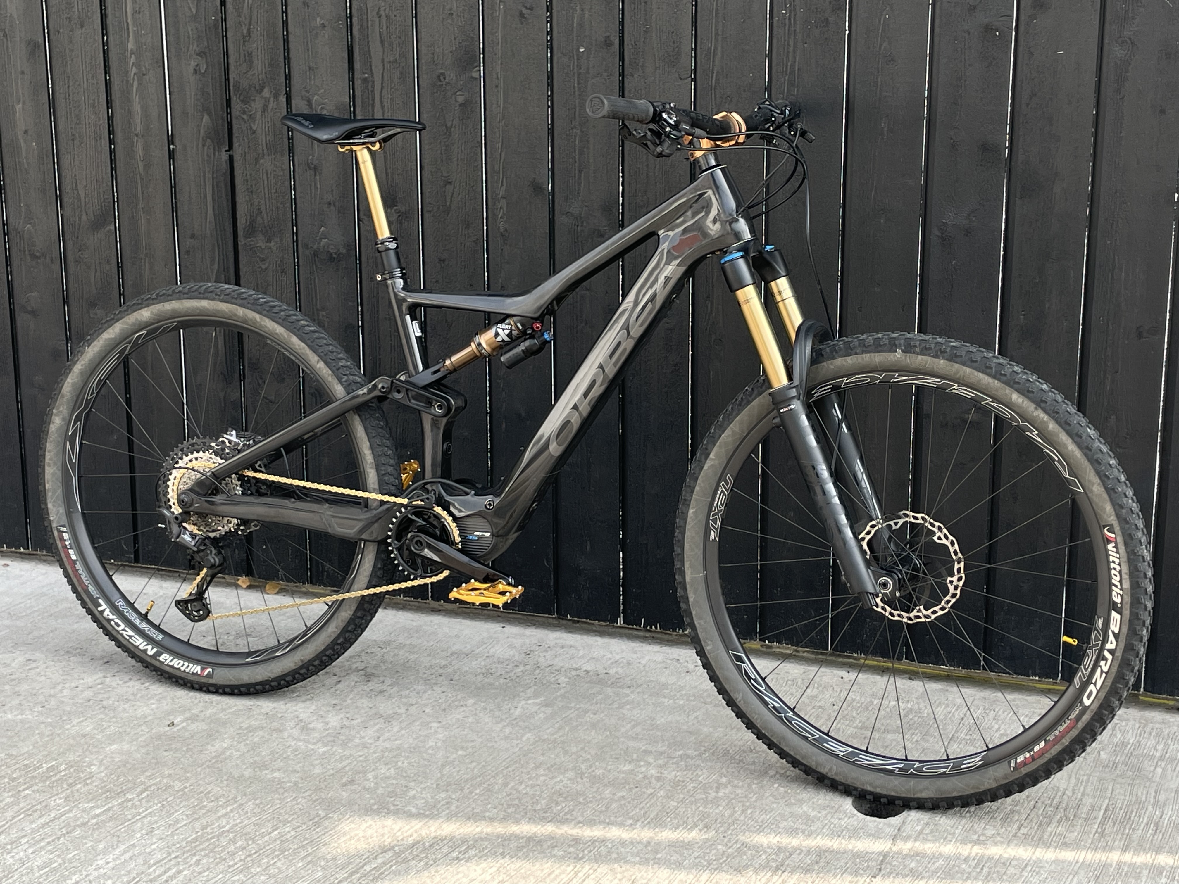

Ordered Raceface NEXT SL wheelset 1555 grams, from Orbeas homepage today. Brake disc included. 759 EUR!
Fitted the new wheels from Orbea. Hope snow will disappear so I can try them out on quite narly trails. Bike 17.8 kg now. (M10)
If money was not an issue I would love Roval Control SL, 1240 grams.
