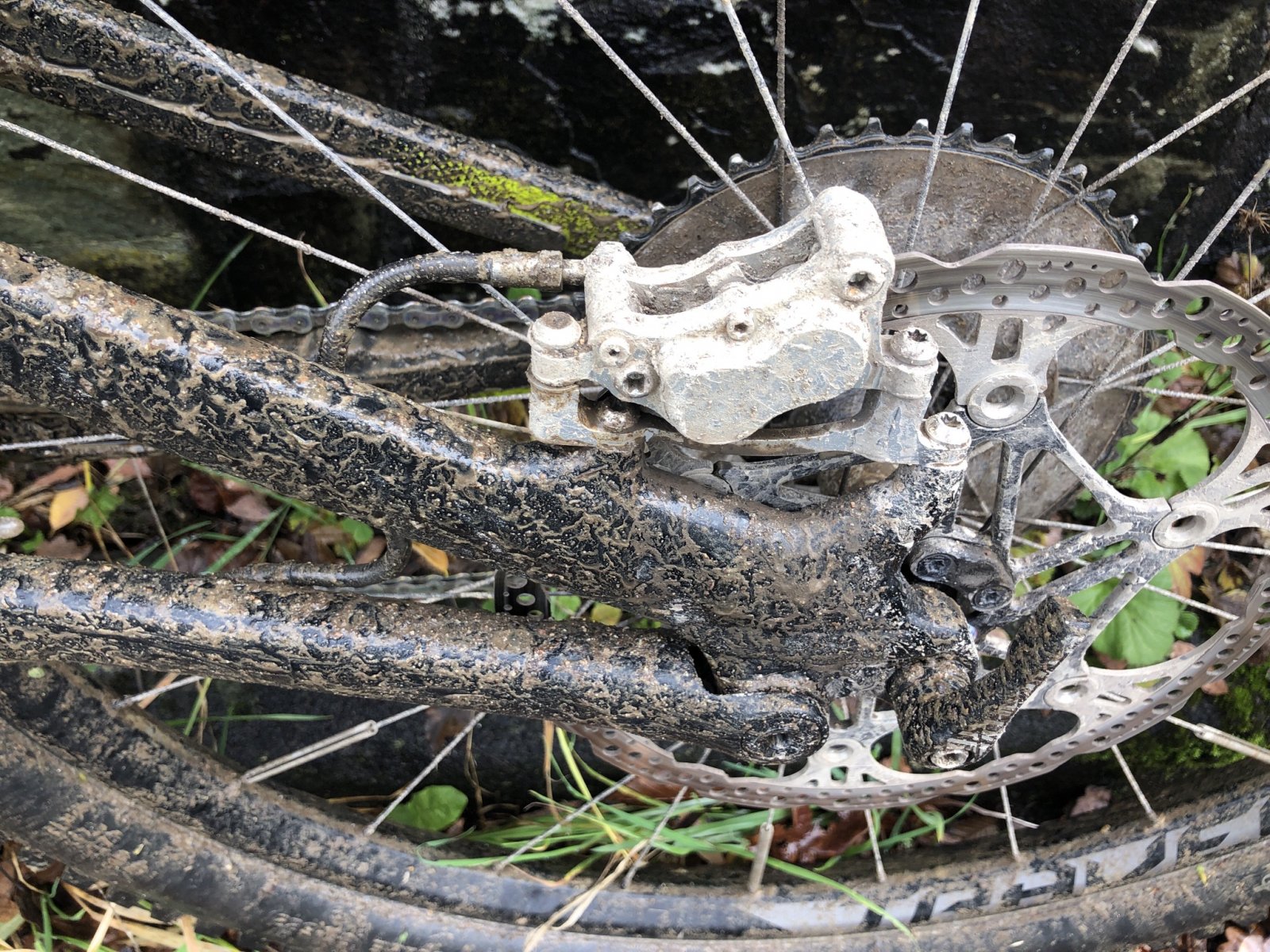

Haibike FullFatSix; MT5 calipers F & R with 203 Magura rotors. For pads I use a combination of EBC MT7 resin and metallic (green & gold) pads, ie 2 of each in each caliper. You'll need to buy 4 pad bolts as well.
This combo seems to work in all conditions ??
