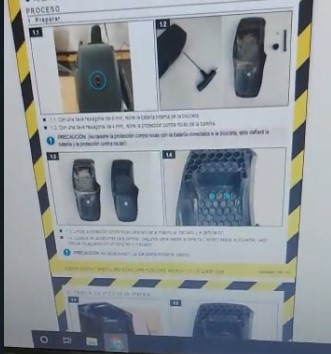

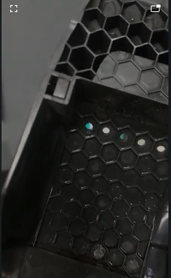

so, have you received a message from your LBS to come and bring your levo battery to perform an "upgrade"?
they need to drill a few holes to the rock guard because mud, and water where acumulating in there and in some cases messing with the connections.
I will check if I have something in there, I live in a very dry place, and it is unlikely that I have mud or water in there. maybe clean the dust and nothing more.

Even in a dry climate I get a lot of crap in there. But, in wet riding those tiny little holes aren't going to do a damn thing for mud build up.

I use a peace of tape to prevent water and sand going between the carbon frame and guard. It works for me.
