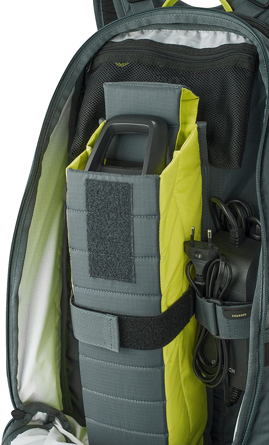

Check out the EVOC ebike specific rucksack
Specially designed to carry a spare battery.
Full name = EVOC Sports Fr Trail E-ride

Deuter e pocket is good if you've already got a decent back pack, then you'll need to buy a 2nd battery. I got mine from the wooly hat shop.
