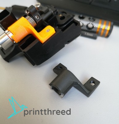

Yeah, that's bollocks. The Shimano quick-release thing is poo and breaks. There's a guy in Germany that has printed a spare part and is happy to send. Otherwise it's a complete new harness from Shimano (because god forbid they'd sell small parts...).
If it's the same as mine then this should get you out of trouble @dochabanero.

Hello @dochabanero , I had the same issue. You still can remove your battery using a small spoon or fork and then try to fix the mechanism.
Maybe it's just the set screw that came loose or the rocker is broken. But you can replace these parts quite easy.
Take a look here, I took a lot of pictures that show you how to get that battery out.

I’ve also bought the yellow 3D printed part to replace that other part of this mechanism that can also break - it’s good quality and cost less tha £20 inc postage form the excellent Martin Ritschel
