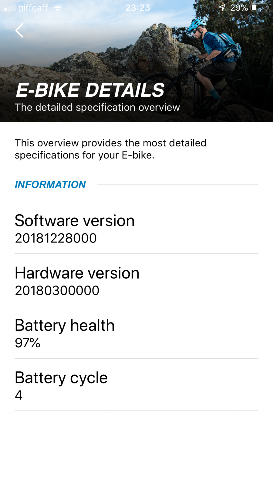

I noticed that keeping my battery topped up after short rides has used up 5 battery cycles. Knowing that after a few hundred cycles the battery and charger become less effective this isn’t a good thing to do.
So now I am running the battery down on my trips during the week and reducing my charge top ups to a minimum. Charging twice a week using two cycles instead of every night I’m out using 5 a week!
What’s your thoughts??

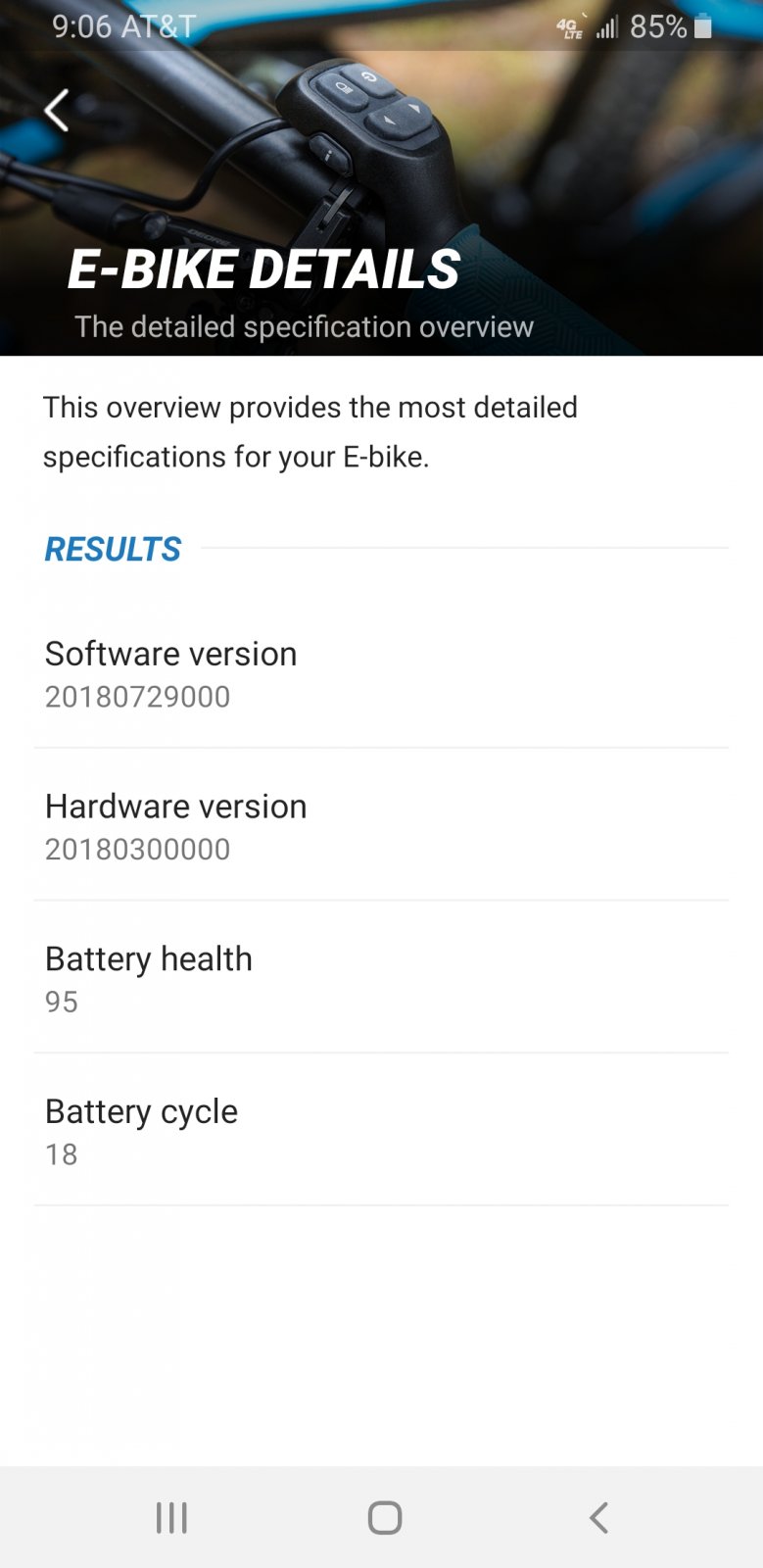

I do the same, and never fast charge. Charge only when its gets to two lights left.
I'm at 18 cycles and battery showing 95% efficiency.

Wow, not sure how to check my battery health (Shimano engine and battery in a Merida) but I would have thought that loosing 5% battery efficiency in only 18 charges is not good. I thought you are suppose to get 500-700 charging cycles out of a battery?
It’s not battery efficiency that’s being lost. Giant count charging cycles and when it reaches so many (think it’s 500) cycles Giant reduce the charging efficiency on purpose to keep the battery more efficient for longer.
So that’s why it’s best only to charge when the battery is low and not keep it topped up. As each little top up uses 1 charging cycle.

Thank you , on my Giant it is true! On the Giant app it shows 5 cycles and I have only ever once got down to two bars and all the other times is from putting the charger in with 4 bars still left most nights. I have only had the bike a couple of weeks.
So..... I will monitor it! And report back !!

I worded my previous message wrong. Its battery health... not efficiency.
See below.
Either way I'm not doing anything weird with it?. Its only dropped below 2 lights on the charge indicater once, and only stayed there for about 20 minutes. I ride every day, so it's never fully charged more than 12 hours, and I only charge once it's at 2 lights left, unless I'm planning a big workout the next day.

Two charges off the bike, and the health has gone up one % to 96. Last two cycles were deep, taking the battery down to one indicator light and then charged off the bike. I'm gonna keep doing this (charge off the bike) and watch. Its mostly just a curiosity to me now. Where its charged either effects Giants health score, or it doesn't. Inquiring minds want to know.
Whether or not Giants health score is meaningful, or accurate, is another question all together.
